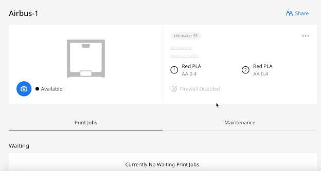

Maintenance schedule in UltiMaker Digital Factory
The printer overview in the UltiMaker Digital Factory also contains the maintenance schedule. This allows you to mark tasks as done once maintenance has been performed, and you will be notified when actions are due.
Sign in to Digital Factory and connect your printer to get access to this feature and improve your maintenance workflow.
