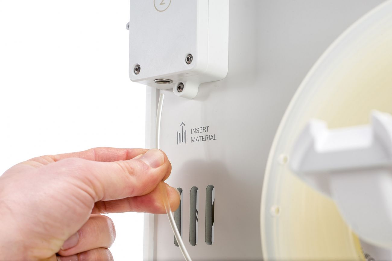

For the UltiMaker S5 or UltiMaker S7 in combination with the Material Station, only start this maintenance action when all materials have retracted to the Material Station. Disconnect the Bowden tube from the bottom of the feeder before starting and reinsert it after reassembling the feeder.

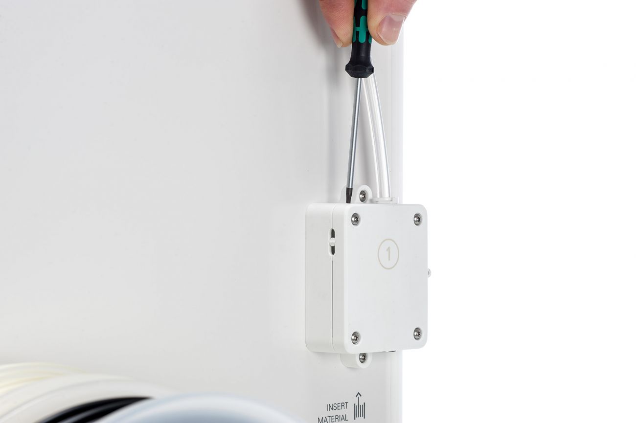

2. Reduce feeder tension
Reduce the tension of the feeder by turning the bolt in the top of the feeder with the hex screwdriver, until the indicator is completely at the top.

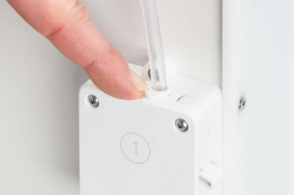

3. Remove Bowden tube and collet
Remove the clamp clip from the feeder-end of the Bowden tube, press down on the tube coupling collet and pull the Bowden tube upwards out of the feeder. Next, remove the tube coupling collet too.

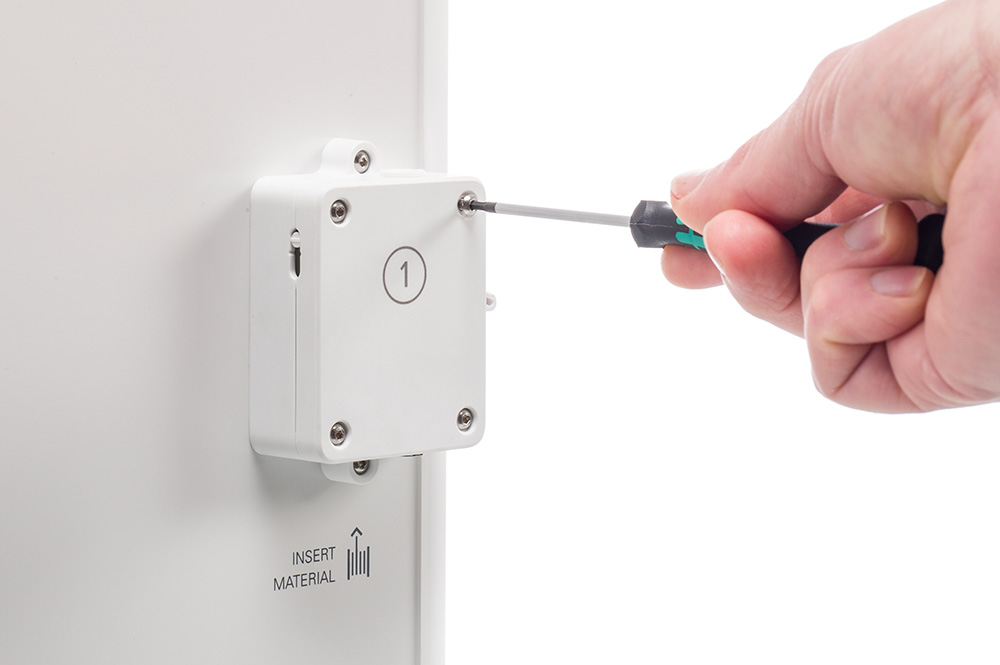

4. Open feeder
Use the hex screwdriver to loosen the four bolts of the feeder housing. Carefully pull the front part of the feeder away from the printer and put it aside.

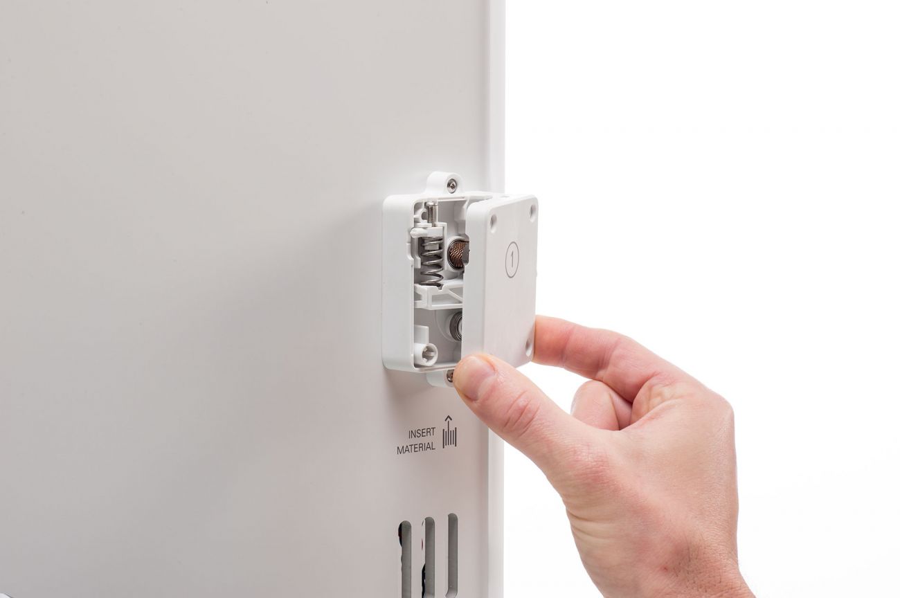

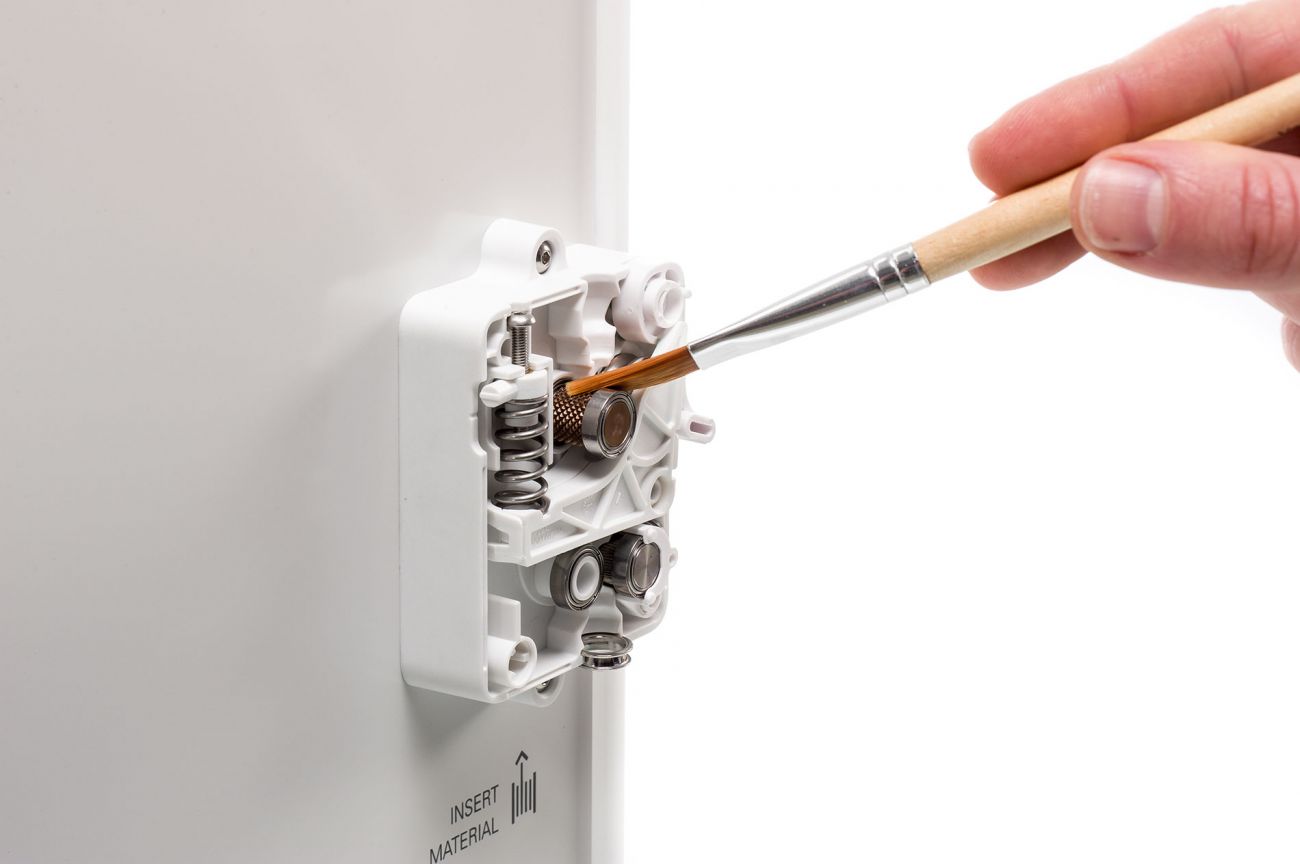

5. Clean the feeder
Use a small brush to gently clean all filament particles from the knurled wheel, the flow sensor axis, and the inside of the feeder housing.
6. Reassemble the feeder
Place the front part over the feeder again and firmly push it into place. Insert the four bolts and tighten them in a cross pattern, starting in the top-left corner.
Tip: While cleaning the feeder, take note of the pattern on the knurled wheel. This may be relevant if the feeder ever needs to be replaced. See this page for more information.
Tip: Ensure that all feeder parts are still in place. If the feeder ring at the bottom came out, place it back with the widest side at the bottom. Ensure that the top of the tension indicator bolt is inside the feeder housing.

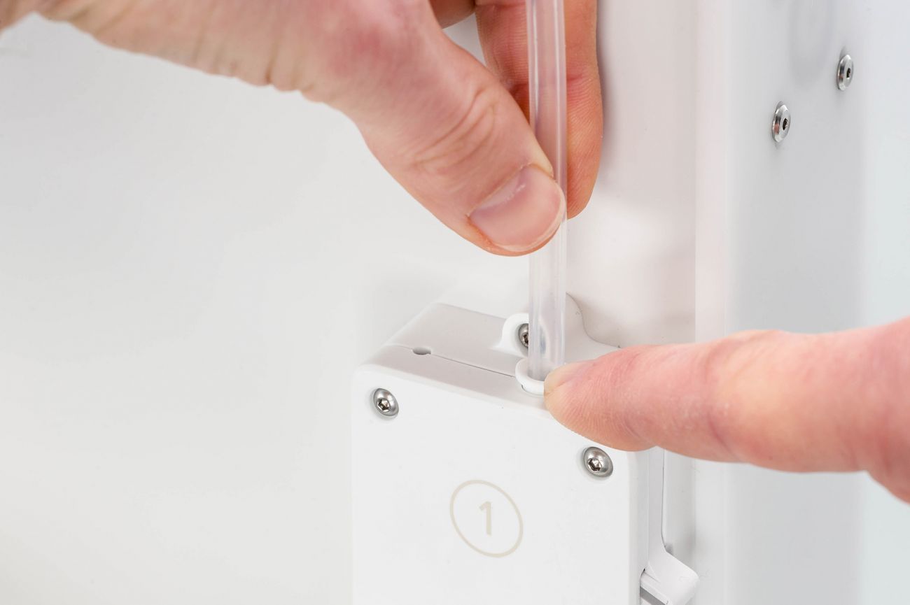

7. Insert collet and Bowden tube
Place the tube coupling collet back into the feeder, then push in the Bowden tube. Secure it with the clamp clip.

For the UltiMaker S5 or UltiMaker S7 in combination with the Material Station, reinsert the Bowden tube into the tube coupling collet at the bottom of the feeder after reassembling.
