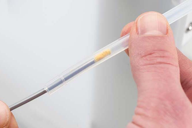

To check the tubes, unload both materials. To inspect them better, you may have to clean the Bowden tubes first. Check if you see any visible scratches on the inside of the tubes.
Additionally, you can remove the Bowden tubes from the print head and feeder side and push a length of filament through manually. If you feel excessive friction or obstructions somewhere along the tube, this is an indication that it should be replaced.

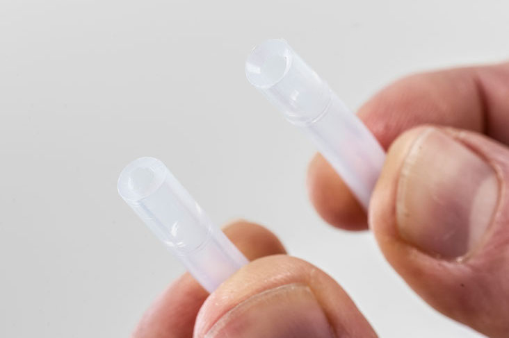

Outside of the Bowden tube
After removing a Bowden tube multiple times, the tube coupling collet can leave scratch marks on the outside of the tube. This can reduce the collet's grip on the outside of the Bowden tube. In this case, the Bowden tube can slightly move up and down during printing and retractions, which negatively impacts the print quality. It may also lead to the Bowden tube coming out of the feeder.

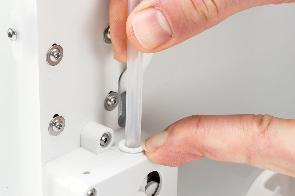

With the Bowden tubes installed and secured with the clamp clip, pull each Bowden tube above the feeder as well as the print head. The tube should remain securely in place. If there is noticeable play (> 0.5 mm), inspect the surface more closely:
Remove the Bowden tubes from the print head and feeder sides. Inspect the surface where the collet grips the tubes. It is normal that there is a small ridge or line visible. However, if the surface looks very rough or worn down, it is recommended to replace the Bowden tube.
Tip: Use the black clamp clip on the feeder for a more secure grip on the Bowden tube. The UltiMaker 3 originally used only white clamp clips, but the Bowden packs now include one white clip (for the print head side) and one slightly thicker black clip (for the feeder side). If you do not have any of the black clips, you can print a replacement yourself: STL file
