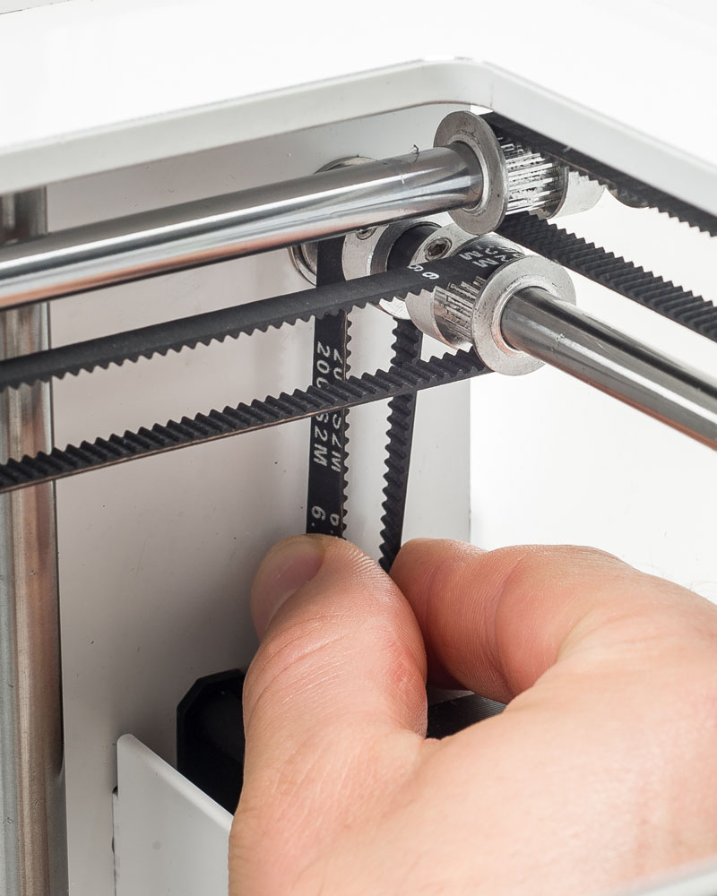

Pluck the two short belts to check their tension. They should resonate, like guitar strings. It should not be possible to press the belt against itself. Furthermore, the tension of the two belts should be equal.
Belt too looseCorrect belt tension

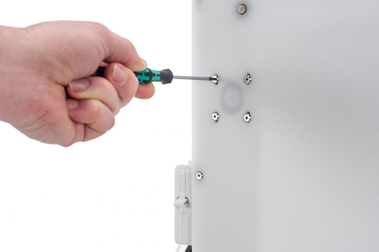

  1. Loosen the Y motor by using the hex screwdriver to loosen the four bolts that hold the Y motor to the left panel. Do not remove the bolts. The motor should be able to slide up and down.

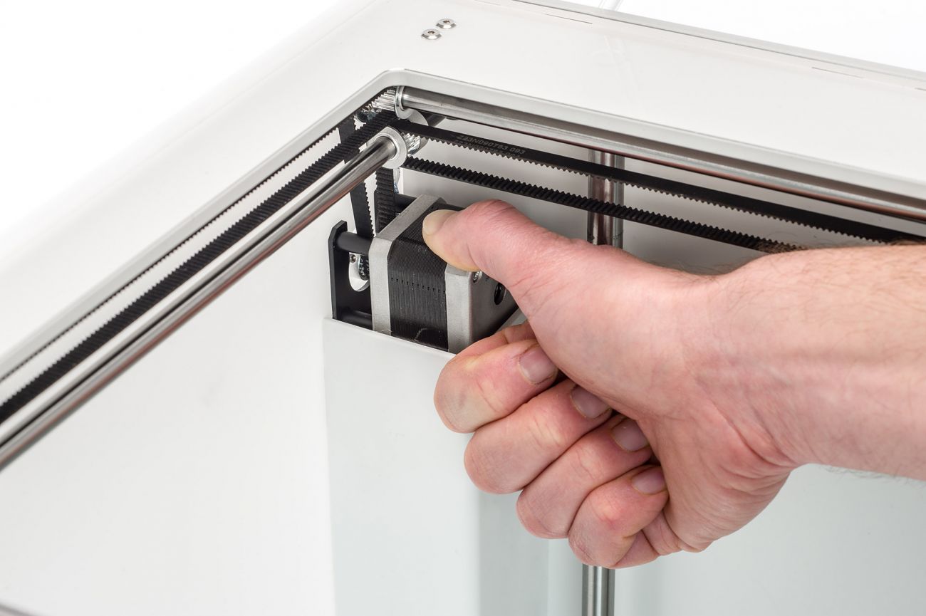

  2. Firmly press down on the motor with one hand. This ensures maximum tension on the short belt.
  3. While still pressing the motor down, tighten the four bolts of the Y motor in a cross pattern. First tighten the top-left bolt, then the bottom-right, followed by the bottom-left and ending with the top-right. This ensures that the motor is attached straight.
  4. Perform the above steps for the X motor that is attached to the back panel. Afterward, check the tension of both belts again.
