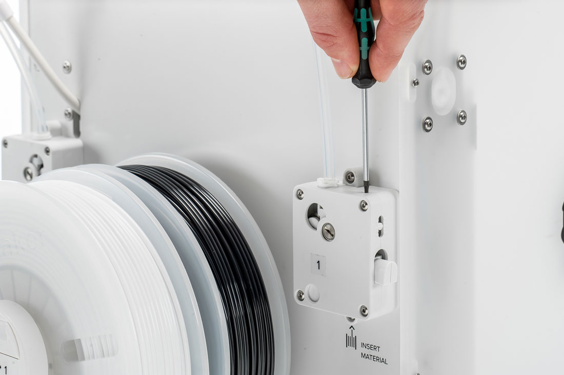

Next, remove the feeders from the printer. Take the following steps for each feeder:
  1. Remove the clamp clip from the top of the feeder housing.

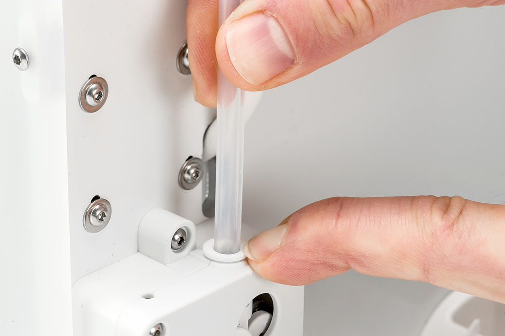

  2. Press down on the white tube coupling collet while pulling the Bowden tube upwards.
  3. Reduce the tension of the feeder by turning the bolt in the top of the feeder, until the indicator is all the way at the top.

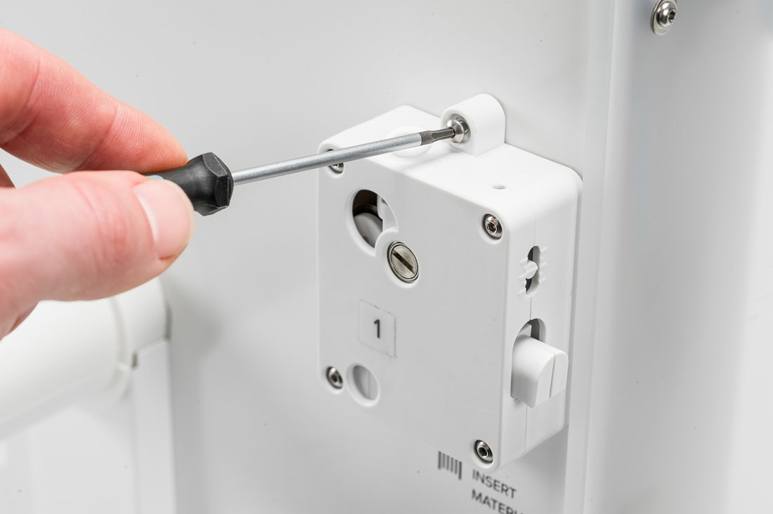

  4. Use the hex screwdriver to remove the two bolts that hold the feeder to the back panel.
Remove the Bowden tubeReduce feeder tensionRemove the feeder

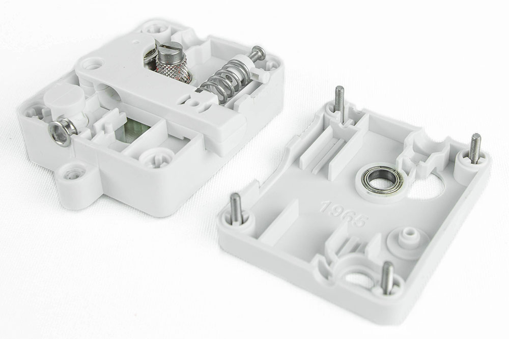

To properly clean the feeder, you must take the two halves of the housing apart:

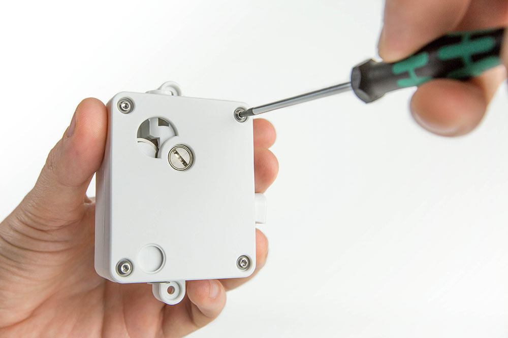

Use the hex screwdriver to remove the four bolts from the front of the feeder housing. Take the two halves of the feeder apart and place them in front of you. Be careful not to lose the bolts; place them somewhere safe or keep them in the front part of the feeder housing. Make sure that the feeder ring, lever, and tension spring remain in the back part of the feeder housing.

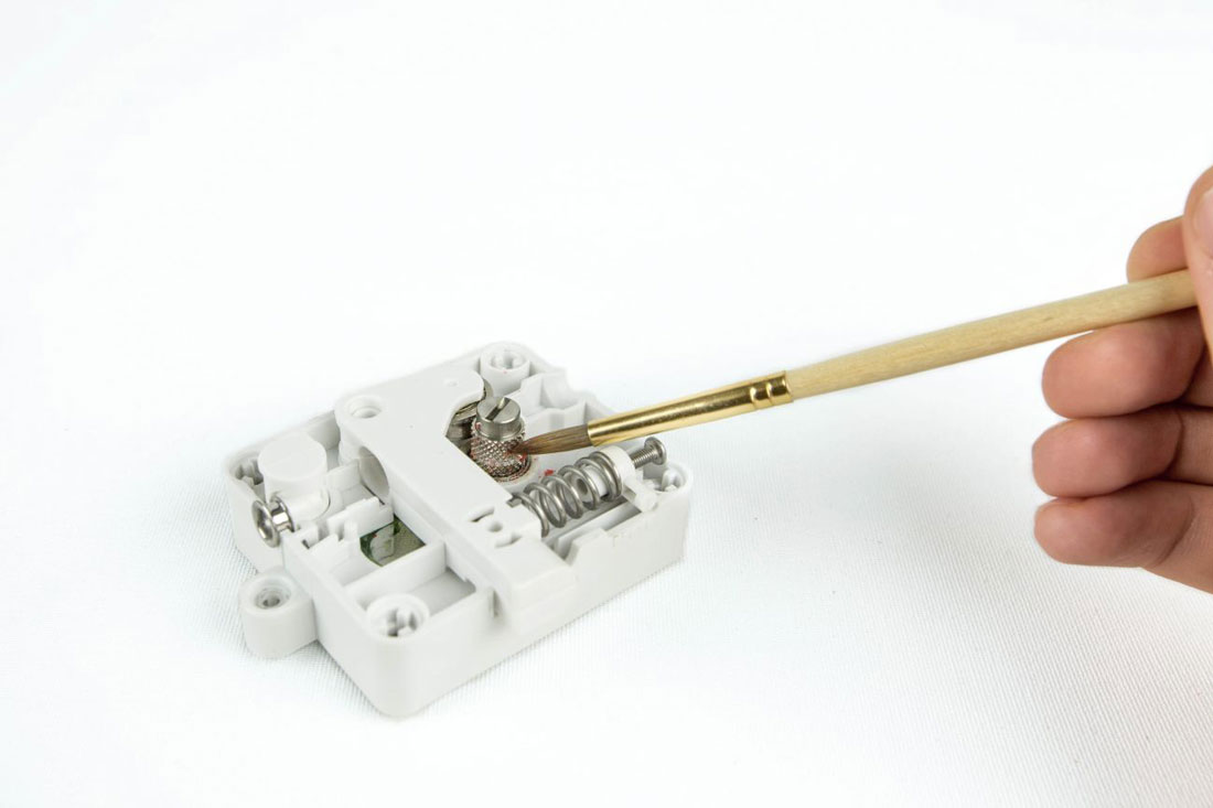

Use a clean cloth, brush, or cotton swab to wipe all filament particles from the feeder parts. Use a small brush to clean the knurled wheel.

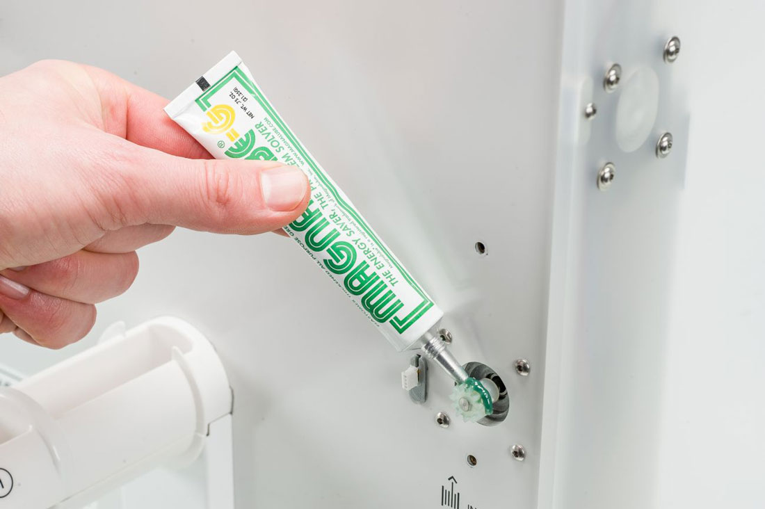

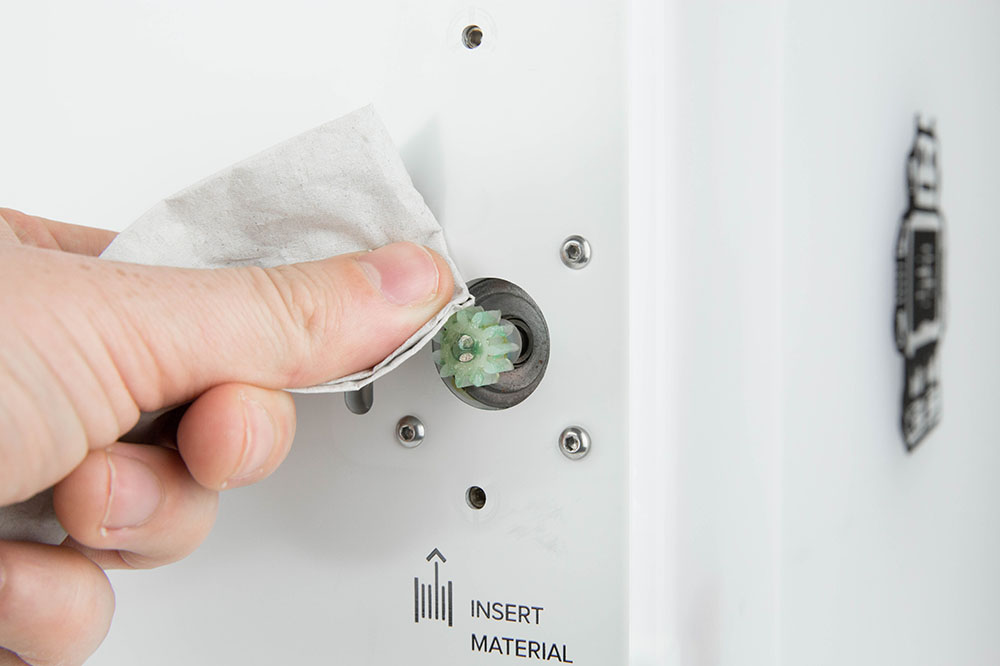

While the feeder is removed from the printer, it is also recommended to clean and relubricate the feeder gear. Use a clean cloth, tissue, or cotton swab to wipe all filament particles and grease residue from the feeder gears. Clean both the gear connected to the motor and the larger gear at the back of the feeder.
After cleaning, apply a small amount of grease to the gear attached to the feeder motor. There is no need to spread this out; the feeder will do this automatically when it turns.
Clean the feeder gearReapply grease

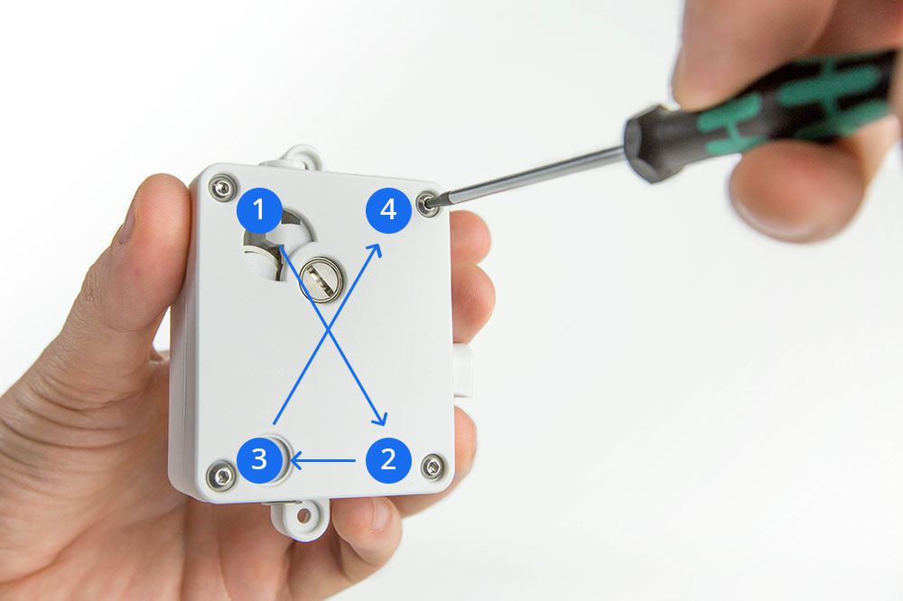

Take the front section of the feeder, place it over the back section, and align the two parts. Ensure that all parts (feeder ring, lever, and tension spring) are still in place. Snap the two halves together and secure them with the four bolts. It is recommended to tighten the bolts in a cross pattern, starting in the top-left corner.
Place the feeder back on the back panel and secure it with the two bolts. Insert the Bowden tube into the printer and secure it with the clamp clip. Lastly, reset the feeder tension by turning the bolt in the top of the feeder until the indicator is at the middle mark.
