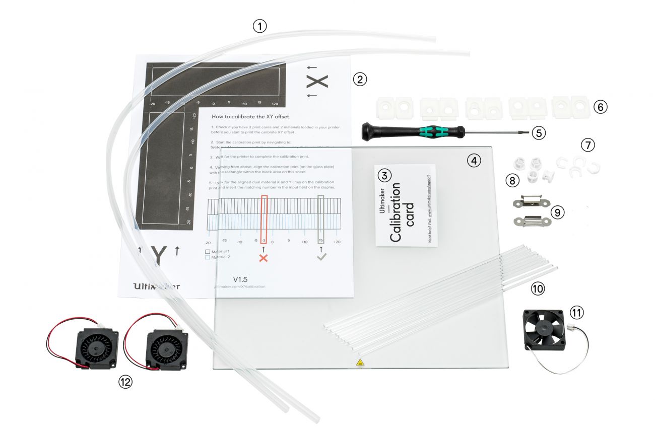

The Ultimaker 3 Maintenance kit contains the most commonly used parts for maintenance or replacement on the Ultimaker 3 or Ultimaker 3 Extended. This kit optimizes your maintenance workflow and prepares you to quickly resolve most issues with your printer.
What’s included?
Below you can find an overview of all the parts that are included in the maintenance kit.
  1. 2x Bowden tube
  2. 1x XY calibration sheet
  3. 1x Calibration card
  4. 1x Glass plate
  1. 1x Hex screwdriver 2.0
  2. 5x Nozzle cover
  3. 4x Clamp clip
  4. 4x Tube coupling collet
  1. 2x Build plate clamp
  2. 1x Cleaning filament
  3. 1x Axial fan (front fan)
  4. 2x Radial fan (side fan)
Tip: Click the links above to find the instructions for how to replace or use the items in the kit. The hex screwdriver has no link; this is used for most maintenance procedures and repairs.
