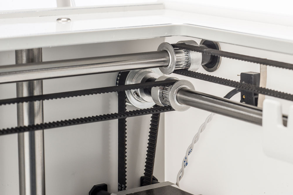

The four X and Y axles are locked in place by the pulleys. However, it is possible that one or more of the pulleys can become slightly loose over time, which could affect their alignment. If this is the case, there could be play on the X and/or Y axles which can cause issues with print quality.

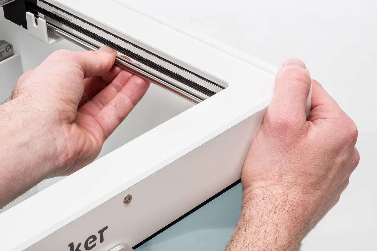

Open the printer's glass door(s) and start with the right Y axle. Place the print head in the back-left corner of the printer to keep it out of the way. Hold the frame of the UltiMaker S series printer with one hand, and firmly hold the right Y axle with the other. Attempt to move the axle forward and backward; do not be afraid to apply some force.
Repeat this for the other axles. Make sure to move the print head to the opposite side each time.
The axles should not move at all. If one of the axles does move, you will notice a ticking noise caused by the pulleys hitting the frame. In this case, adjust the pulley positions.

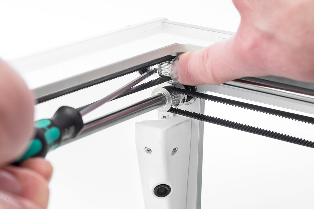

  2. Loosen the pulleys on that axle. Note that the set screws of the pulleys are not always easily reachable. Adjust the position of the print head until you can reach the set screws. Loosen them, but do not remove them from the pulleys completely.
  3. Correctly position the axle:
    The X axles should be positioned in the middle.
    The Y axles should be pushed toward the front of the printer.
  4. While ensuring that the axle stays in place, firmly push the pulleys toward the frame.
  5. Tighten the set screws. Make sure the pulleys are tightened securely. If they are too loose, this can lead to print quality issues such as layer shifting.
