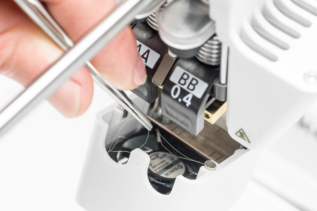

To check the front fan, first open the front fan bracket. Blow into the front fan to see if it spins smoothly. If it does not move at all or stops spinning abruptly, you will likely see strands of filament stuck in the fan. Use tweezers to carefully clear any obstructions from the front fan from the inside.
Tip: This is possible with the print cores in place, but you can also remove the print cores first for easier access.
Next, close the fan bracket and check the fan from the outside. Remove any strands from that side too.
