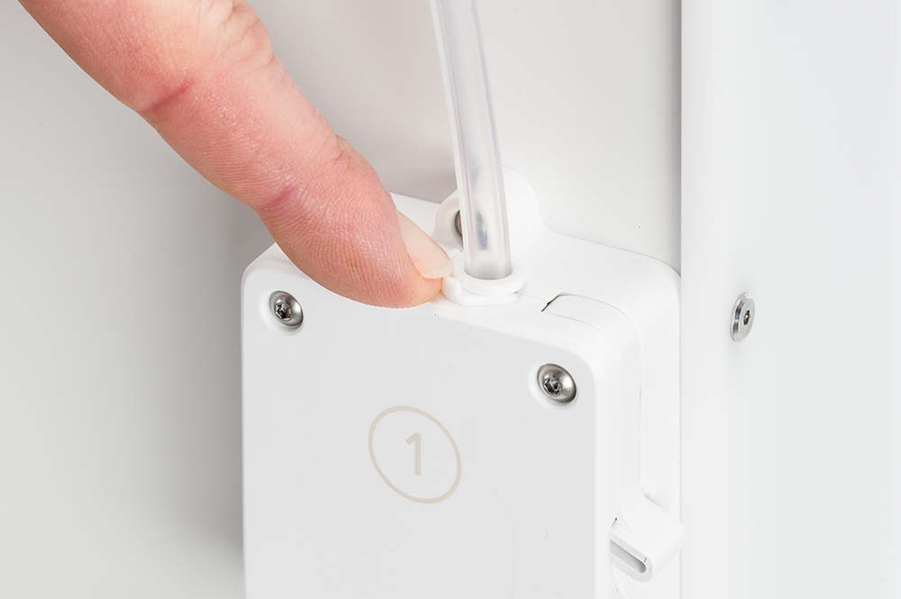

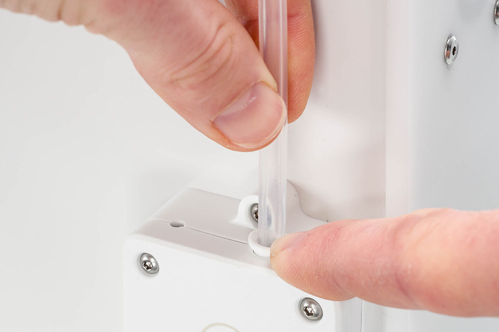

Remove the Bowden tubeRemove the Bowden tube from the top of the feeder. First remove the clamp clip, then press down on the tube coupling collet while pulling out the Bowden tube.

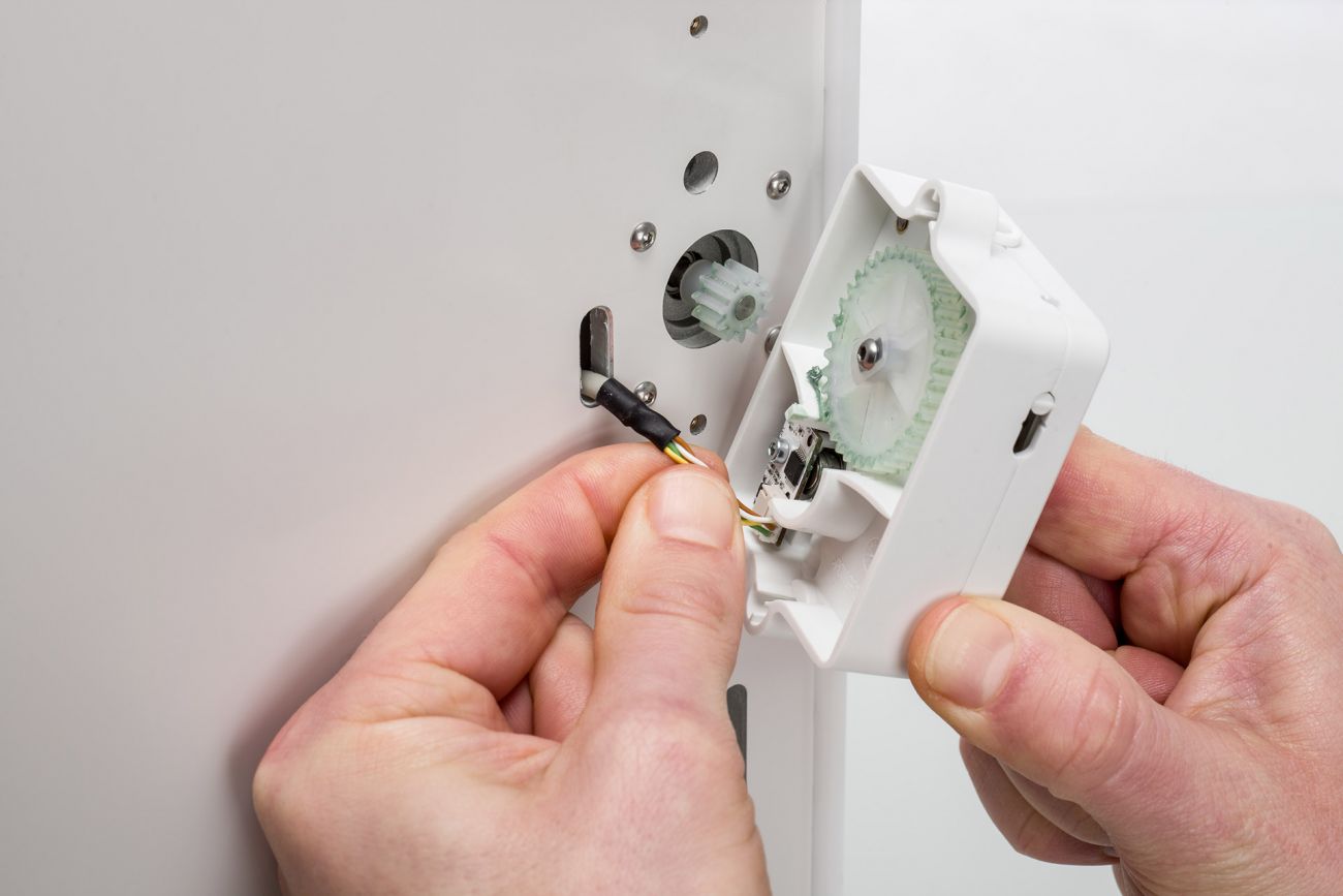

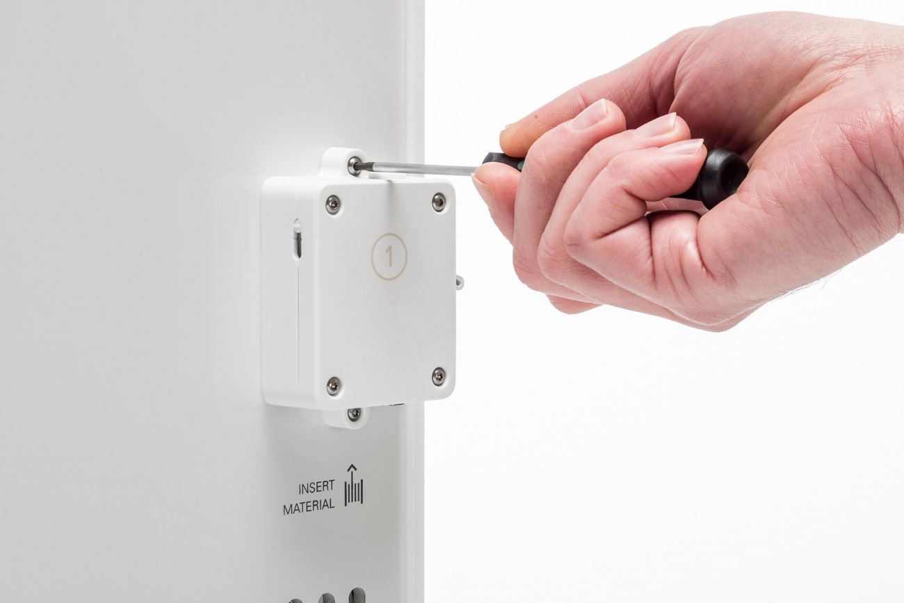

Remove the feederUse the hex screwdriver to loosen the two bolts that hold the feeder to the back panel. Carefully move the feeder away from the back panel and disconnect the filament detection cable from the flow sensor.

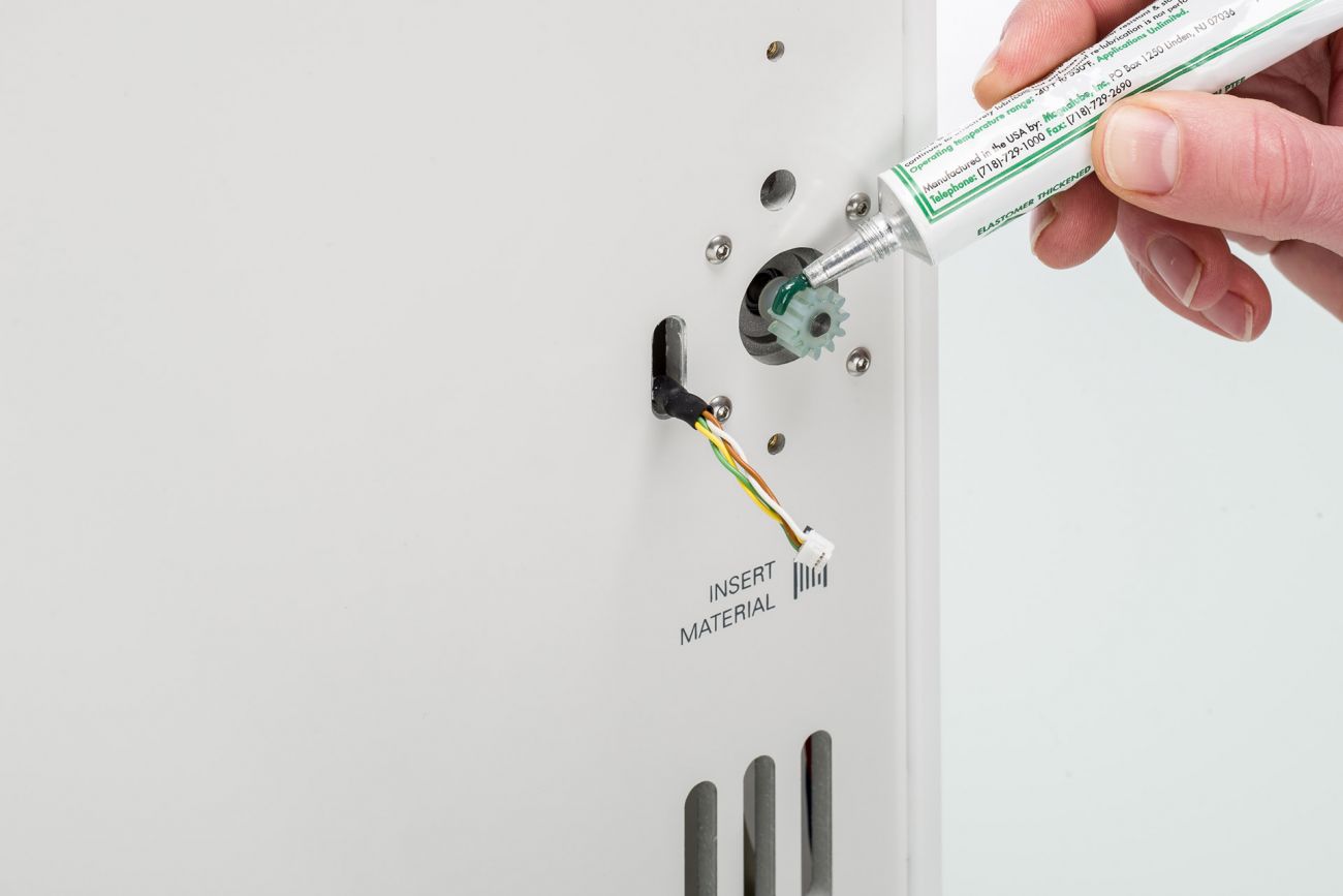

Small filament particles may have accumulated on the gears. Use a clean cloth, tissue, or cotton swab to wipe all filament particles and grease residue from the feeder gears. Clean both the gear connected to the motor and the larger gear at the back of the feeder.
After cleaning, apply a small amount of grease to the gear attached to the feeder motor. There is no need to spread this out; the feeder will do this automatically when it turns.

  1. Hold the feeder close to the back panel and connect the filament detection cable to the flow sensor.
  2. Place the feeder back on the printer and secure it with the two bolts.
  3. Push the Bowden tube all the way into the tube coupling collet at the top of the feeder.
  4. Secure the tube with the clamp clip.
