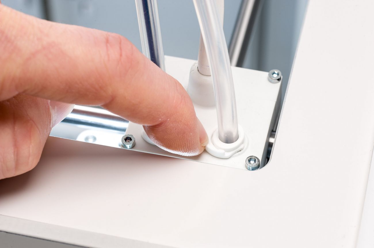

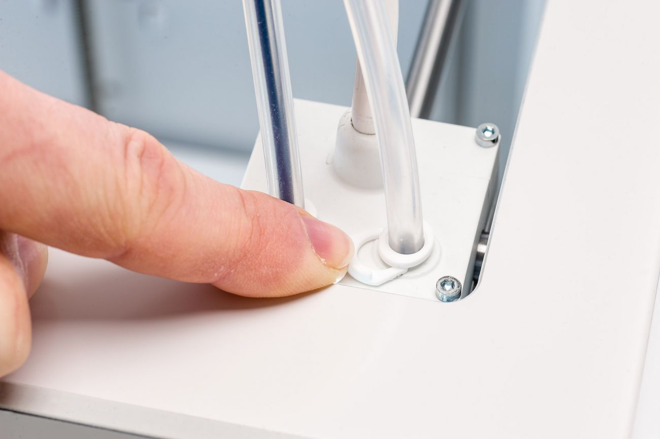

  3. Push down on the white collet press cover and pull the Bowden tube (for extruder 1 or 2) out of the print head.

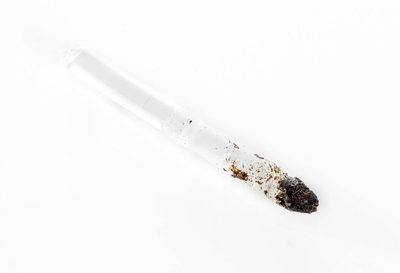

  4. Inspect the filament tip. If there is dirt or carbonized filament on the tip, cut it off and redo the hot pull.
  5. Repeat these steps until the filament tip comes out clean.

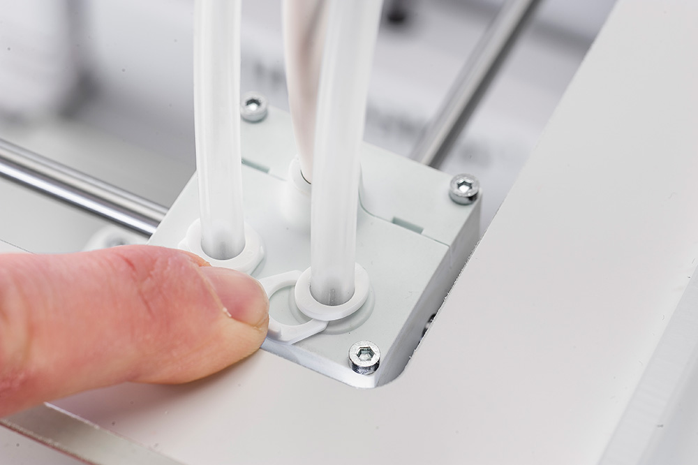

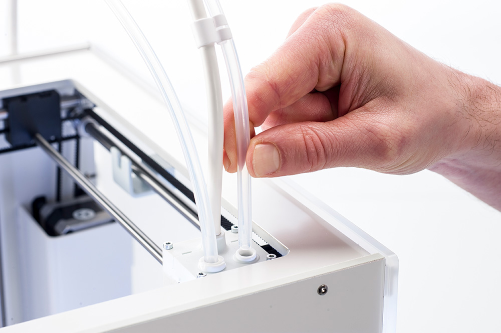

  2. Remove the Bowden tube from the print head. First, remove the clamp clip and then push down on the tube coupling collet while pulling the Bowden tube upwards, out of the print head. Confirm to continue.
Note: The print head will move to the front-right corner to prepare itself.

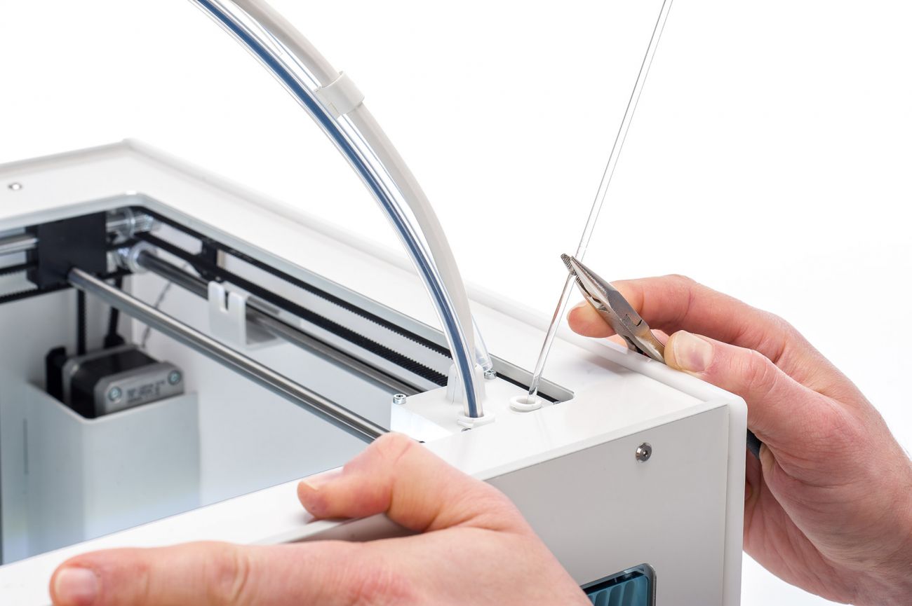

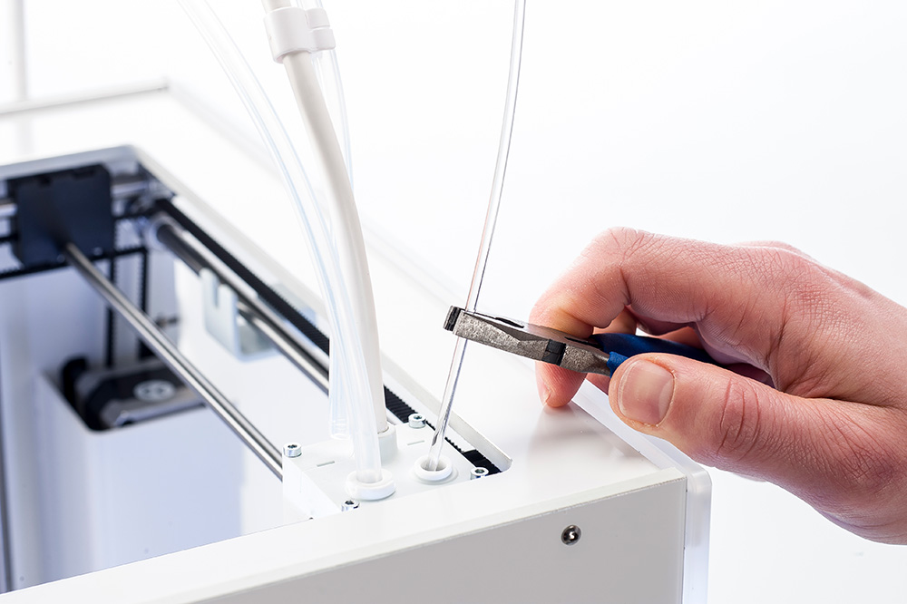

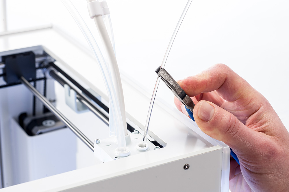

  1. Insert the filament into the print head until you feel some resistance.
  2. Hold the filament with pliers and gently apply pressure to the material for ±1 second so that it extrudes from the print core or until it cannot be pushed any further, and directly pull the filament out with a quick, firm pull.

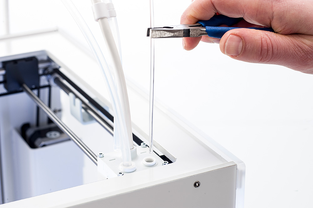

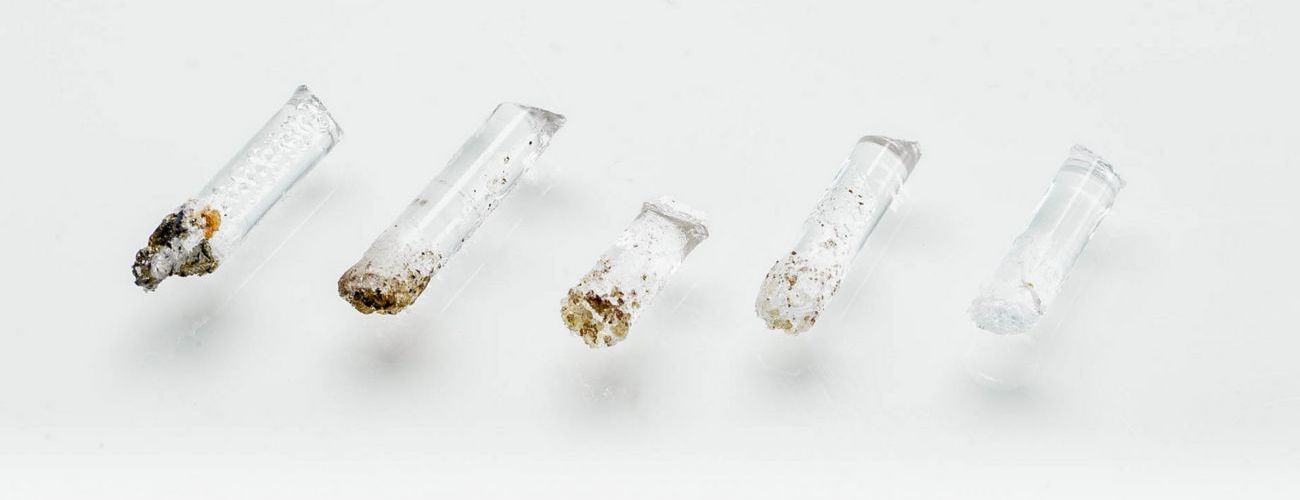

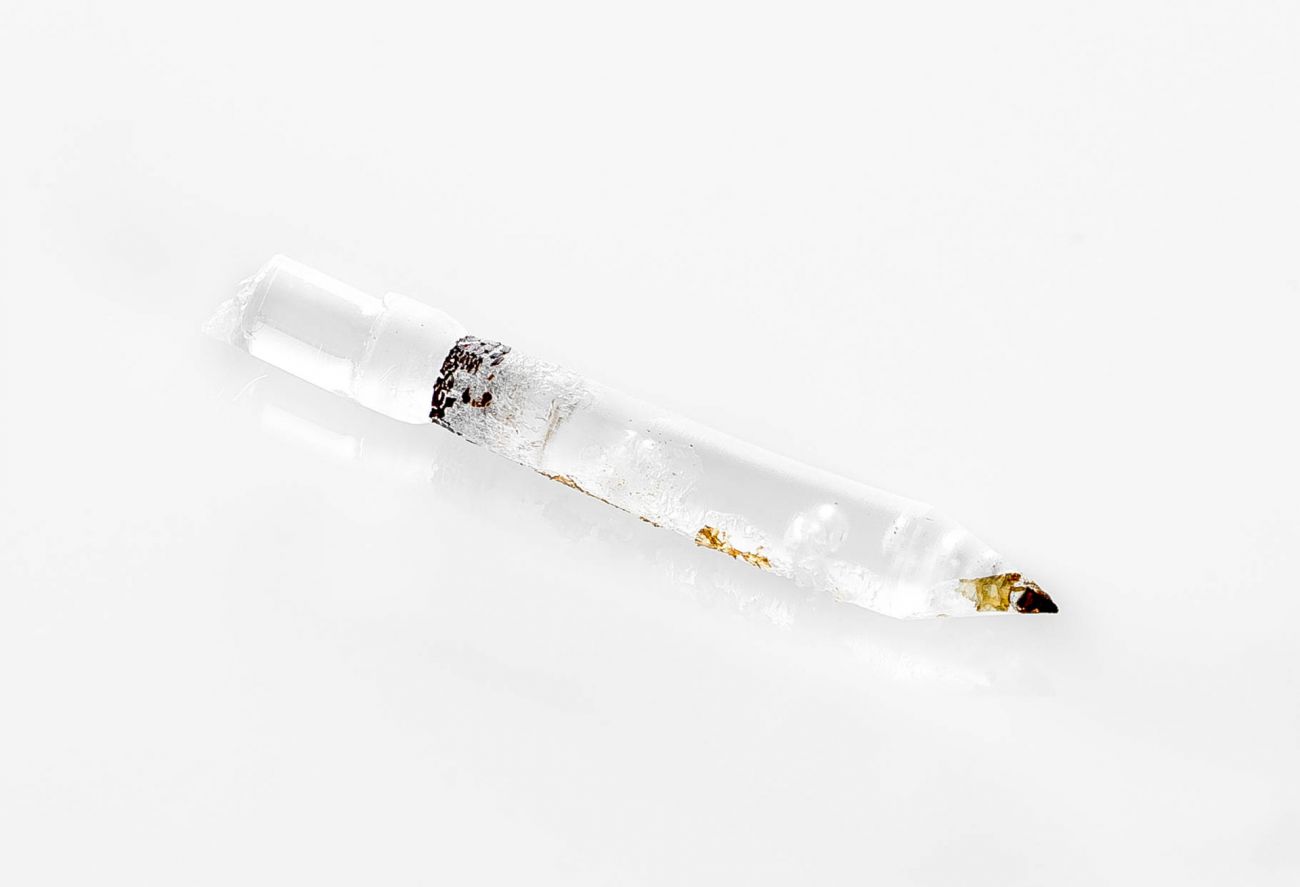

  1. Cut off the tip of the filament that you have just pulled out.

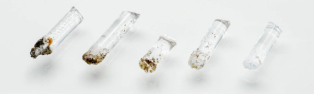

  2. Check the color and shape of the tip of the filament and compare it with the image below. The goal is to have a clean tip.
  3. Repeat this procedure until there is no more degraded material visible on the tip of the cleaning filament. The tip of the filament should look as clean as on the right in the example below.

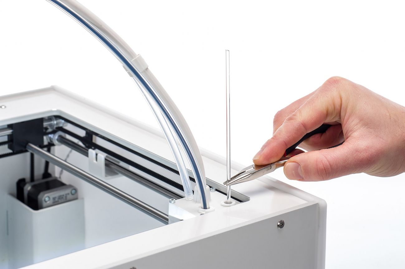

  2. Hold the filament with pliers and gently apply pressure to extrude some material. Press Confirm to continue.
  3. Maintain pressure on the filament with the pliers for the duration of the progress bar.
  4. Release the filament and wait until the print core has cooled down.

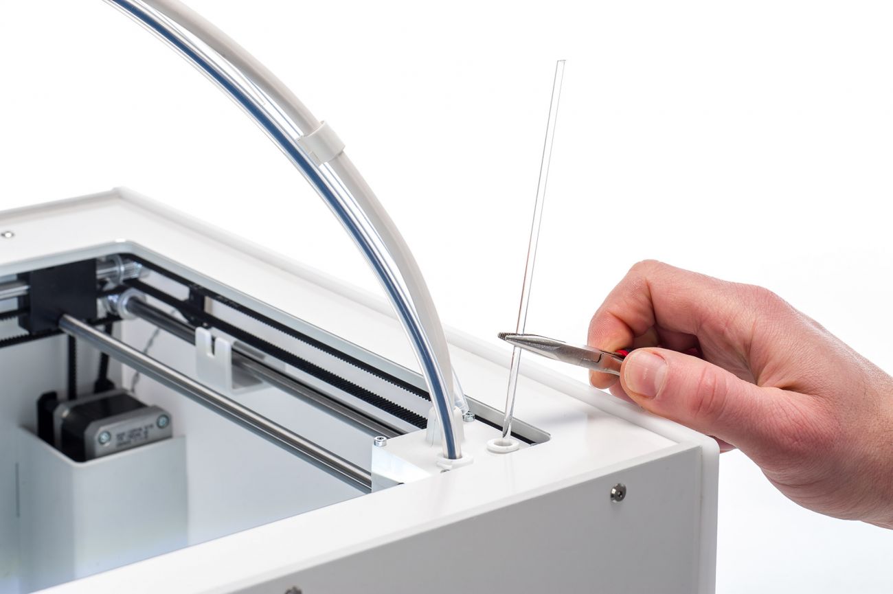

  5. Grab the filament with pliers and pull it out with a quick, firm pull. Press Confirm to continue.

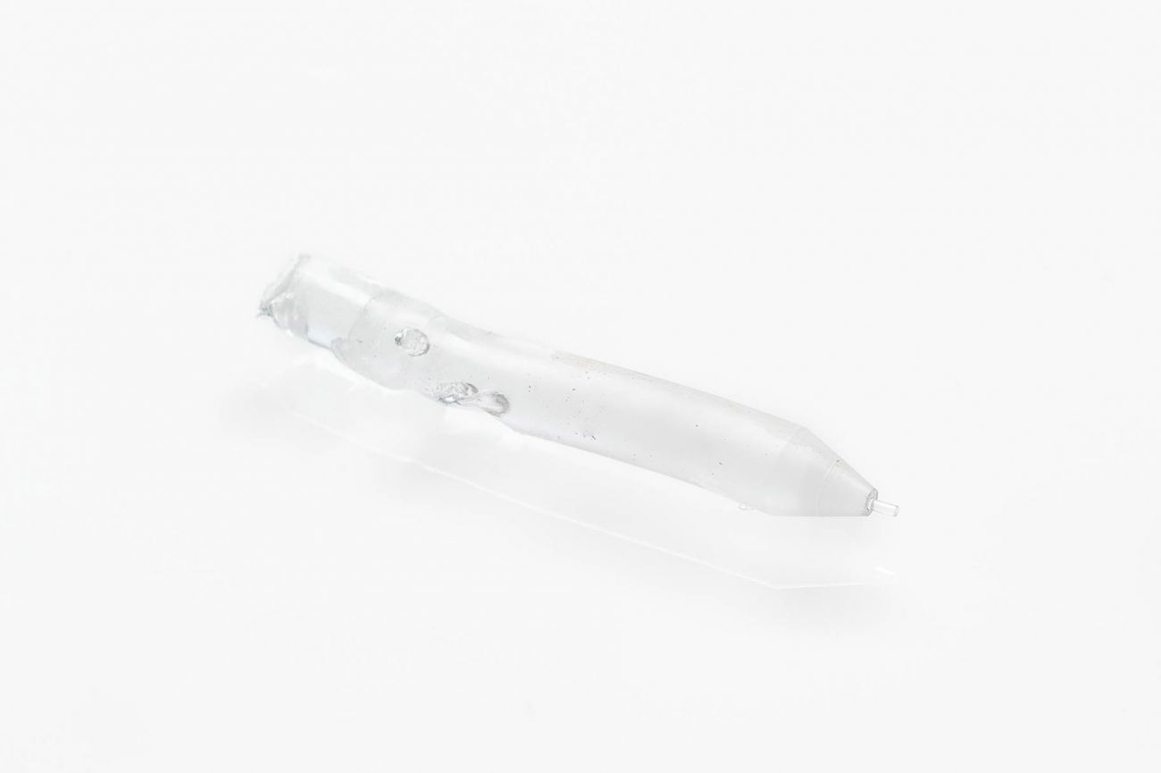

Inspect the tip of the filament and see if it has a clean, cone-shaped tip like the example to the right. If so, Confirm to continue. If there is still too much degraded material visible in the material tip, repeat the hot or cold pull.
Clean_print_core_dirty_filament_tip.jpgClean_print_core_quite_dirty_filament_tip.jpgClean_print_core_clean_filament_tip.jpg
Too much carbonized material, repeat the hot pull.Almost clean, perform one more cold pull.The tip of the filament is completely clean, proceed to reassembly

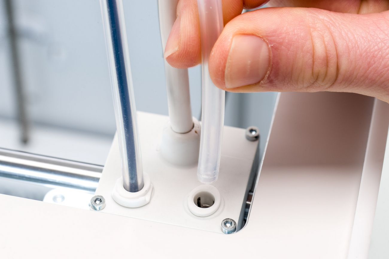

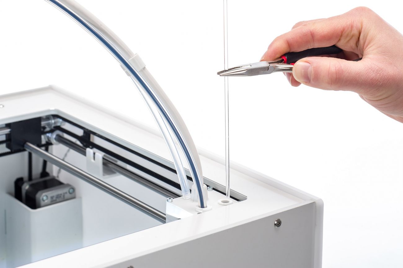

When the inside of the nozzle has been cleaned successfully, reinsert the Bowden tube so you can continue printing.
  1. Insert the Bowden tube into the print head.
  2. Secure the tube in place with the clamp clip. Confirm to continue.
  3. Wait for the printer to finalize the cleaning procedure.
