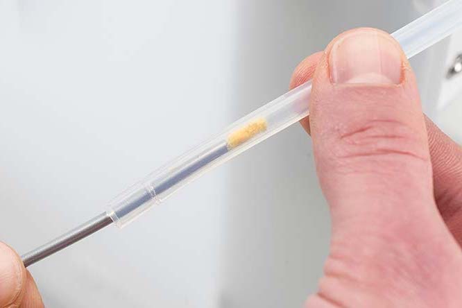

Inside of the Bowden tube
Forwarding improperly cut or ground down filament through the Bowden tube could scratch or damage the inside of the tube. If this happens, the filament can no longer be forwarded to the print head smoothly. This can lead to under-extrusion or other print quality issues.
To check the tubes, unload both materials. To be able to inspect them better, you may have to clean the Bowden tube first. Check if you see any visible scratches on the inside of the tubes.
Material-Station-icon.pngOn the UltiMaker S5 or S7 in combination with a Material Station, wait to perform this check when all materials have fully unloaded back into the Material Station. Active or parked materials cannot be manually unloaded.
Additionally, you can remove the Bowden tubes from the print head and feeder side and push a length of filament through manually. If you feel excessive friction or obstructions somewhere along the tube, this is an indication that it should be replaced.
