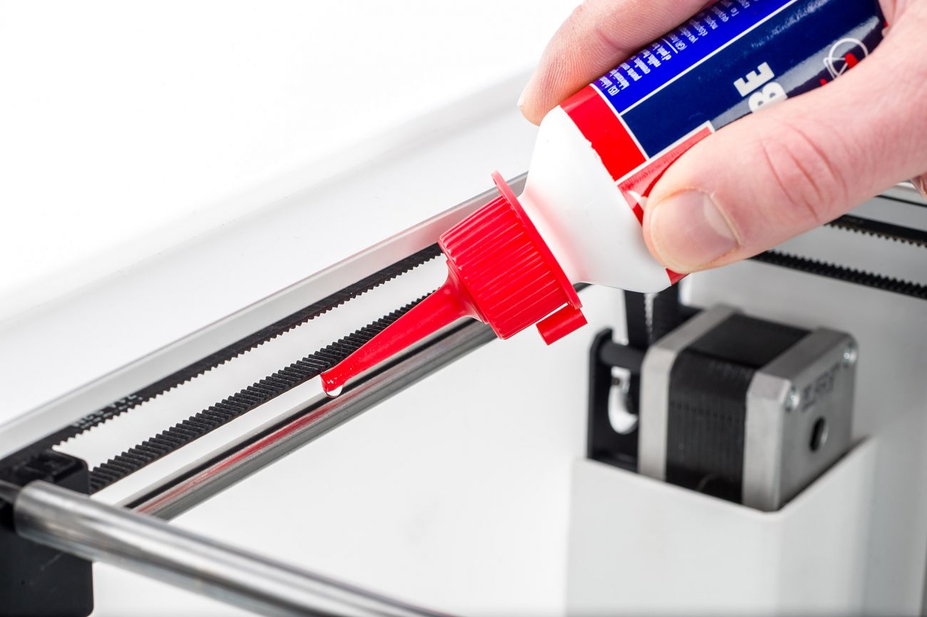

X and Y axles
First, check if the axles are clean. If necessary, use a paper towel or microfiber cloth to wipe any dust or dirt from the axles. Then, apply a small drop of oil to each of the X and Y axles as well as both print head shafts. Manually move the print head around to evenly distribute the oil.
Make sure you clean and lubricate all of the axles, for consistency and to prevent uneven wear:
  • There are three X shafts, going left to right: Front of the frame, back of the frame, and the 10 mm shaft going through the print head
  • There are three Y shafts, going front to back: Right of the frame, left of the frame, and the 8 mm shaft going through the print head
Note: Do not apply too much oil to the axles, as it might drip from the axles onto the build plate, which will affect print adhesion. If a drop of oil falls on the build plate, clean it thoroughly before printing.

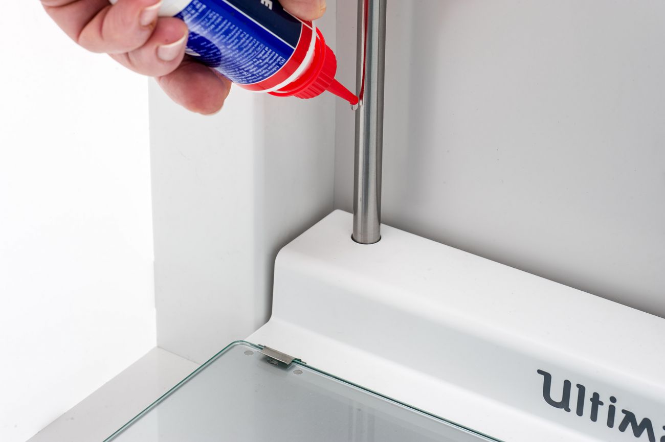

Z axles
Apply a small drop of oil to each of the Z axles. Open the Preferences menu (gear icon) on the UltiMaker display, and go to Maintenance → Build plate → Move build plate. Select Raise and then Lower to move the build plate up and down in order to evenly distribute the oil.
Note: Do not apply the oil to the Z motor's lead screw. This must be lubricated with the supplied grease once every three months.
Lubricating the X and Y axlesLubricating the Z axles
Note: Never use the grease (Magnalube or Eurol) on the smooth axles of your printer. If you have done so accidentally, make sure to thoroughly clean the shafts before applying the oil for relubrication.
