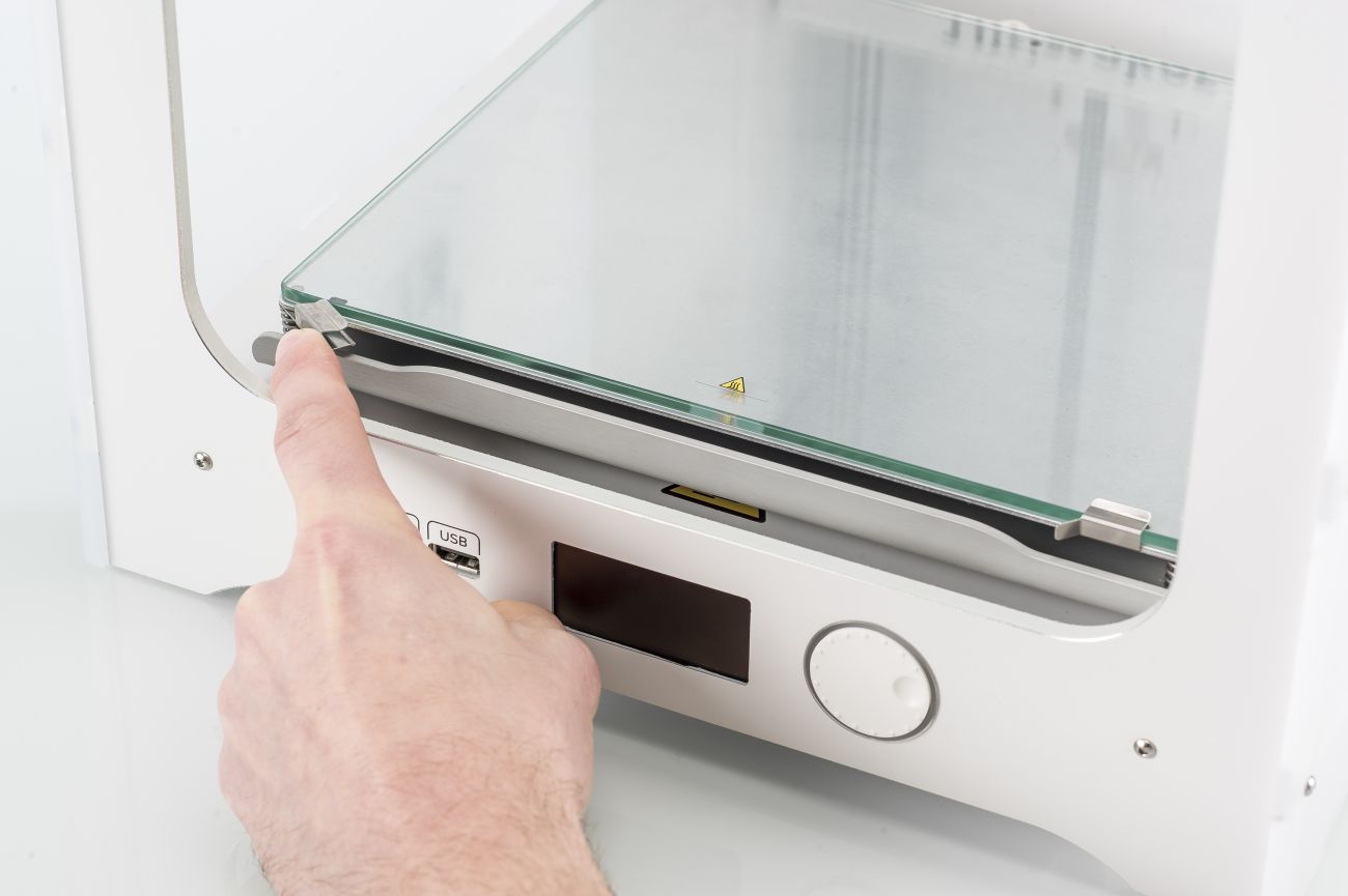

1. Remove the glass plate
Ensure that the build plate is at the bottom of the printer. Open the two build plate clamps at the front and slide out the glass plate.

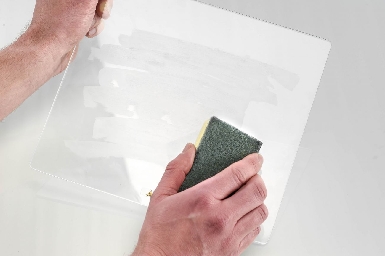

2. Clean with waterUse lukewarm water and a non-abrasive sponge to clean the build plate and to remove any adhesives. If necessary, some detergent can be used to remove adhesives, or alcohol gel can be used to get rid of any fatty substances
3. Dry the plateLeave the plate to air dry, or wipe it down with a microfiber cloth. Ensure that the plate is fully dry before reinstalling it in the printer.

5. Reinstall the glass plate
Slide the glass plate back into the printer until it snaps into the build plate clamps at the back. Close the front two build plate clamps to secure the glass build plate.
Caution: Leaving the build plate clamps open may damage your UltiMaker 3 when the build plate is raised.

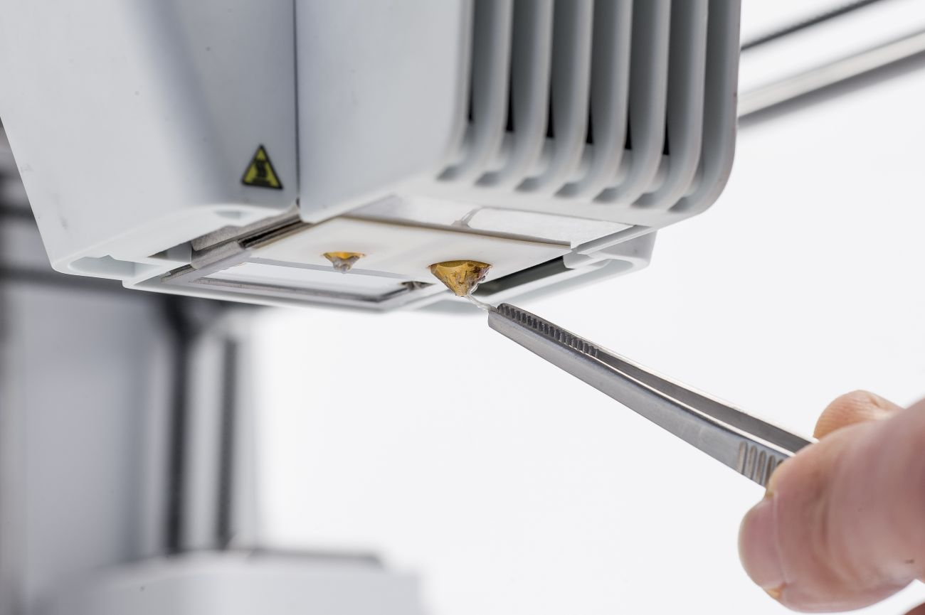

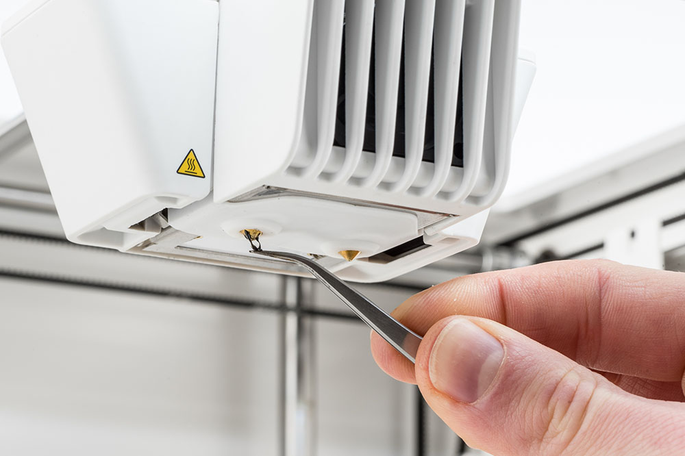

Nozzles
During printing, material can get stuck to the outside of the nozzles and degrade. Although this will not usually damage your printer, it is recommended to keep the nozzles of the print cores clean in order to achieve the best print results.
Before starting a new print, always check the nozzles. At least once a month, remove the plastic from the outside of the nozzle by taking the following steps:
Caution: This procedure requires heating up the print cores. Be careful and do not touch the nozzle with bare hands. Protective (thermal) gloves are advised. If the UltiMaker 3 is connected to the Digital Factory, ensure that new print jobs cannot start unexpectedly.
  1. In the UltiMaker 3 menu, navigate to Maintenance – PrintCore1 – Set temperature.
  2. Do the same for print core 2 and ensure this print core is lowered.
  3. Rotate the button to set the target temperature to 150 °C.
  4. Wait for the material on the outside of the nozzle to soften. When the nozzles are hot, carefully remove the material with tweezers.
  5. Lower the print core temperatures to 0 °C and wait for the nozzles to cool down.

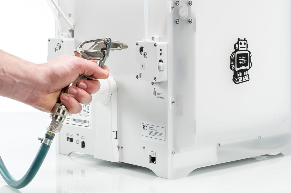

After a lot of printing, the knurled wheel in the material feeder can accumulate small filament particles. These can end up in the Bowden tubes or print cores, which can impact print quality. You can clean the feeders quickly once a month, following the instructions below, and more thoroughly only once a year or after experiencing grinding issues.
1. Unload materialFirst, remove the filaments from the printer. Via the Material/PrintCore menu, unload both spools. Take the filament out of the feeders. You can remove the spool from the printer, or just push the end of the filament through one of the holes in the spool to prevent the material from getting tangled.
2. Clean the feedersTo clean the inside of the feeder, you can blow into the hole in the front of the feeder housing. If necessary, you can use compressed air. This will remove the majority of filament particles.

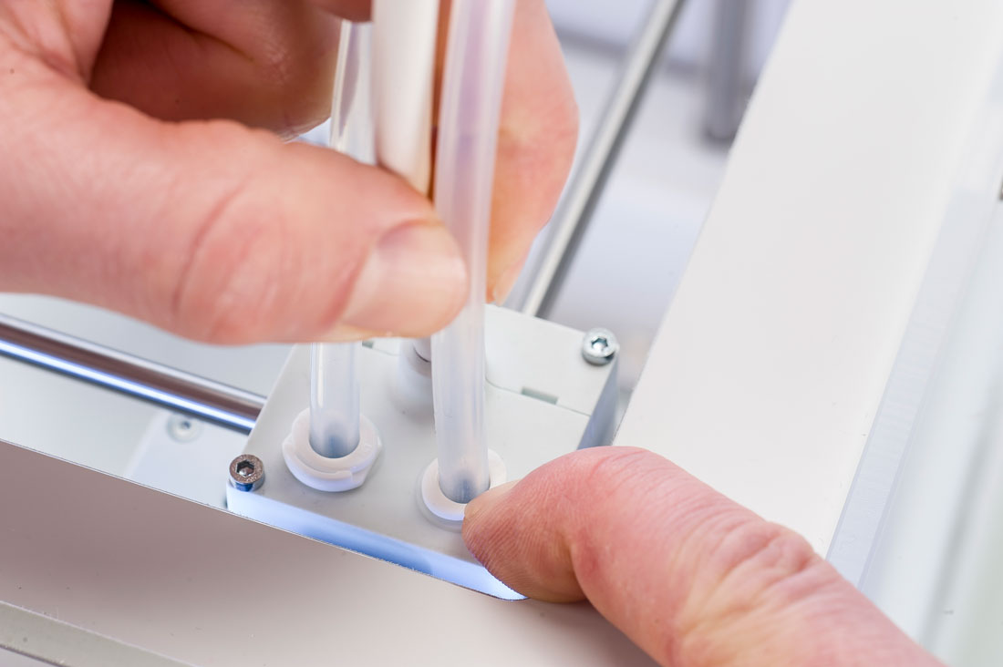

2. Remove the Bowden tube

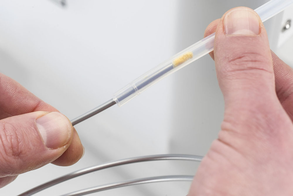

Remove the clamp clips from the tube coupling collets at the print head and feeders and pull out the Bowden tube from both ends. The cable clips that hold the right Bowden tube to the print head cable do not have to be removed, you can leave them in place.
3. Clean the tubePush a small piece of sponge or tissue through the tube with a length of filament until it comes out of the other side. Ensure that any debris from the tube does not fall inside the printer.
4. Reinstall the Bowden tubePush the ends of the Bowden tube back into the print head and feeders. Ensure the tubes are fully inserted and secure them with the clamp clips.
When the tubes are cleaned and reinstalled, you can load the materials again.

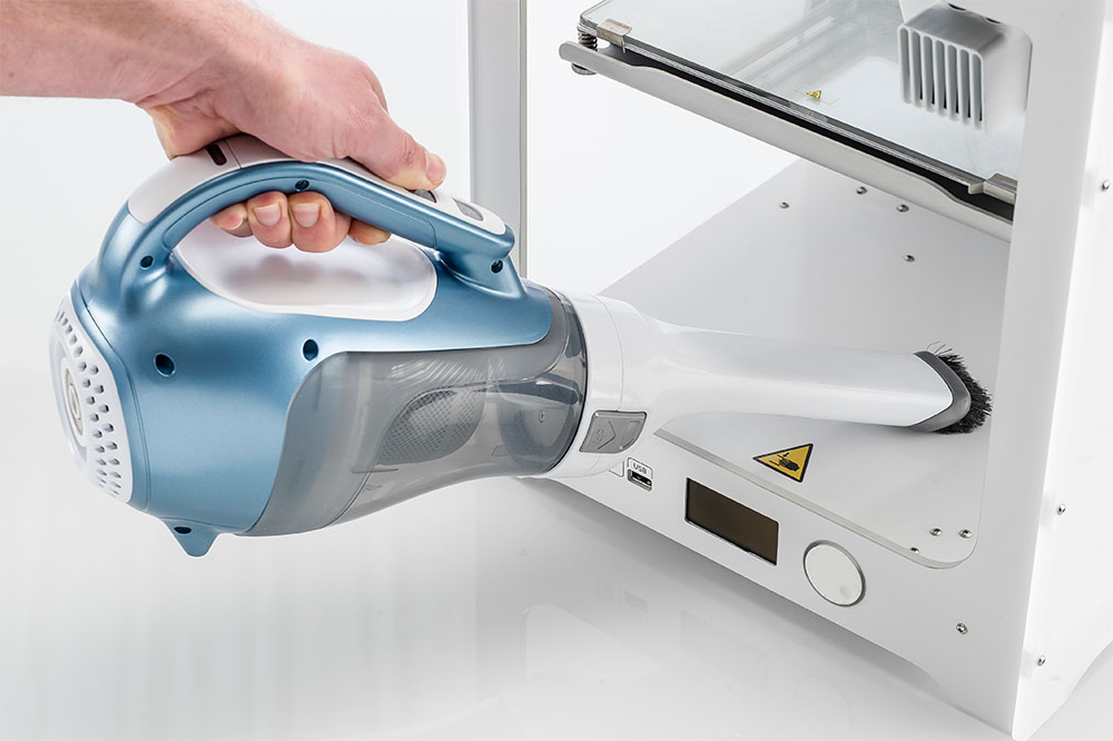

Inside of the printer
Small pieces of material can gather inside the printer. Leaving larger objects on the bottom panel can lead to errors, as they prevent the build plate from homing properly. Remove small particles regularly from the inside of the printer by taking the following steps:
1. Raise build plateYou can lift up the build plate manually, or do so using the Move build plate option in the Maintenance menu.
2. Clean the bottom panel
Clean the inside of the printer with a microfiber cloth or (handheld) vacuum cleaner. Remove all dust and pieces of filament. Pay extra attention to the area around the Z limit switch as obstructions here can cause print problems.
3. Lower build plate
Lower the build plate again (manually or via the menu).
Caution: Before lowering the build plate, make sure the printer is clear from objects and hands to prevent them from getting stuck under the build plate.
