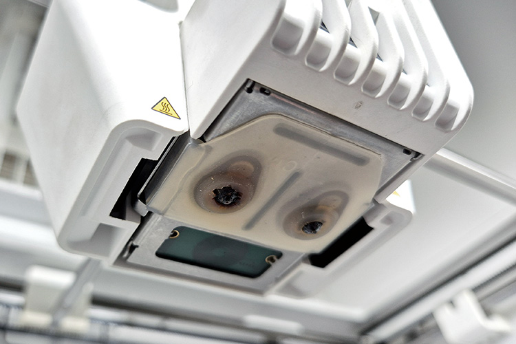

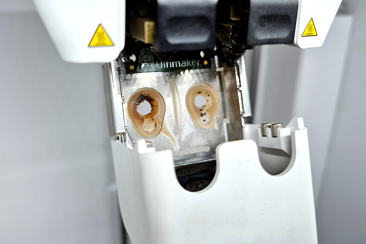

Examine the bottom of the print head to see if the holes where the nozzles come through are still round and if the cover still forms a good seal. Also gently open the fan bracket to check the other side of the silicone nozzle cover.
If the nozzle cover looks burnt, frayed, or damaged, it is recommended to replace it. Follow the instructions below.
Note: Never start a print if the nozzle cover is not installed. This can cause errors such as ER31 or it can lead to backflow of material into the print head (Flooded print head).
