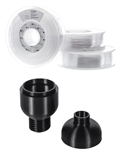

UltiMaker CPE+ (co-polyester) is similar to UltiMaker CPE, but tougher and with higher temperature resistance. While UltiMaker CPE can withstand temperatures of up to 70 °C, UltiMaker CPE+ can withstand temperatures of up to 100 °C. These tips will help you get started and achieve good results with UltiMaker CPE+.

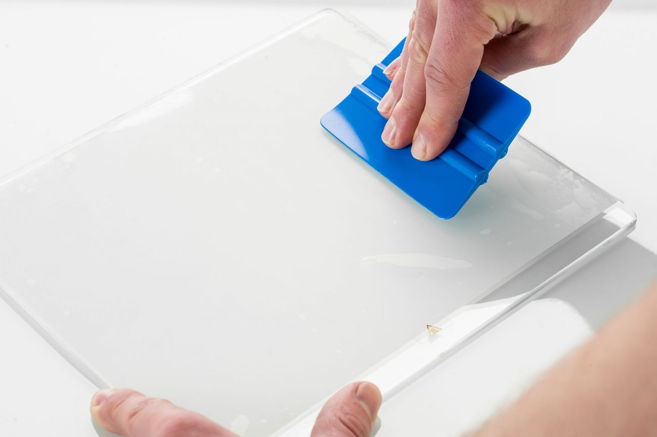

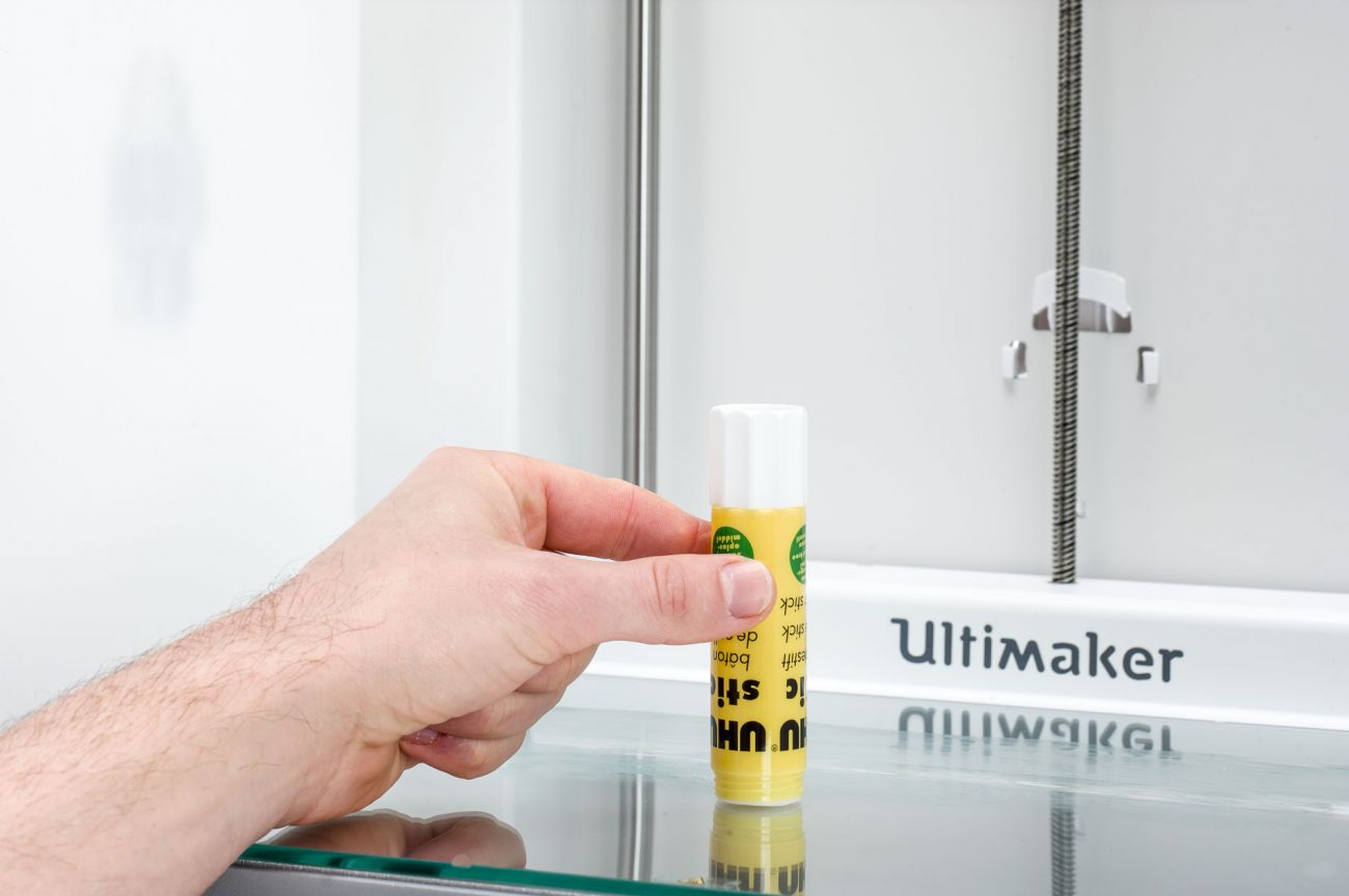

For the glass build plate, ensuring proper adhesion can be a bit trickier. For UltiMaker S series that use a glass build plate and the UltiMaker 3 series, it is recommended to apply a layer of glue to the glass plate. On the UltiMaker 2 series, an adhesion sheet is advised. In addition to their adhesive properties, glue or adhesion sheets serve as a protective layer for the glass plate. Not using glue or adhesion sheets results in a high risk of chipping the glass plate when removing the print.
How_to_print_with_UltimakerCPE__Glue_applied_to_the_build_plate.jpgHow_to_print_with_UltimakerCPE _Adhesive_sheets_applied_to_the_build_plate.jpg
To minimize warping when printing more complex prints with UltiMaker CPE+, it is recommended to apply a thin layer of Magigoo original glue to the glass plate. This glue offers better results than the UHU glue stick for CPE+ prints.
Caution: The addition of glue is recommended to improve adhesion and thereby prevent the chance of print failure and printer damage. Additionally, the use of glue can prevent over-adhesion, which could otherwise lead to damage to the build plate. It is not advised to print directly on a clean glass plate with UltiMaker CPE+.
