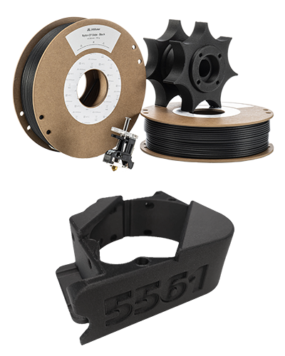

Engineered for industrial applications where tribological performance is needed, Nylon CF Slide is a Nylon 612 CF copolymer offering wear resistance, temperature stability up to 180 °C, and PFAS-free performance.
UltiMaker Nylon CF Slide has optimized settings for the UltiMaker S and Factor Series. This ensures a good end-of-filament and end-of-print experience and an optimal build environment. Please make sure to use the latest version of UltiMaker Cura and keep the printer's firmware up to date.
Nylon CF Slide is only available as black filament.

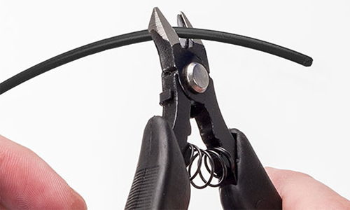

Loading the filament
Tip: For the best results, a pencil sharpener can also be used to shape the filament tip.

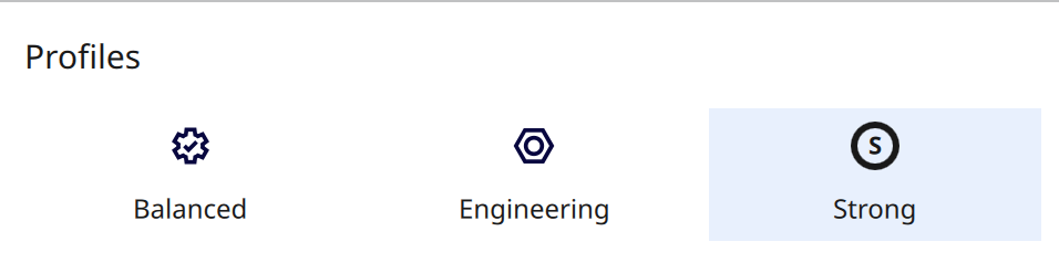

Cura profiles
Nylon CF Slide supports intent print profiles. UltiMaker S series printers offer 'Balanced' and 'Engineering' profiles, where the engineering print profiles focus on enhanced dimensional accuracy. Additionally, a 'Strong' profile on the UltiMaker Factor Series printers results in exceptional Z strength, exceeding a Z tensile strength of 40 MPa.
Tip: Follow the annealing Nylon CF Slide instructions that result in strong, temperature-resistant, and dimensionally accurate parts.
