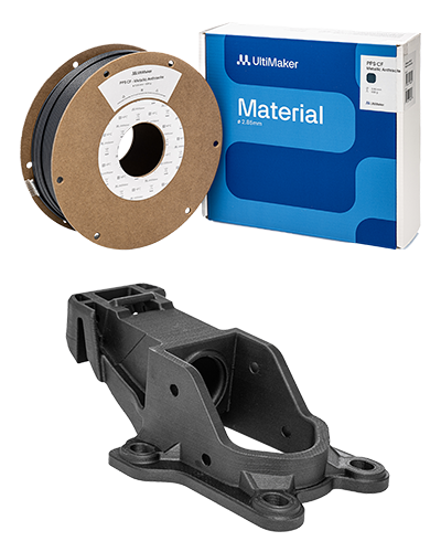

Note: This article contains information about UltiMaker 2.85 mm PPS CF material. Similar quality cannot be guaranteed with third-party filaments. This material can be used on the UltiMaker Factor Series, but is not compatible with any other UltiMaker or MakerBot printer.
Ultimaker PPS CF is a carbon fiber-reinforced polyphenylene sulfide (PPS) filament and the next-level composite material for the UltiMaker Factor Series. It has excellent performance while still being easy to print using the HT print core. PPS CF prints reliably with great precision on the Factor 4 and Factor 4 Plus, yielding flame-retardant, temperature-resistant (> 230 °C), and chemical-resistant (insoluble in all solvents below 200 °C) parts. It has great strength and stiffness with next-level durability. Replace metal and PEEK parts with a cost-effective and easy-to-manufacture solution.
PPS CF is available in a single color: Metallic Anthracite.

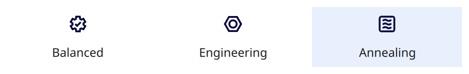

UltiMaker PPS CF supports intent print profiles. The Engineering profile is optimized for dimensional accuracy, and the Balanced profile offers a good compromise of all settings. PPS CF also has an Annealing profile for when the print will be post-processed. This profile retains the dimensional accuracy of the printed part after annealing and improves strength, stiffness, and thermal resistance.
Note: No Visual intent profiles are available for PPS CF, as this is intended as an engineering material.
