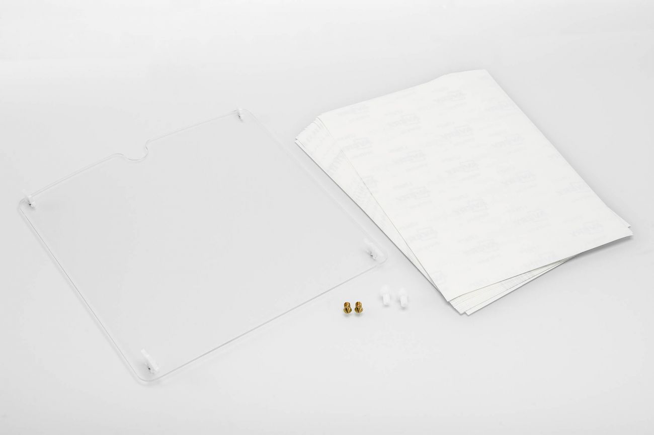

The Advanced 3D Printing Kit contains the following items:
  • 1x Front enclosure
  • 25x Adhesion sheet
  • 2x 0.4 mm nozzle
  • 2x TFM coupler

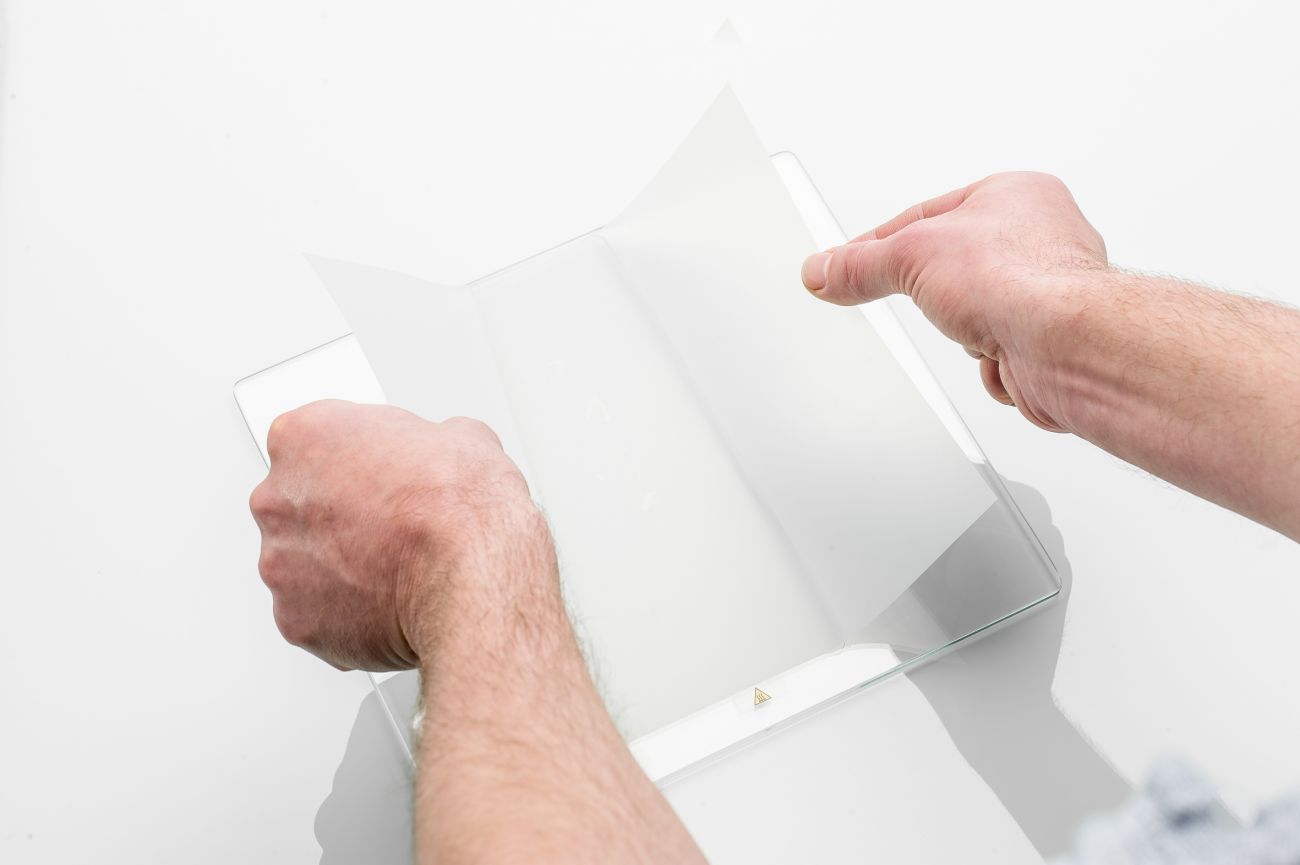

The adhesion sheets can be used for most materials to improve adhesion to the build plate. They replace the glue stick and can be used multiple times. It is important that the sheet is applied correctly to prevent air bubbles and to ensure a flat printing surface. You can find instructions on how to apply the sheet here:
How to use adhesion sheets

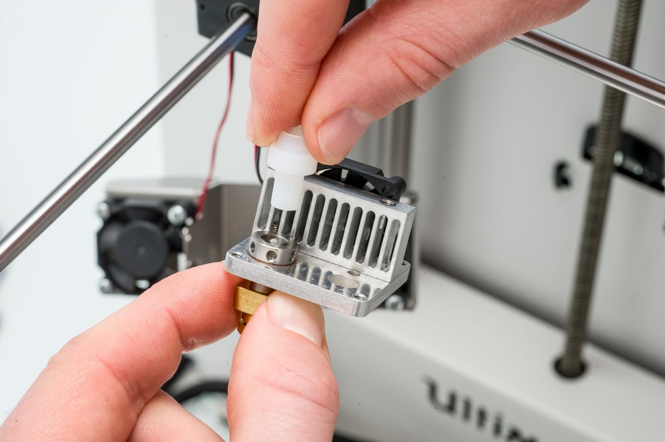

Most engineering materials print at higher temperatures. This could decrease the lifespan of the TFM coupler. There are two new couplers included in the Advanced 3D Printing Kit, to minimize your Ultimaker’s downtime when the TFM couplers are due for a replacement. Instructions on how to replace it can be found here:
Replace the Ultimaker 2+ TFM coupler

Adhesion sheets
The adhesion sheets are (highly) recommended for CPE+, PC, and PP. These materials require a bed temperature of 110 °C, but despite this high temperature may still have problems with adhesion to the build plate.
For most other materials the sheets are optional as they replace the use of the glue stick. Only for TPU 95A, we advise against printing on the adhesion sheet; this material simply sticks too well to the sheet, and removing the print from the platform is extremely difficult.
