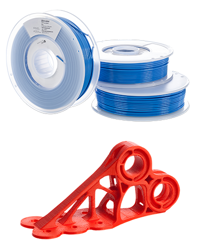

CPE (co-polyester) is a chemical-resistant and relatively tough material widely used for functional prototyping and modeling. This co-polyester is similar to PETG, but with enhanced chemical resistance. Here you will learn how to achieve the best print quality with UltiMaker CPE.

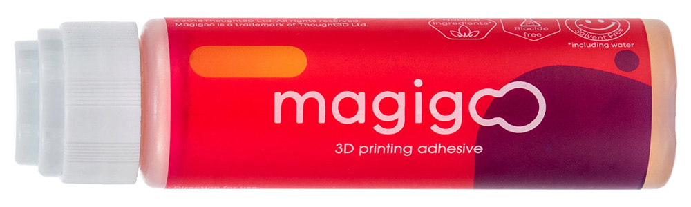

To minimize warping when printing more complex prints with UltiMaker CPE, it is recommended to apply a thin layer of Magigoo original to the glass plate.
Caution: For UltiMaker CPE, the use of glue is recommended to improve adhesion and thereby prevent the chance of print failure and printer damage. Additionally, the use of glue can prevent over-adhesion, which could otherwise lead to damage to the glass plate. It is not advised to print directly on a clean glass plate with UltiMaker CPE.
