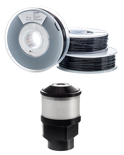

PC (polycarbonate) is a very strong and tough material that can be used for various engineering applications. Its material properties make it perfect for printing molds, tools, functional prototypes, and parts for short-run manufacturing. Here are guidelines for getting started with UltiMaker PC and tips to achieve the best 3D print results.
UltiMaker PC is available in the following colors:
