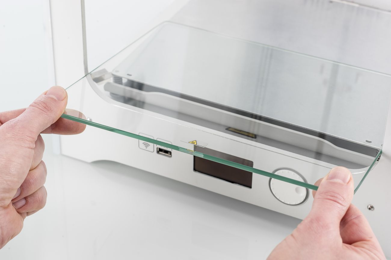

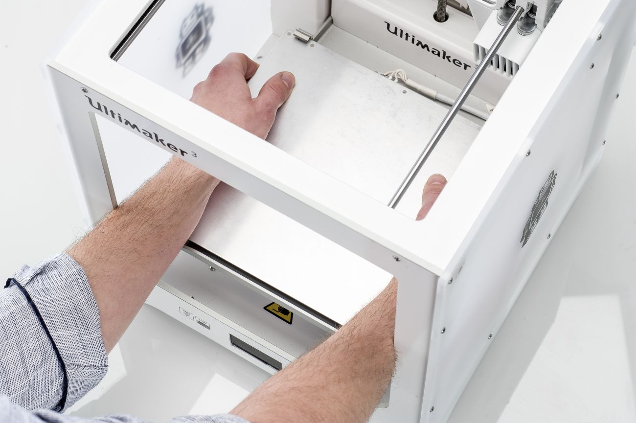

1. Remove the glass plate
Open the two build plate clamps at the front. Slide the glass plate towards the front and remove it from the printer.

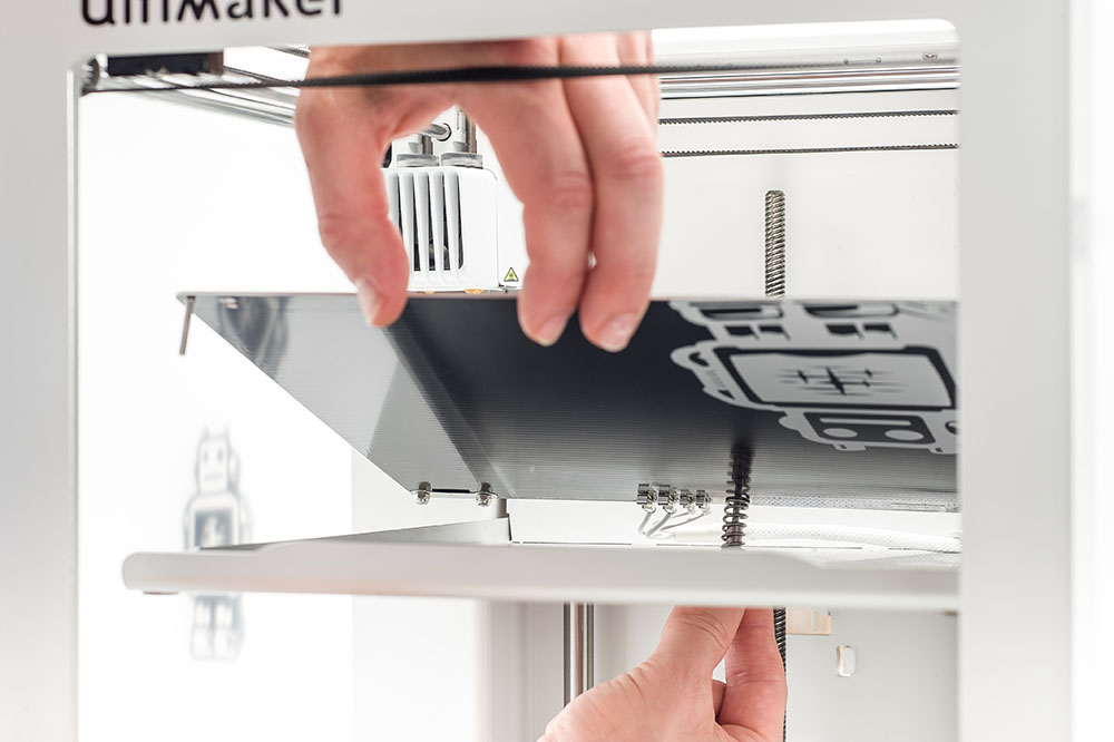

2. Move the Z stage up
Place the print head in a corner for better access. Hold the build plate on each side and manually move it halfway up.

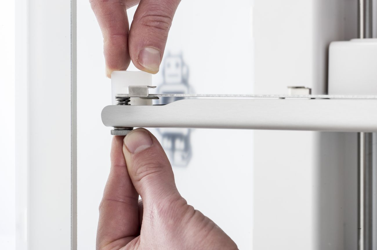

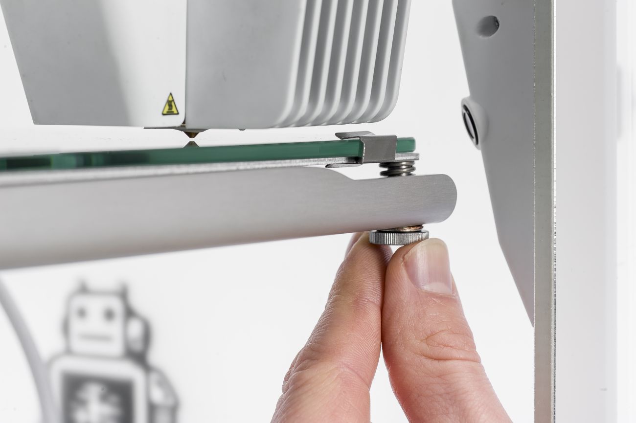

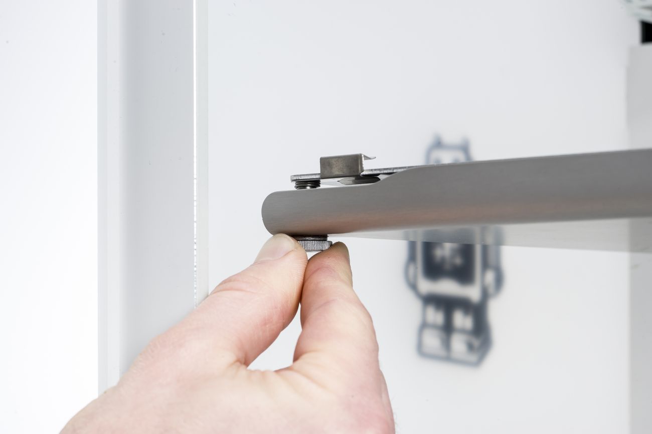

3. Remove the thumb wheels
Loosen and remove the three thumb wheels from the underside of the base plate. Also remove the washers, which may remain stuck to the plate. Place them around the thumb wheels with the greased side facing up.

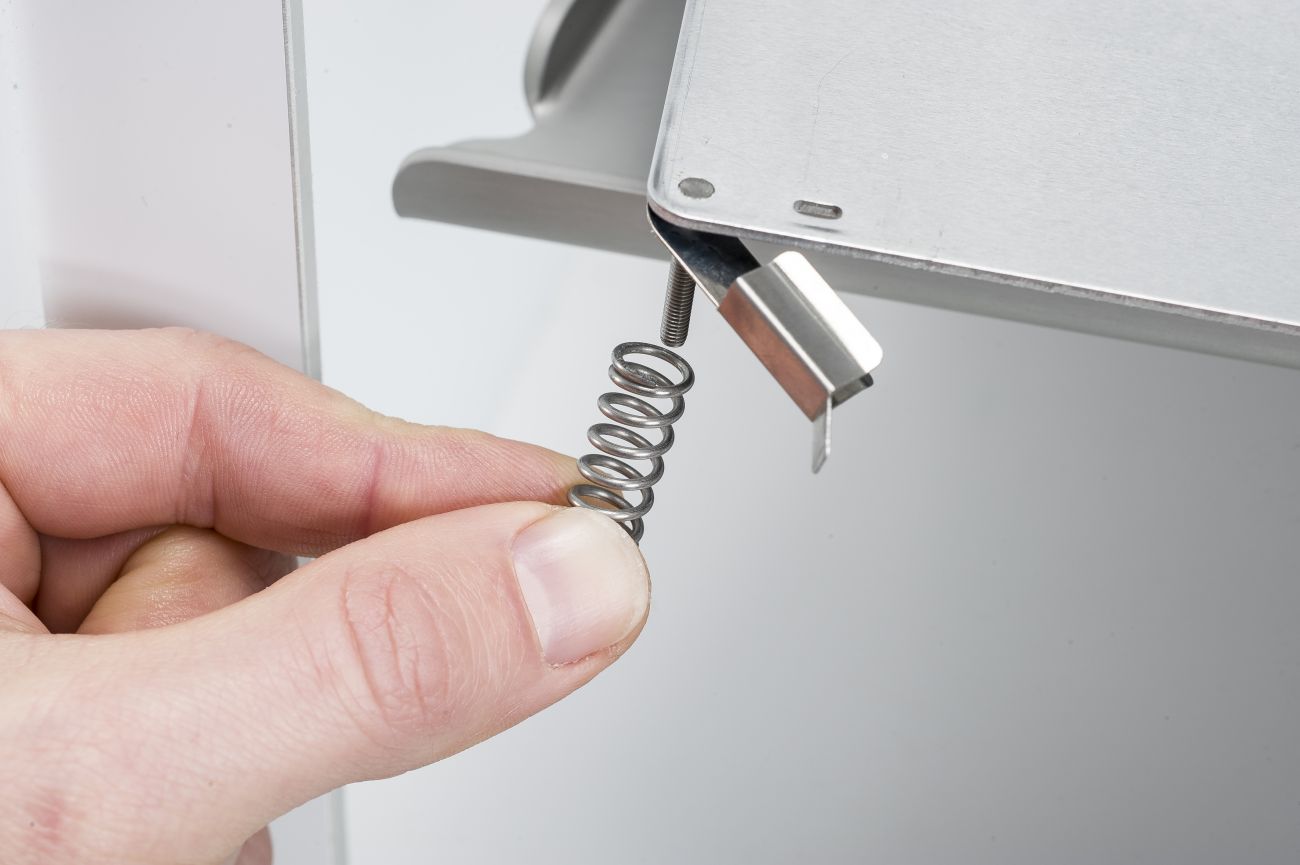

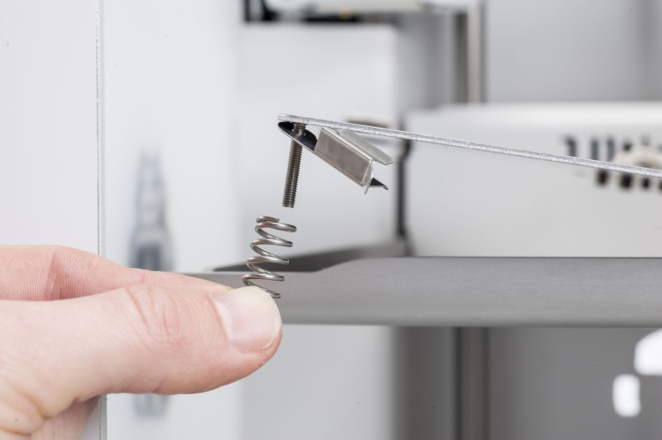

4. Remove the springs
Gently lift up the heated bed and remove the springs from all three bolts which are integrated into the build plate.

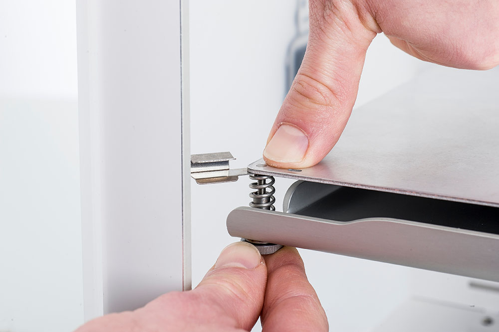

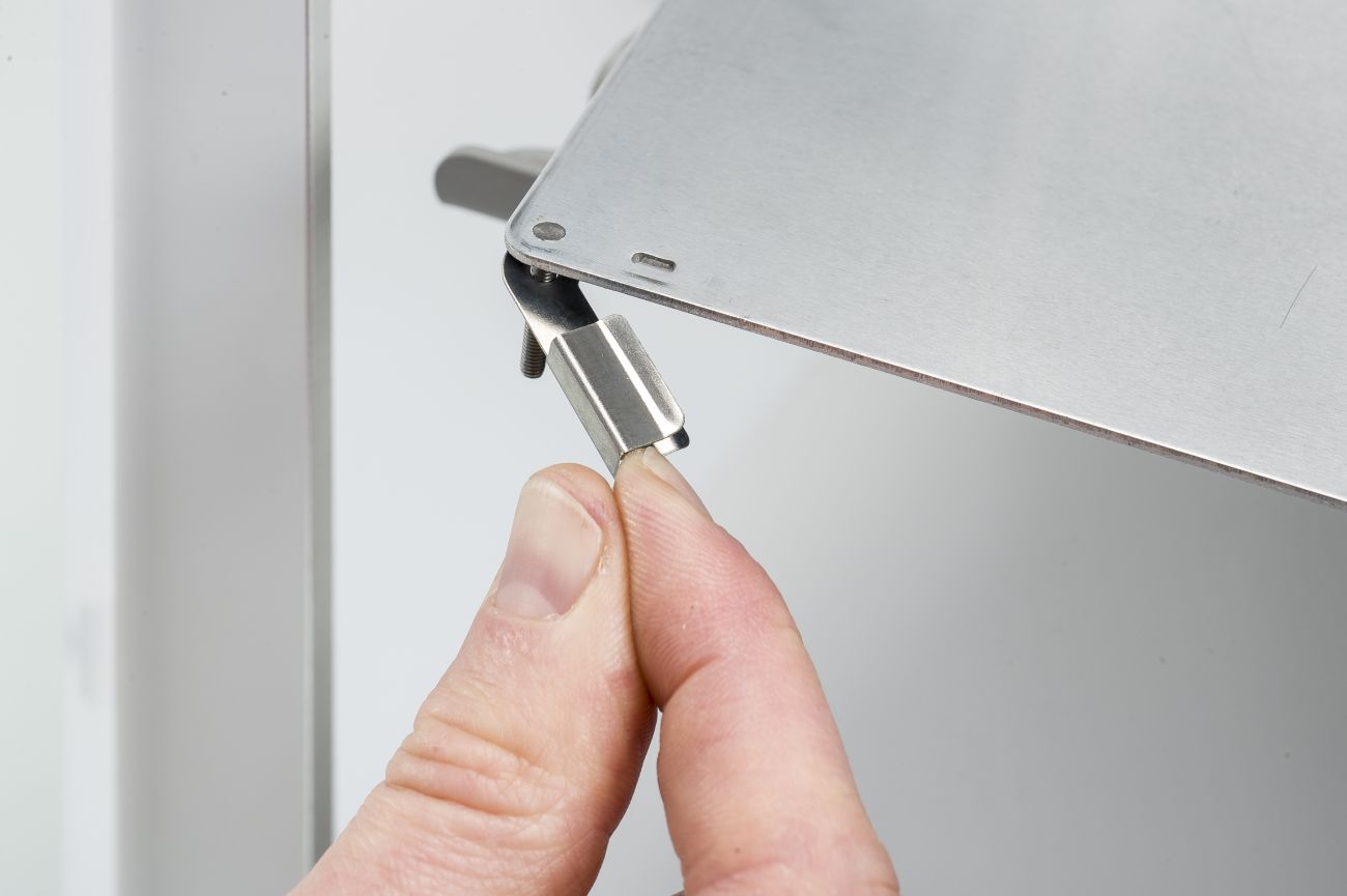

5. Remove the front clamps
Remove the two build plate clamps at the front of the build plate and place them aside. They can otherwise easily fall off and get lost.

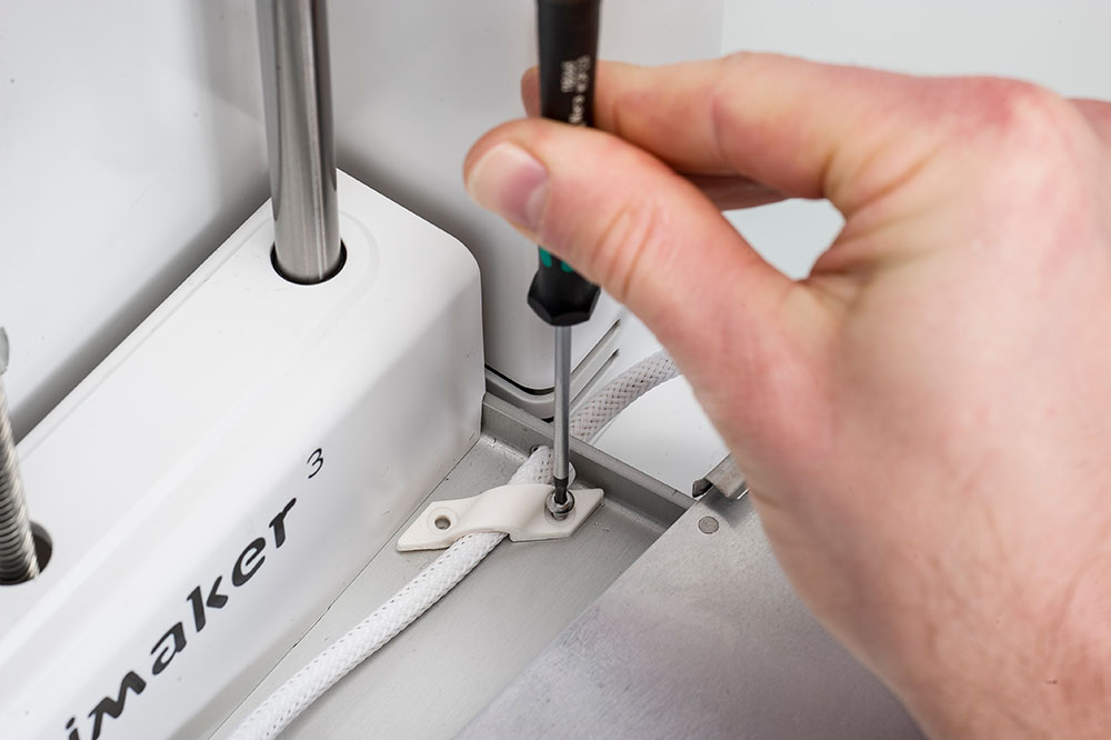

7. Remove the cable clip
Use a 2 mm hex screwdriver to loosen and remove the bolts that secure the heated bed cable clip. This step is not required, but allows you to move the build plate out of the printer.

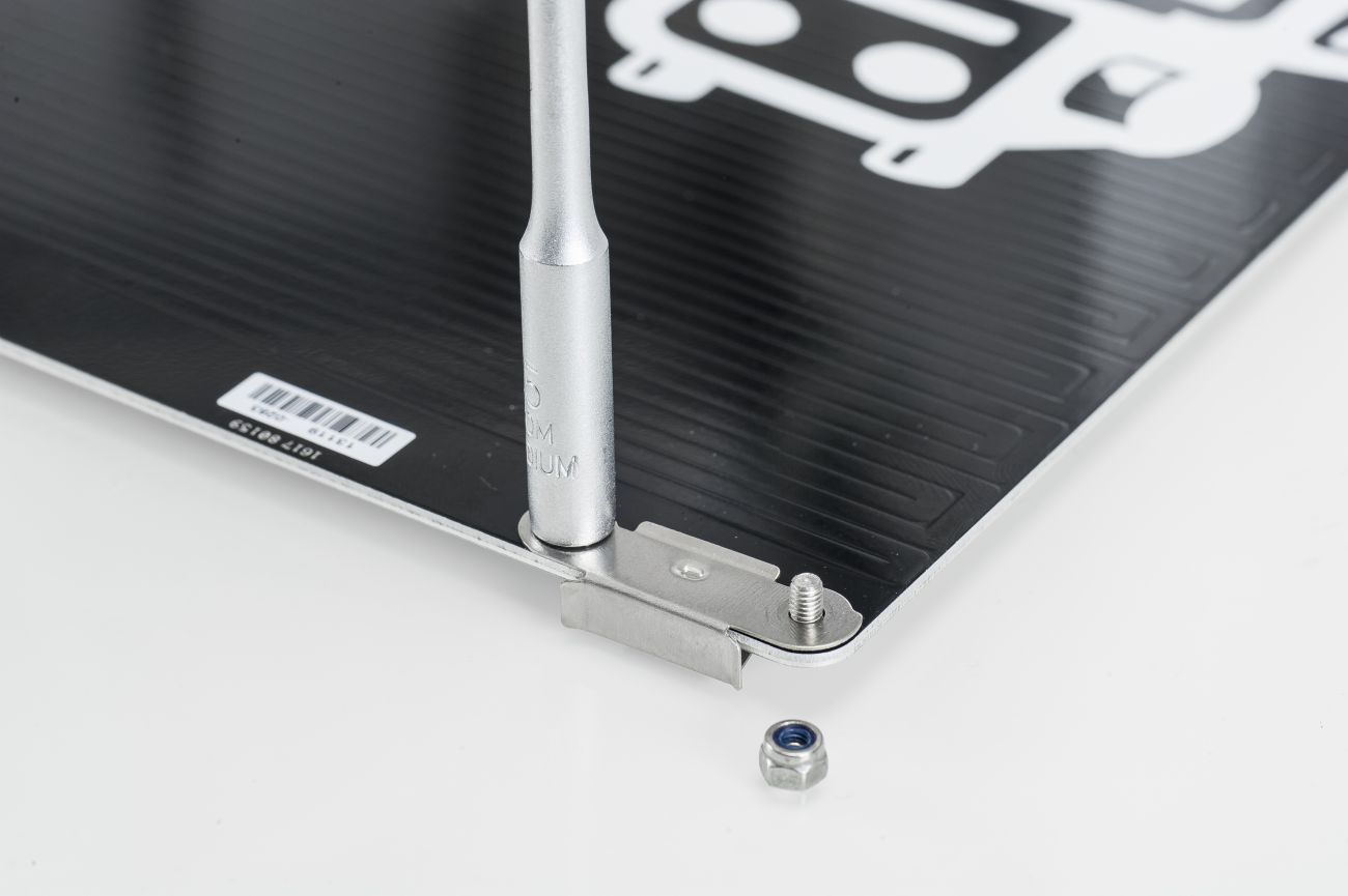

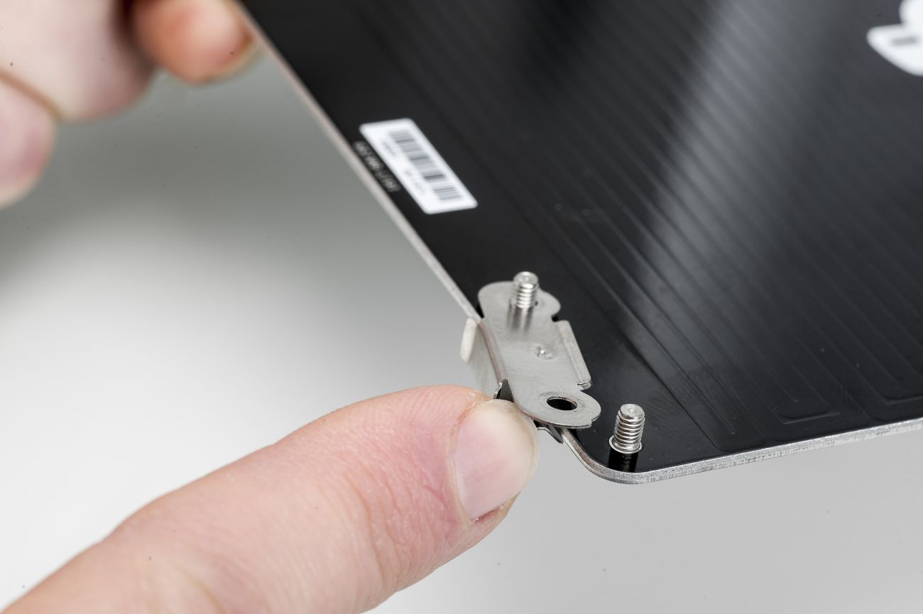

8. Remove the lock nuts
Turn around the heated bed so the black side is facing up. Use pliers or a (socket) wrench to remove the two lock nuts from each of the build plate clamps at the back of the bed.

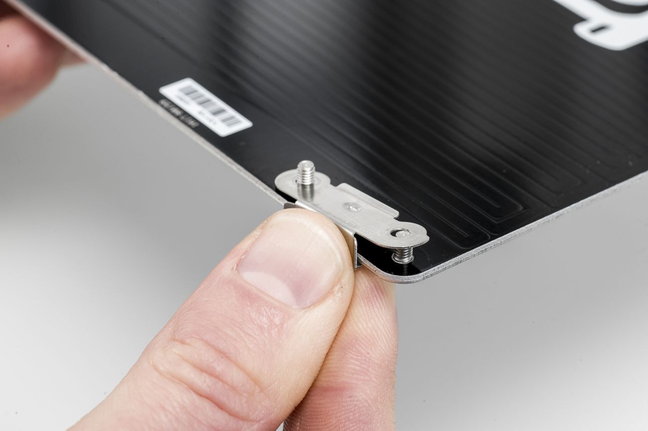

9. Remove the build plate clamps
Press the build plate clamp against the top side of the heated bed. First, lift up the side of the clamp on the outside of the bed and move it over the bolt. Now rotate the clamp 45° and remove it from the other bolt.

1. Place the new clamps
Align the new build plate clamps with the bolts at the back of the build plate. First place them around the bolts on the inside, then rotate and lower them into position.
2. Secure the clamps
Place the lock nuts around the bolts, with the plastic insert facing up. Use pliers or a (socket) wrench to fully secure the lock nuts.

4. Place the front clamps
Gently lift up the front of the bed. First place the front-left build plate clamp around the front-left bolt, then place a spring. Repeat this for the front-right build plate clamp and spring.
5. Secure the front
Align the bed with the base plate. Insert a thumb wheel through the bottom of the base plate. Gently push the bed down and turn the thumb wheel counterclockwise to loosely secure the heated bed. Do this on both sides.
6. Set the right height
Tighten all three thumb wheels until there is a distance of ~14 mm between the top of the base plate and the bottom of the heated bed. Use a ruler or a (printed) spacer to set the correct height.
