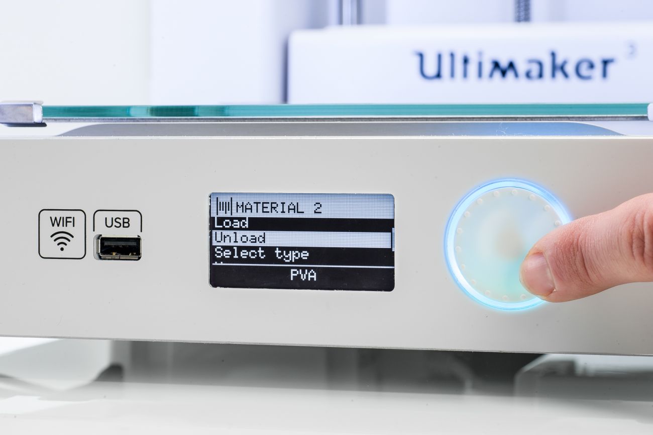

1. Unload the material(s)
In the UltiMaker 3 menu, go to Material/PrintCore → Material [X] → Unload. Select the material(s) for the side(s) where you want to replace the collet. You do not have to remove the spool from the spool holder.

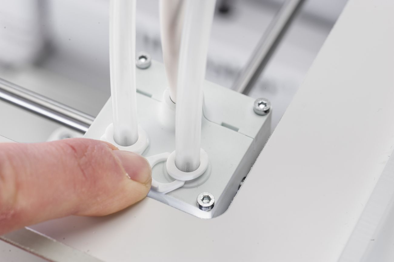

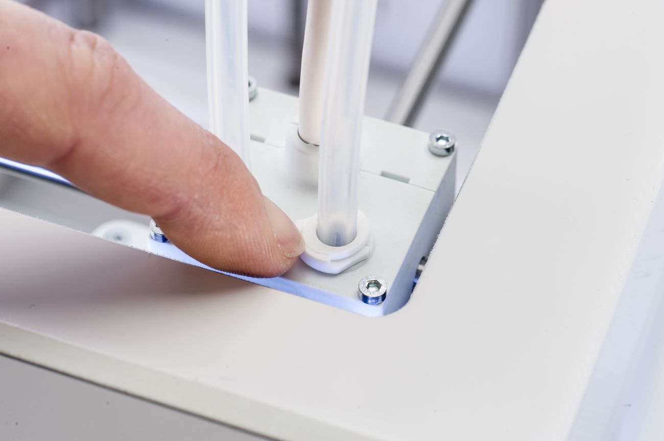

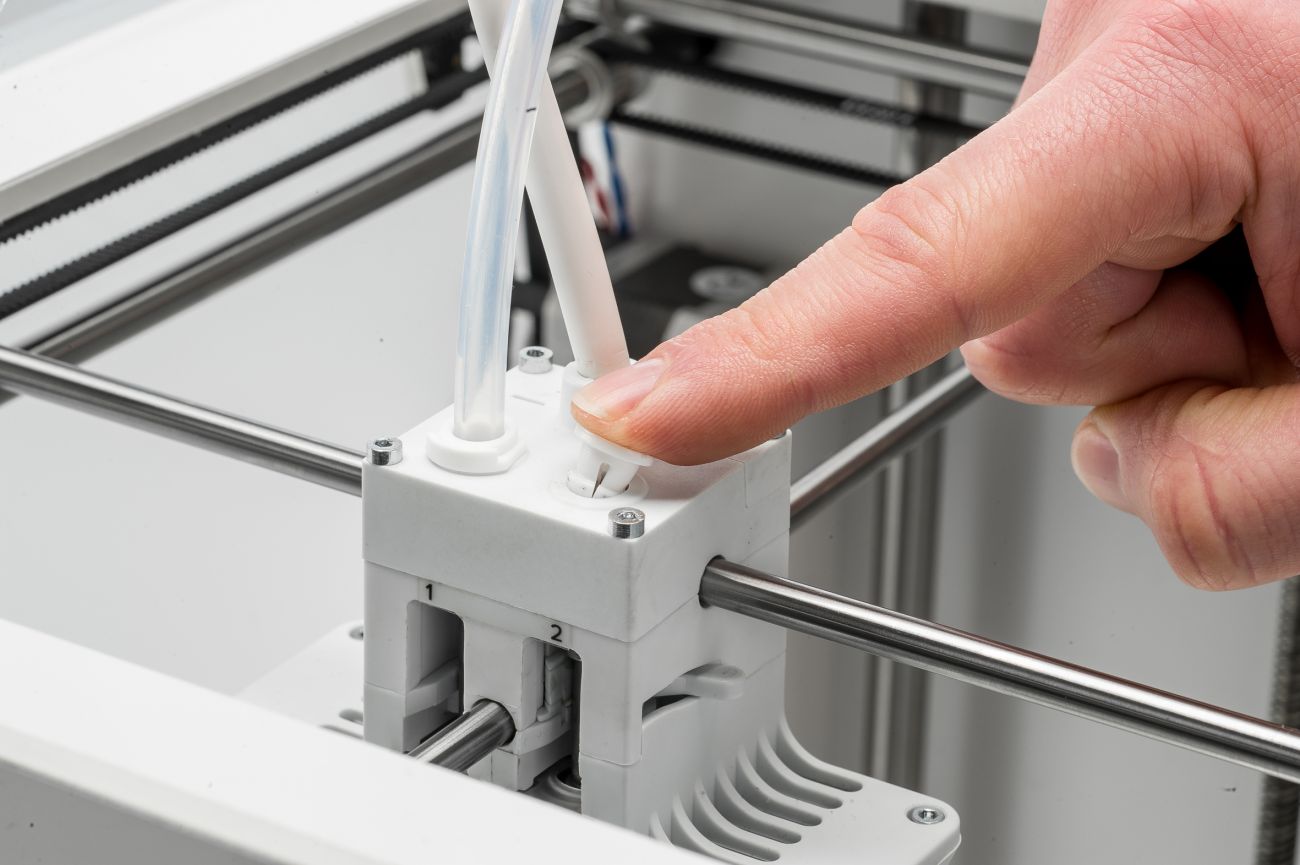

2. Remove the clamp clip
Place the print head in the front-right corner for easier access and remove the clamp clip from around the tube coupling collet.

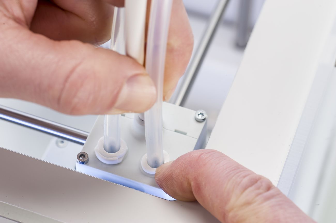

3. Remove the Bowden tube
Press down on the tube coupling collet while pulling the Bowden tube out of the print head or feeder.

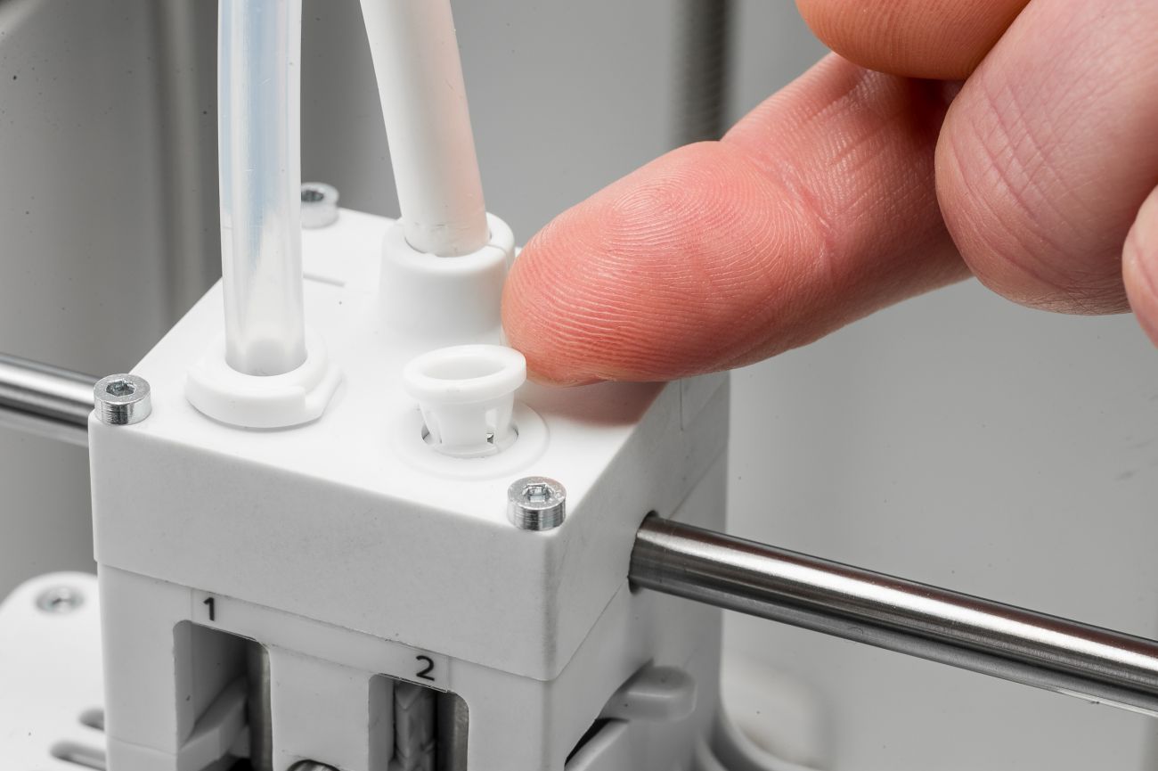

4. Remove the tube coupling collet
Place your fingernail under the edge of the tube coupling collet and pull it out of the print head or feeder.

1. Insert the tube coupling collet
Push the four legs of the new tube coupling collet slightly inwards and insert it into the hole in the print head or feeder.
2. Insert the Bowden tube
Keep the collet pressed down while pushing the Bowden tube back into the print head or feeder.
3. Place the clamp clip
Keep the Bowden tube in position and place the clamp clip around the tube coupling collet to lock the Bowden tube in place.

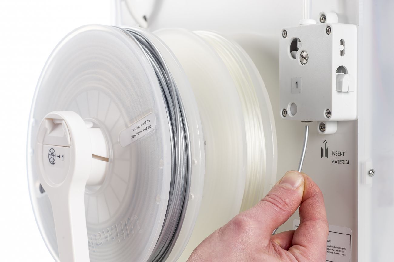

4. Reload the material(s)
In the UltiMaker 3 menu, go to Material/PrintCore → Material [X] → Load. Insert the material into the feeder and follow the instructions on the display.
