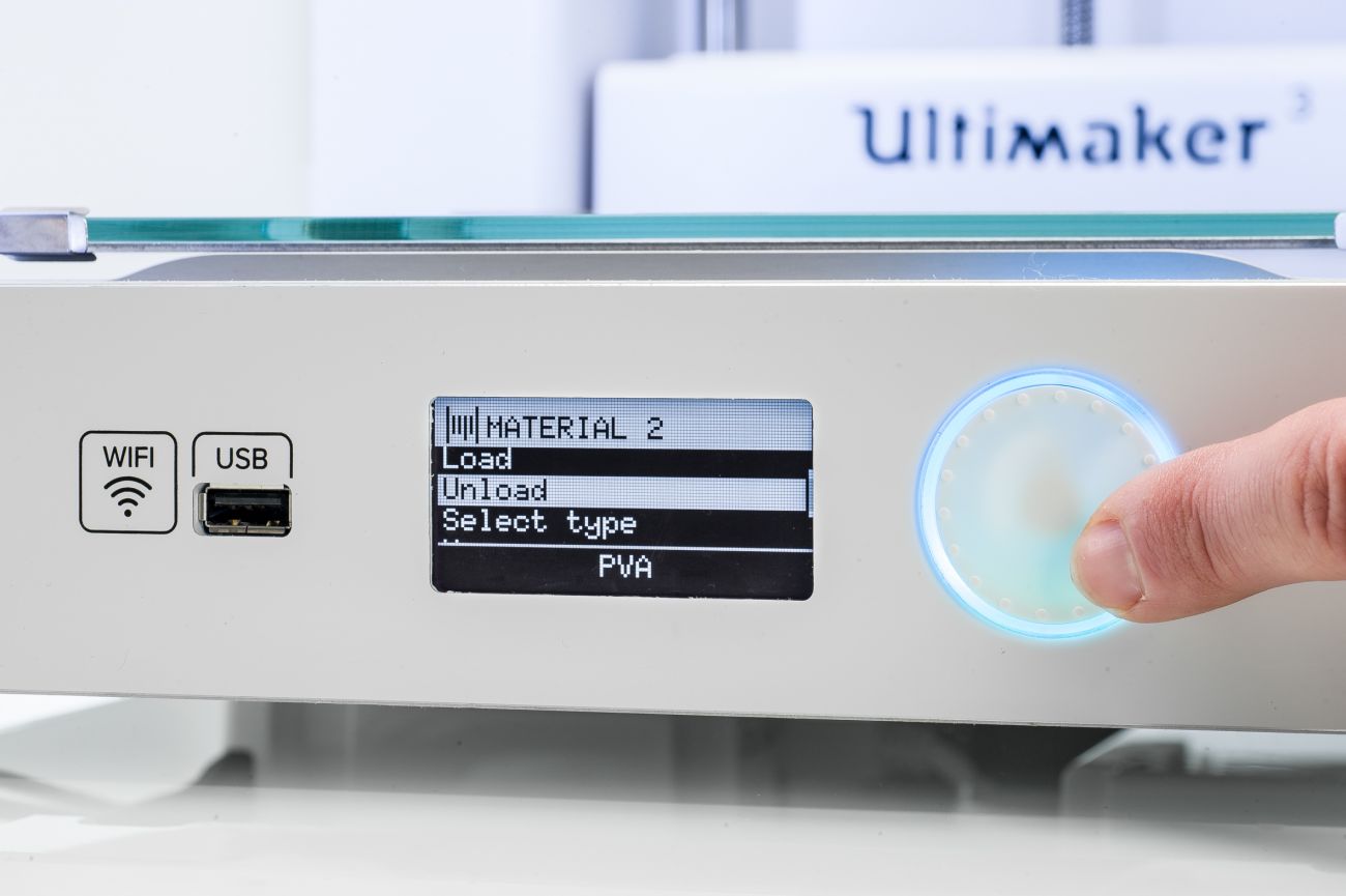

1. Unload the material(s)
In the UltiMaker 3 menu, go to Material/PrintCore → Material [X] → Unload. Select the material(s) for the side(s) where you want to replace the Bowden tube. You do not have to remove the spool from the spool holder.

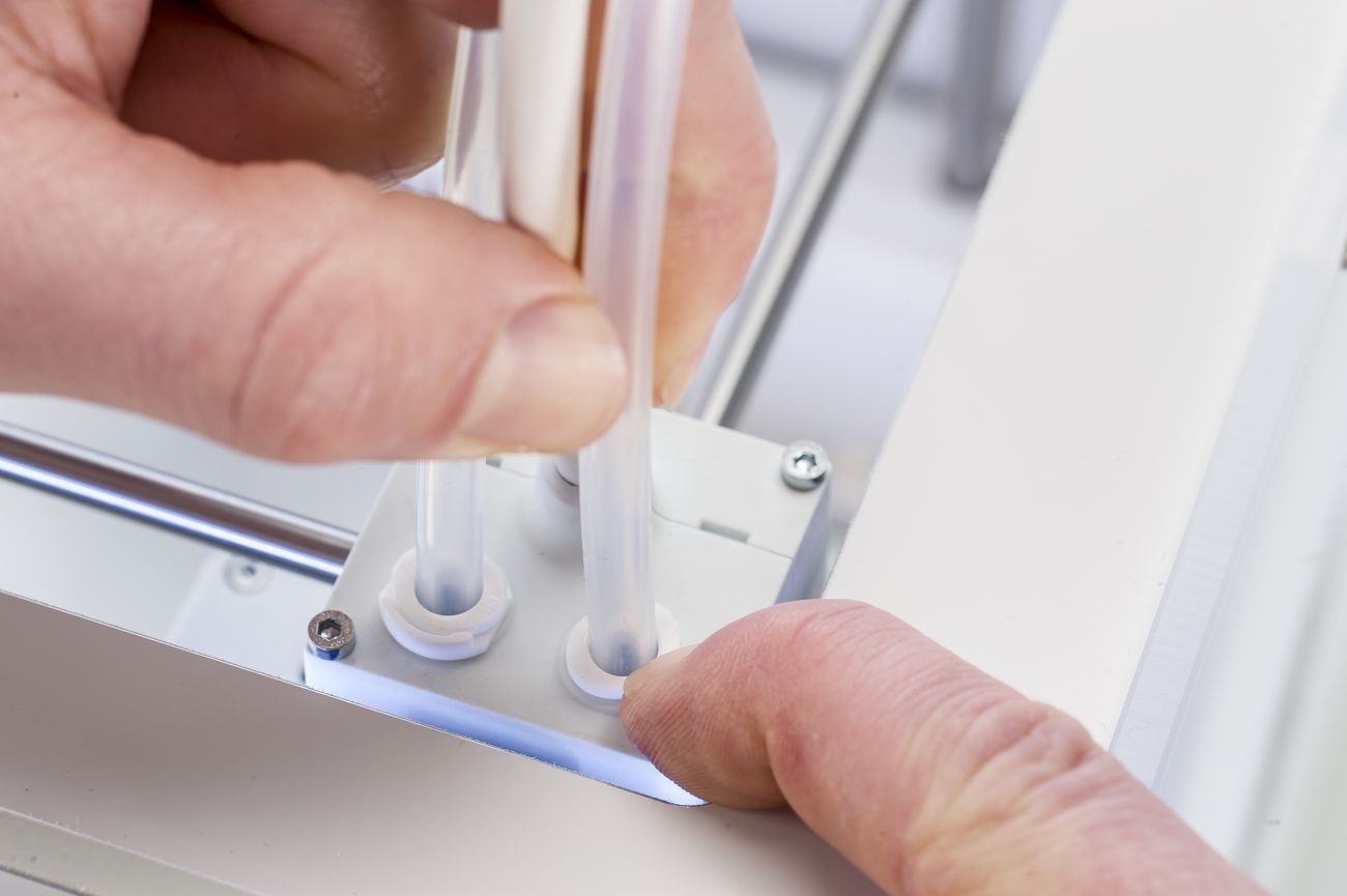

2. Remove the print head clamp clip(s)
Place the print head toward the front for easier access and remove the clamp clip from around the tube coupling collet. Repeat this for the other side, if both Bowden tubes will be replaced.
3. Remove the Bowden tube(s) from the print head
Press down on the tube coupling collet while pulling the Bowden tube out of the print head. Repeat this for the other tube, if both will be replaced.

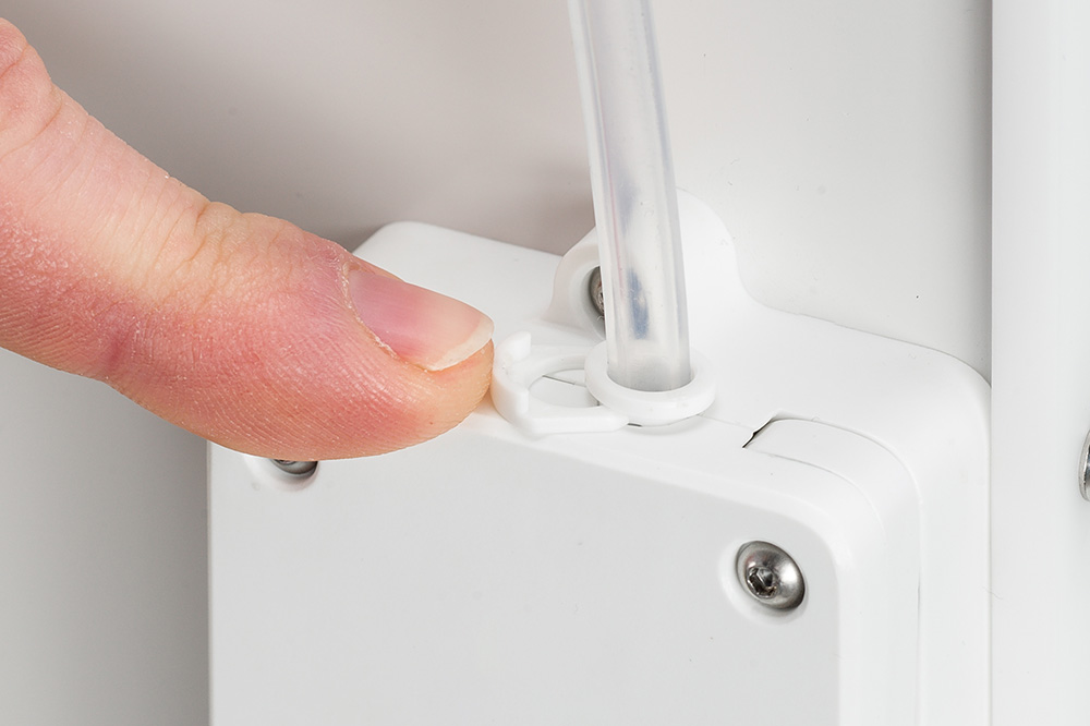

4. Remove the feeder clamp clip(s)
At the back of the printer, remove the clamp clip from the tube coupling collet on feeder 1 and/or 2.

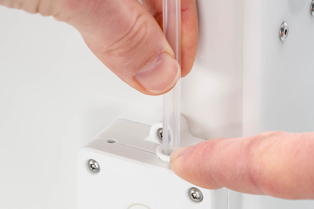

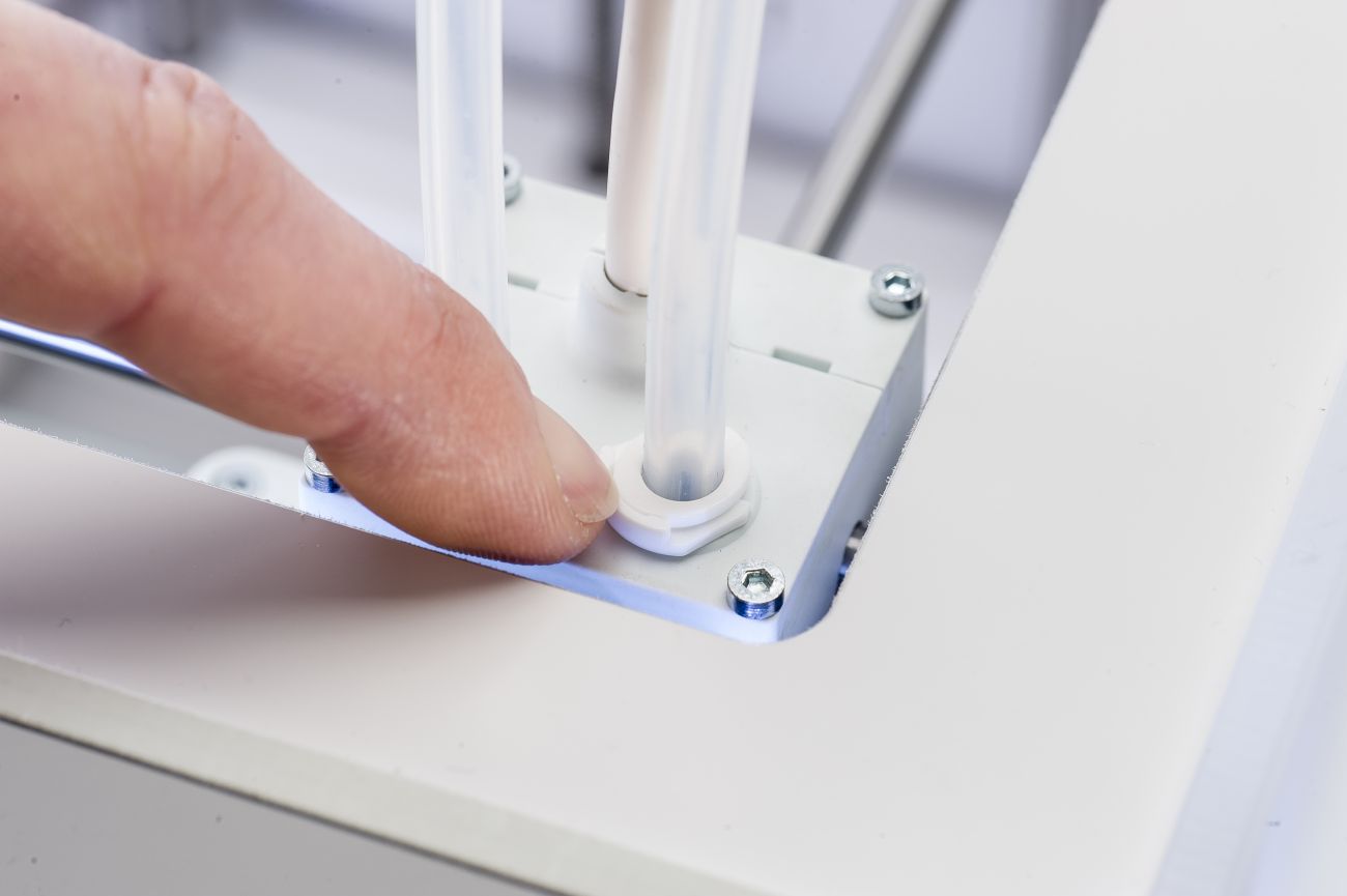

5. Remove the Bowden tube(s) from the feeder(s)
Press down on the tube coupling collet while pulling the Bowden tube out of the feeder. Do this for feeder 1 and/or 2, depending on which tube(s) will be replaced.

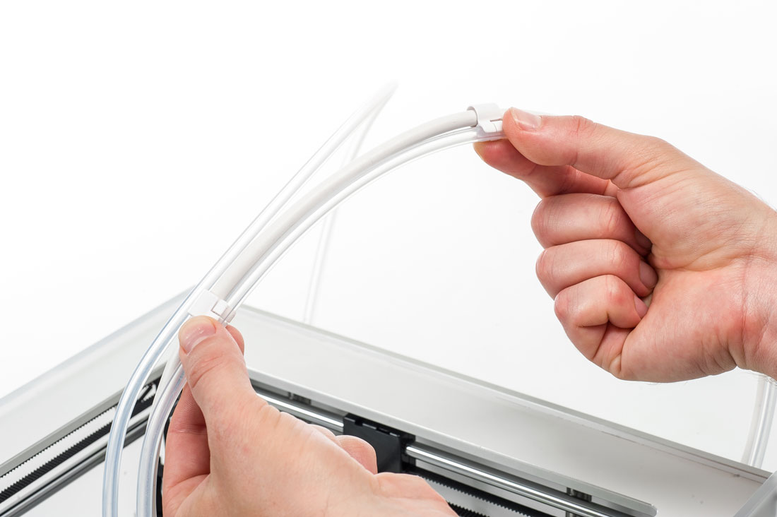

4. Loosen cable clips
When removing the Bowden tube from extruder 2 (right), loosen the four cable clips from the Bowden tube to remove it completely.

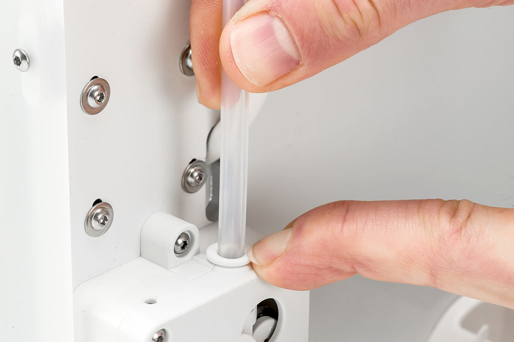

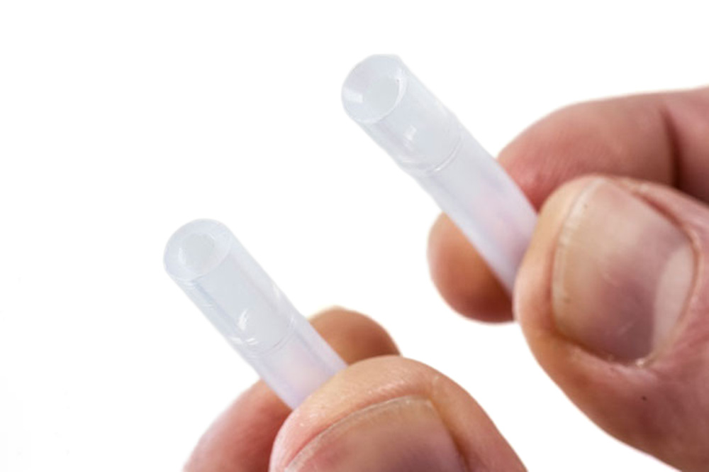

1. Note the two sides of the Bowden tube2. Insert into feeder
Take the new Bowden tube and check the two sides. Older Bowden tubes may have one flat and one chamfered side. The chamfered side should be inserted into the feeder so that the filament enters the tube smoothly. The flat side goes into the print head.
Tip: If both sides are chamfered, the orientation does not matter.
Insert (the chamfered side of) the Bowden tube into the feeder. Keep the collet pressed down and push the Bowden tube all the way in. Secure the tube with the clamp clip.

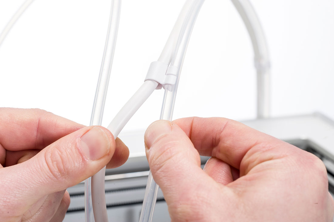

4. Place the cable clips
For Bowden tube 2 (right), click the header cable clips from the print head cable onto the Bowden tube. Equally divide the clips over the Bowden tube, starting at ~10 cm above the print head.

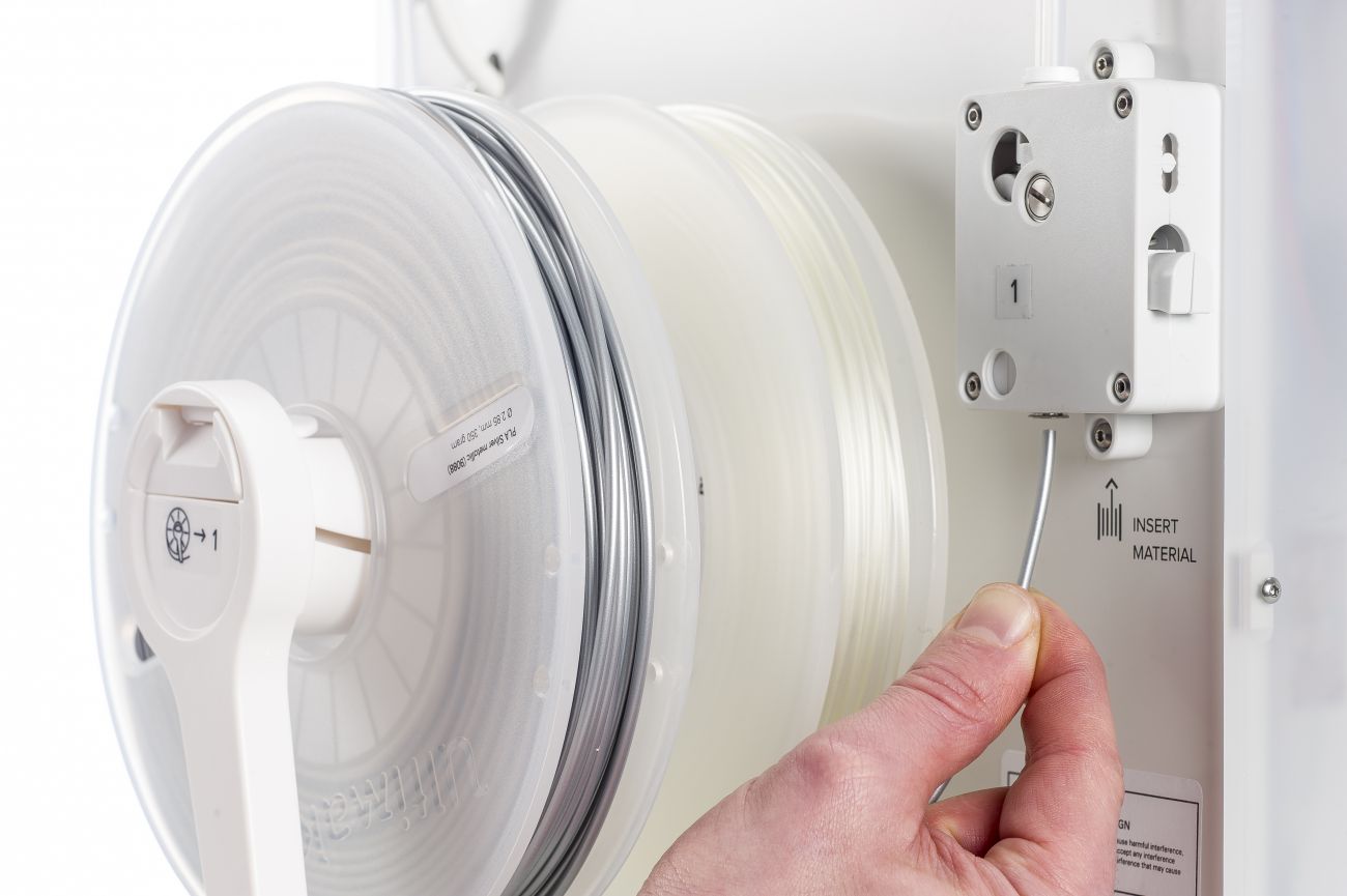

5. Reload the material(s)
In the UltiMaker 3 menu, go to Material/PrintCore → Material [X] → Load. Insert the material into the feeder and follow the instructions on the display.
