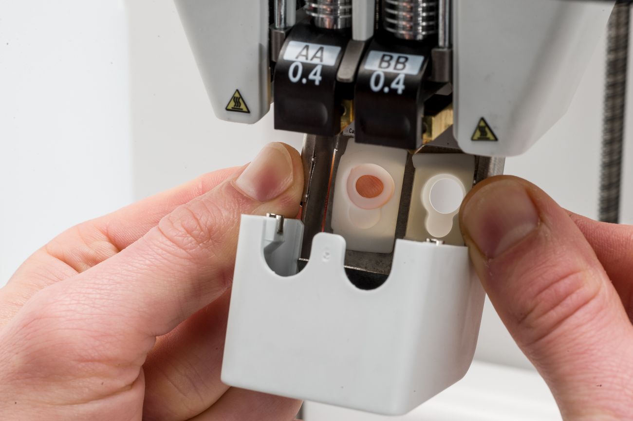

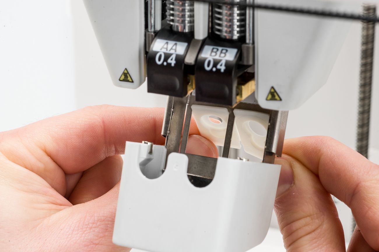

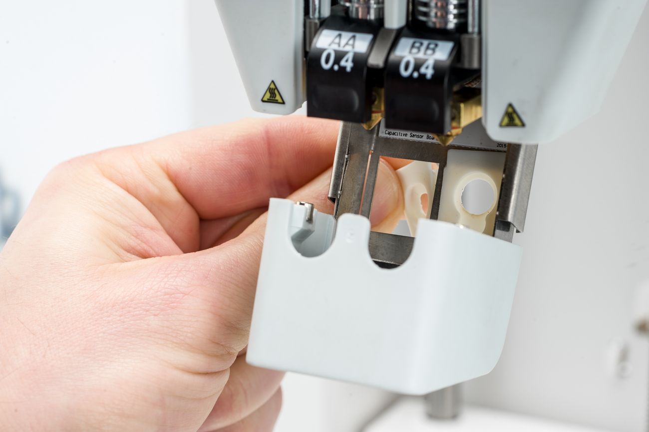

1. Open fan bracket
Manually place the print head in the front-center for easier access. Gently open the front fan bracket.

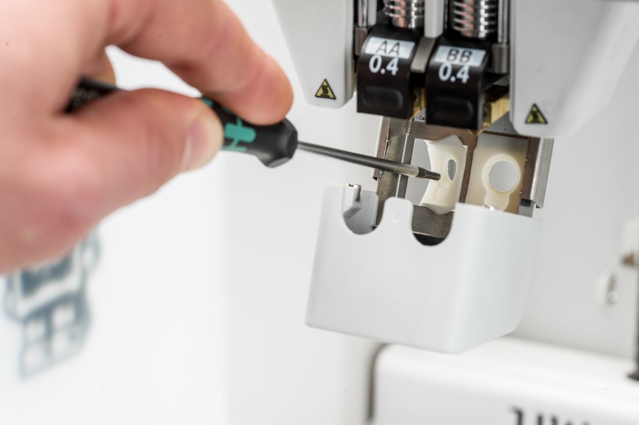

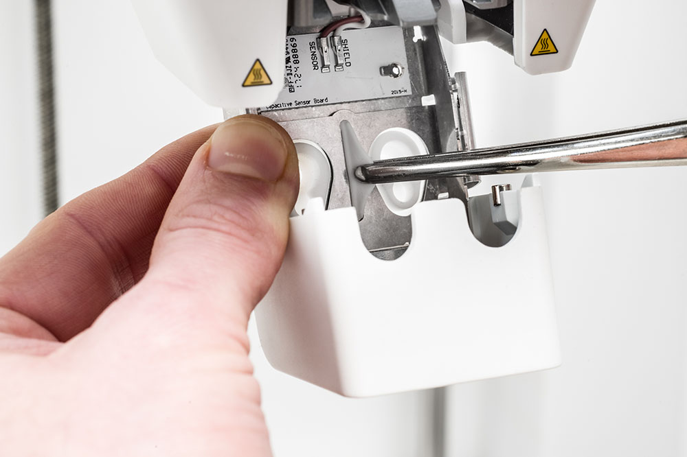

2. Push out nozzle cover
From the inside, push one side of the nozzle cover out of the fan bracket with your finger or using a tool such as a screwdriver.

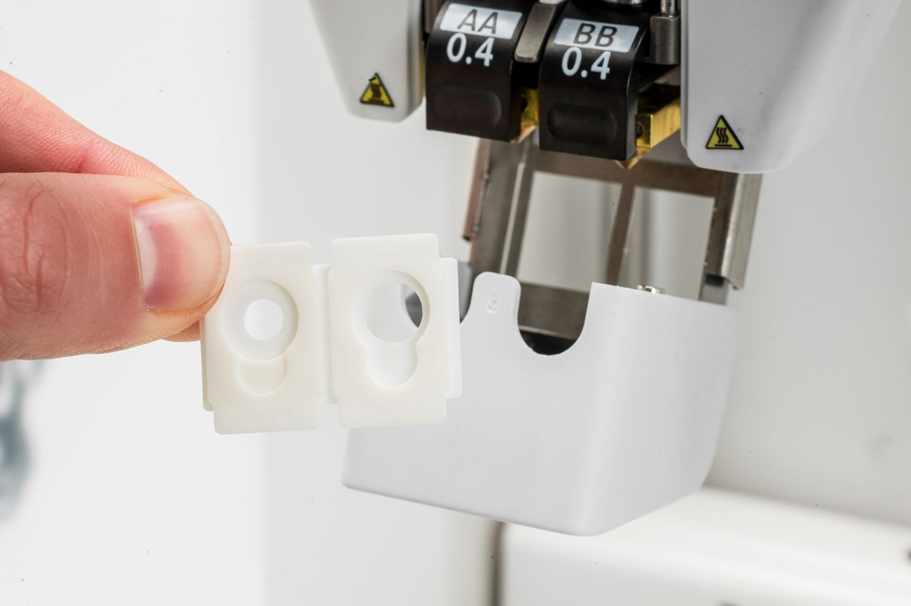

D02.2_Remove-silicone-cover.jfif

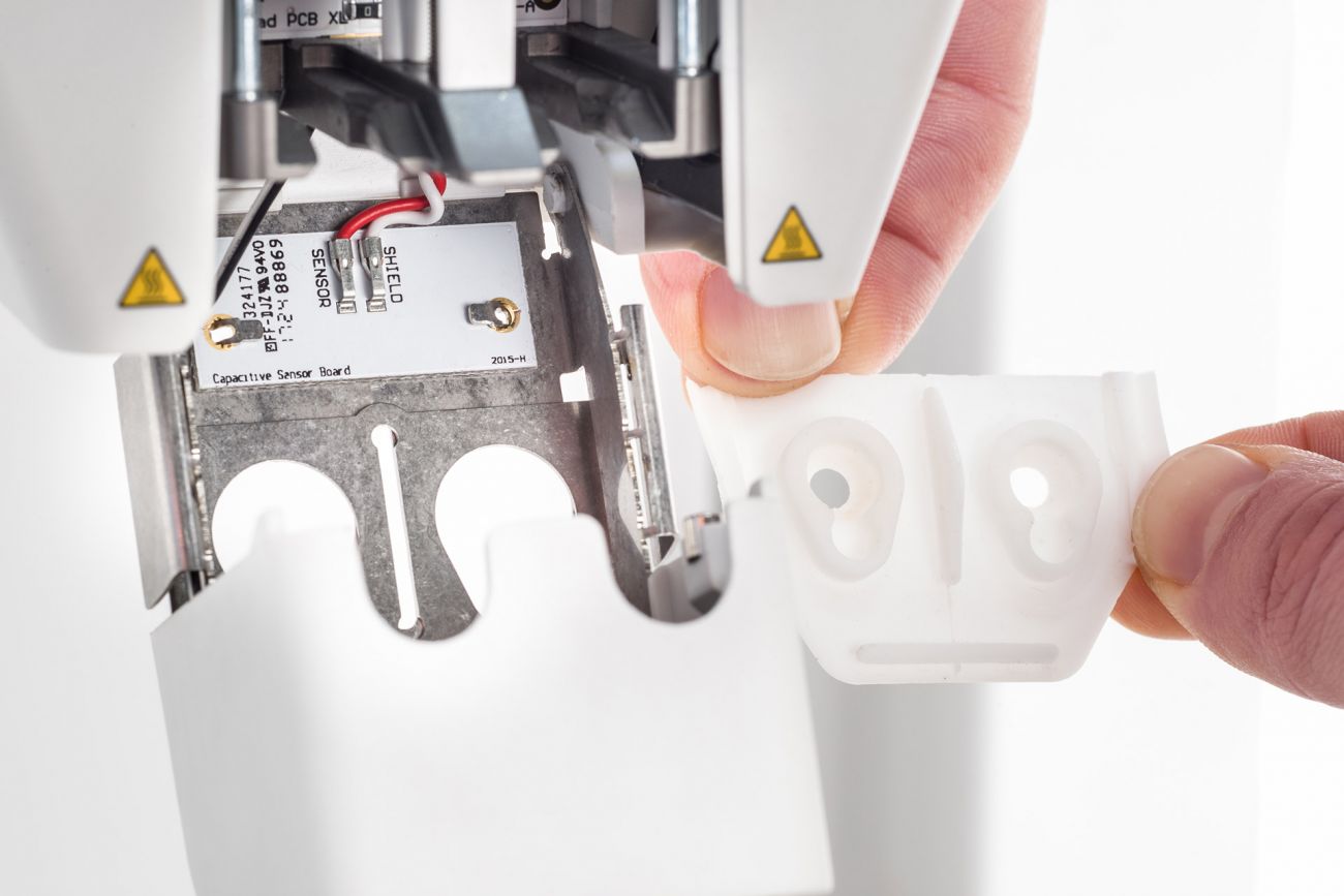

3. Remove nozzle cover
From behind the fan bracket, take the loose side of the nozzle cover and pull it out of the fan bracket.

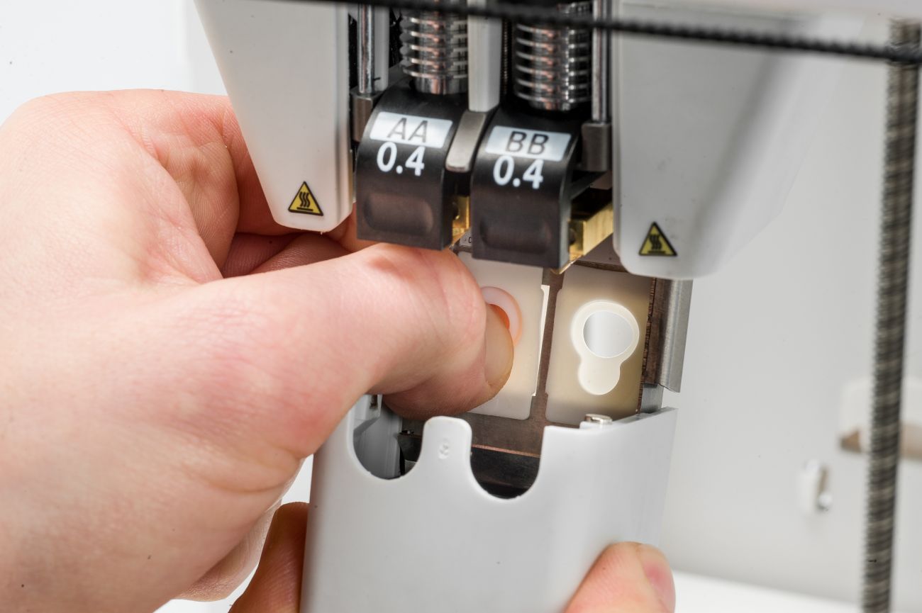

2. Insert top tabs
From behind the fan bracket, first insert the two tabs at the top of the nozzle cover through the holes in the metal bracket.

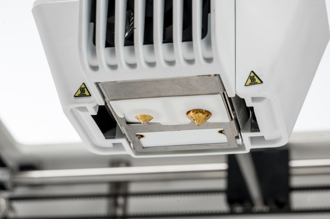

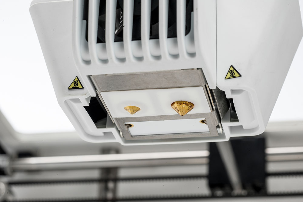

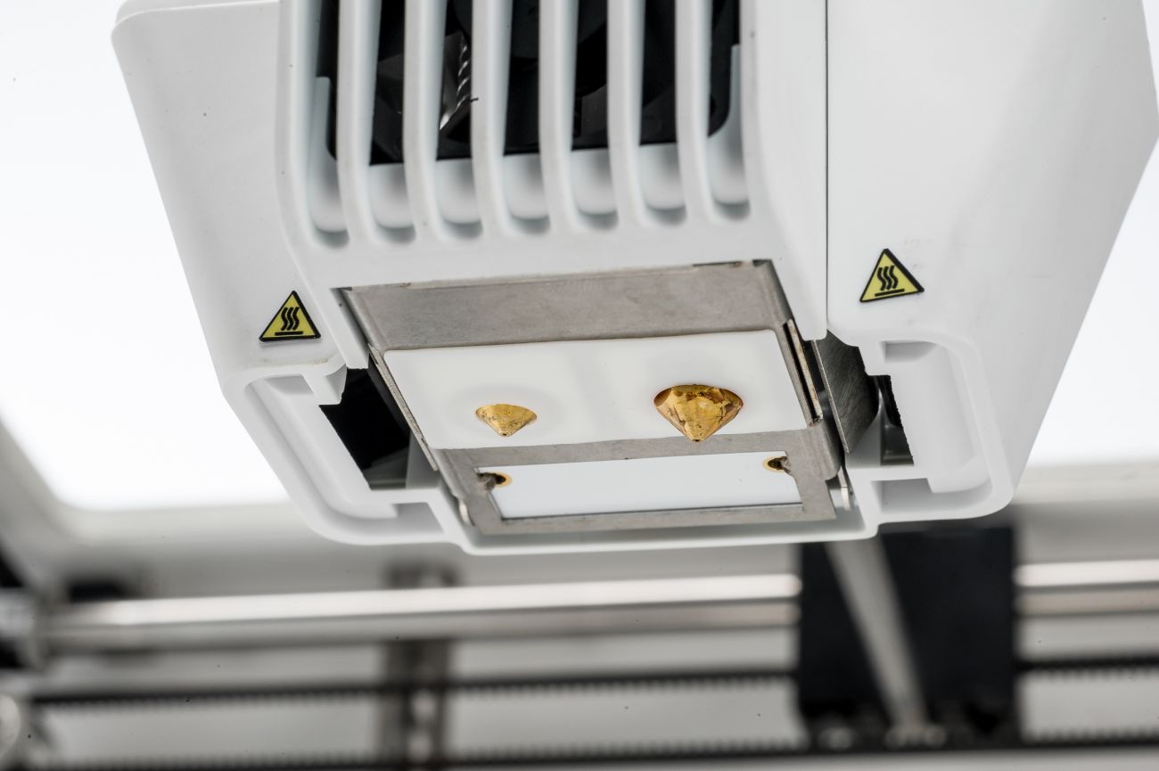

R05.1_Position-silicone-cover-incorrect.jfifR05.2_Position-silicone-cover-correct.jfif
Incorrect placement. One corner is pushed into the bracket. Adjust its position.
Correct placement. The cover is well aligned and completely flat on the underside.

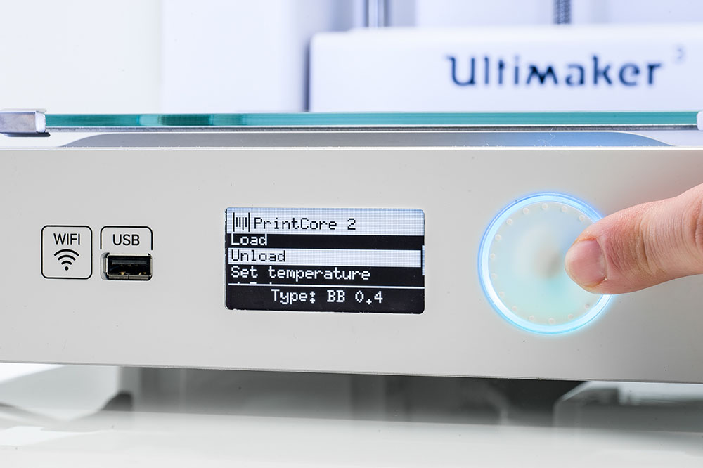

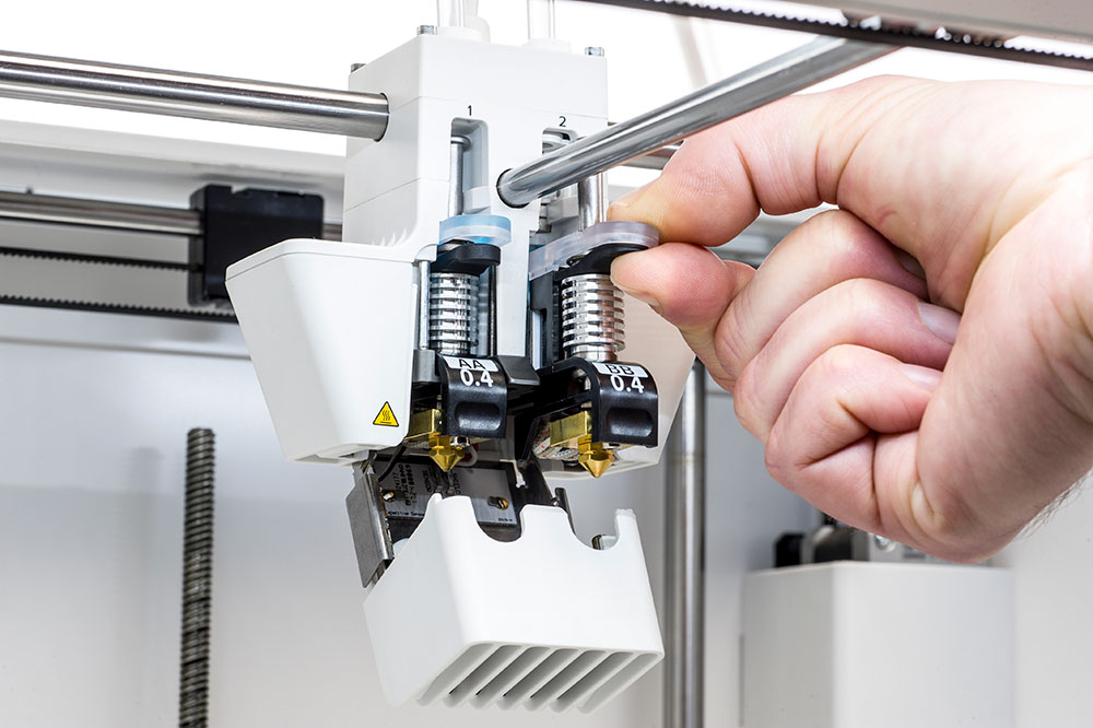

1. Unload print cores
For the new-style nozzle cover, it is recommended to first unload both print cores to provide more space. Go to Material/PrintCore → PrintCore [1/2] → Unload.

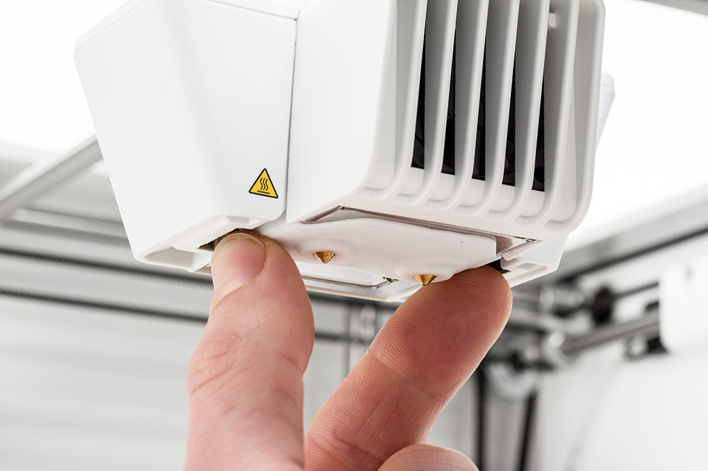

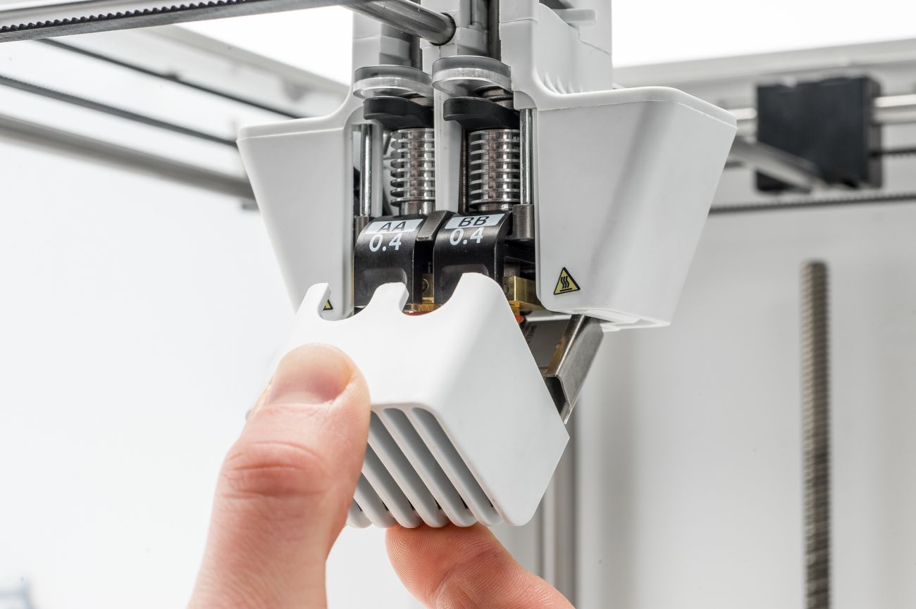

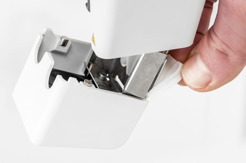

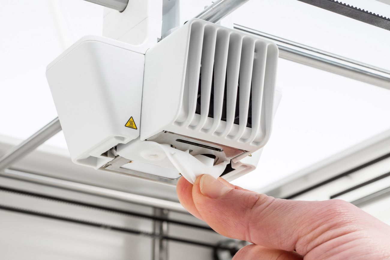

2. Remove old cover
Close the fan bracket again. From the underside of the print head, peel away the front corner of the nozzle cover, and pull it out of the fan bracket.

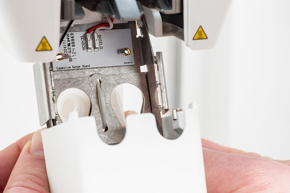

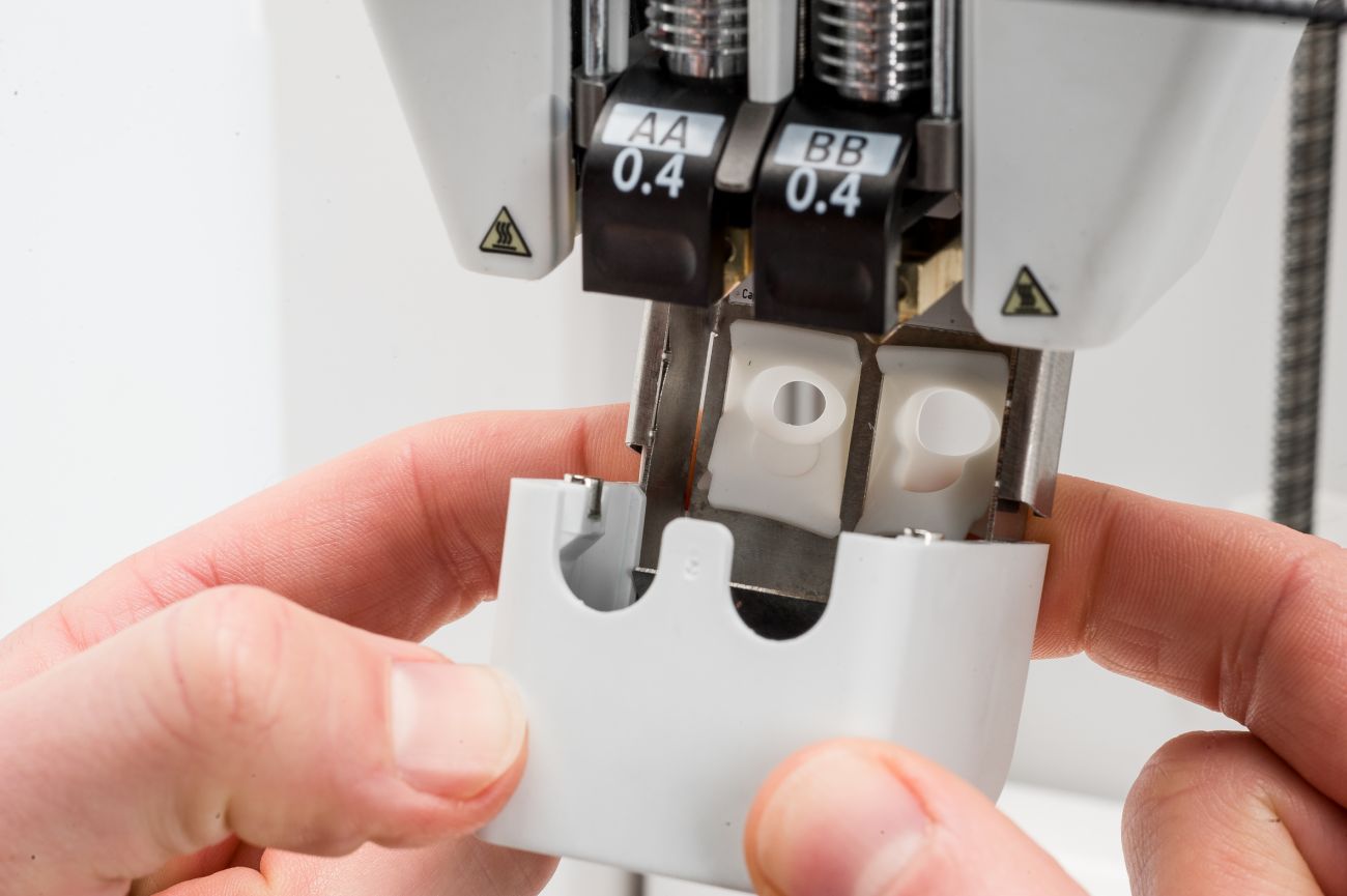

1. Orientation
Open the fan bracket and hold the new nozzle cover in the correct orientation behind the bracket. Ensure the shapes of the cover match the holes in the fan bracket.
2. Insert middle tab
From behind the fan bracket, slightly bend the nozzle cover and insert the middle tab through the slot in the fan bracket and metal plate.

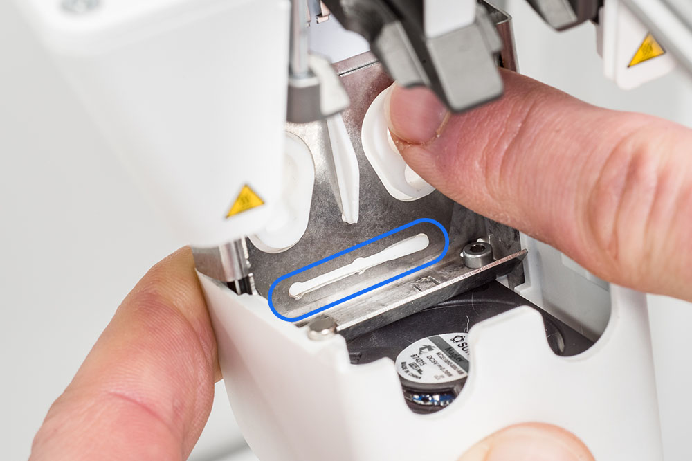

3. Seal middle tab
From the inside of the print head, apply pressure to the metal plate. At the same time, pull the tab through the bracket and plate until the seal locks the cover in place. You can use (round or flat-tipped) tweezers for this.

5. Front tab
From behind the bracket, push the front tab through the slot at the front, while applying pressure to the metal plate from the inside of the fan bracket. Make sure the seal is pushed completely through the plate, to lock the cover in place.

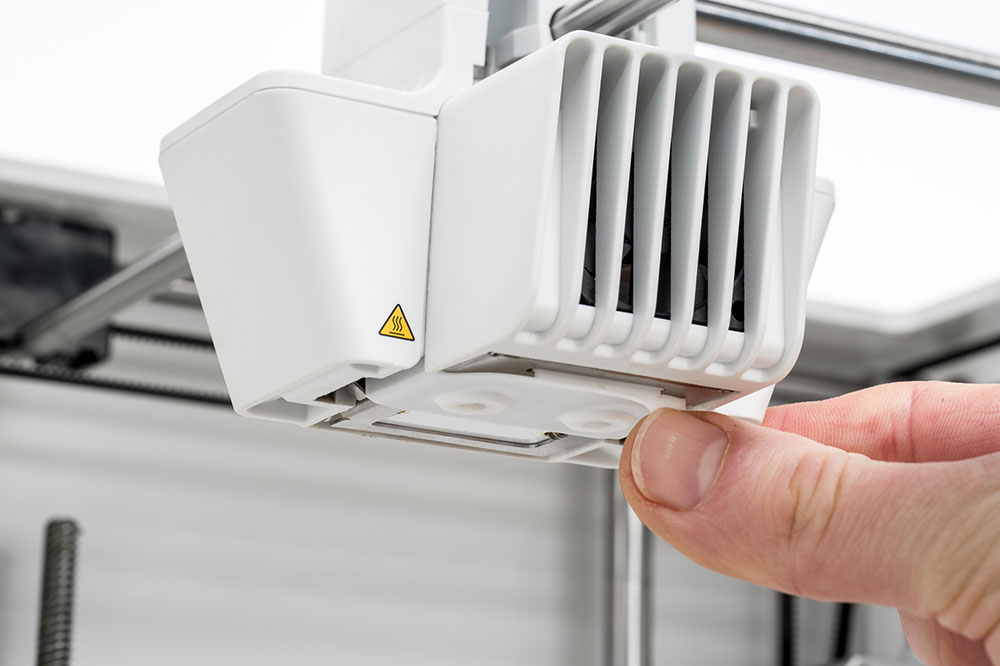

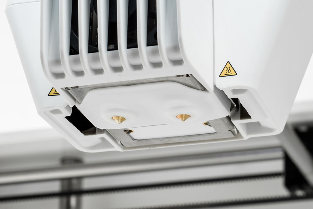

6. Check placement
Close the fan bracket and check if the new nozzle cover is correctly placed. Slide your finger across the bottom of the print head. If the nozzle cover easily detaches from the fan bracket, check the seals and redo steps 2-5.
7. Load print cores
Open the fan bracket and insert both print cores (see note below). In the Ultimaker 3 menu, go to Material/PrintCore → PrintCore [1/2] → Load.
