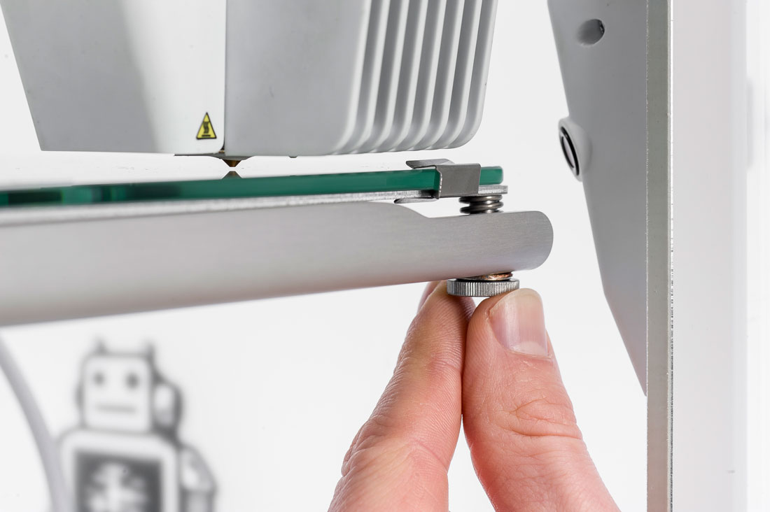

1. Rough leveling
In this part of the leveling process, set an approximate distance of 1 mm between the first nozzle and the build plate. Follow the instructions on the display:
  1. Wait for the UltiMaker 3 to perform its homing procedure and continue when the print head is in the center at the back end of the build plate.
  2. Rotate the button at the front until there is approximately a 1 mm distance between the first nozzle and the build plate. Make sure that the nozzle is close to the build plate without touching it. Confirm to continue.
  3. The print head will now move to the next position. Adjust the thumb wheel at the front to set approximately the same distance as in the back.
  4. Confirm to continue and repeat for the other side.

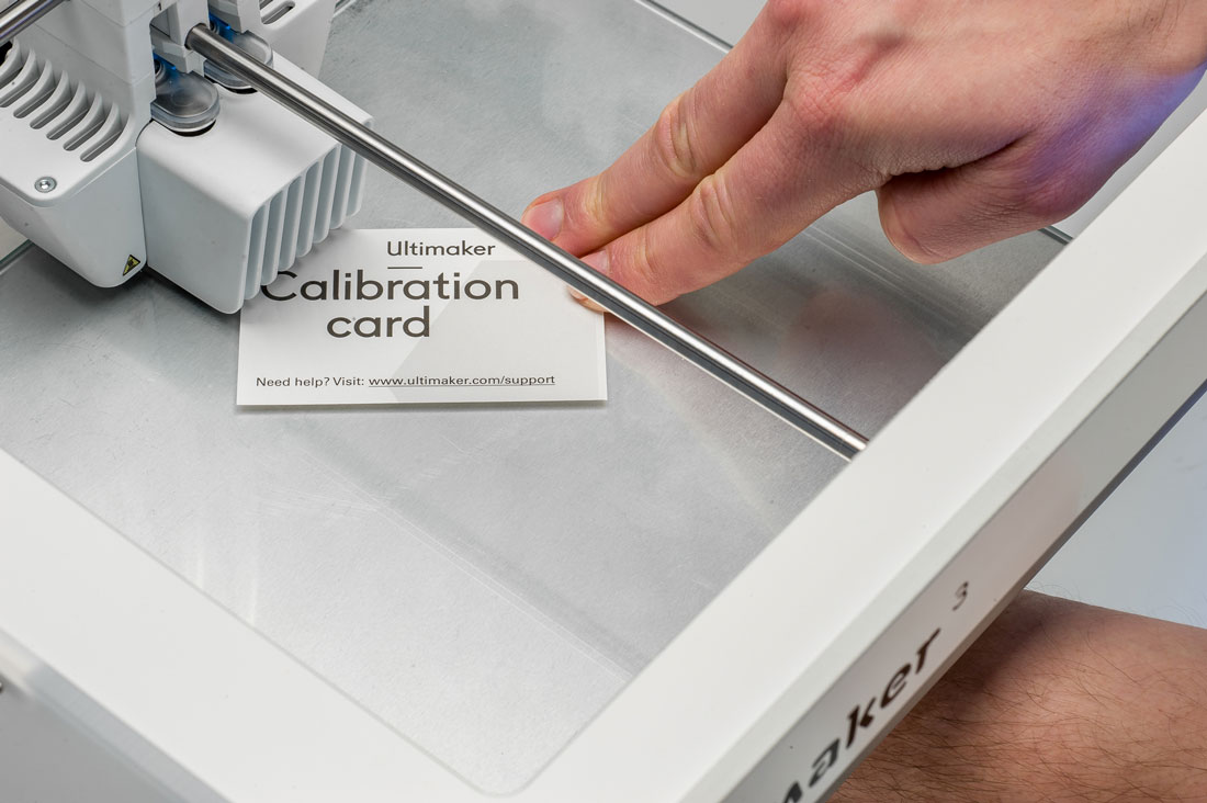

2. Fine-tuning
In the next step, fine-tune the position of the build plate using the calibration card. Follow the instructions on the display:
  1. Place the calibration card between the nozzle and the build plate when the print head is in the center at the back end of the build plate.
  2. Adjust the thumb wheel underneath the build plate at the back until you feel slight friction when moving the card.
  3. Confirm to continue and wait until the print head moves to the next position.
  4. Place the calibration card again and adjust the thumb wheel at the front until you feel the same resistance as in the first position.
  5. Confirm to continue and repeat step 4 for the third position.
Note: Do not push on the build plate while fine-tuning with the calibration card. This will lead to inaccuracies.

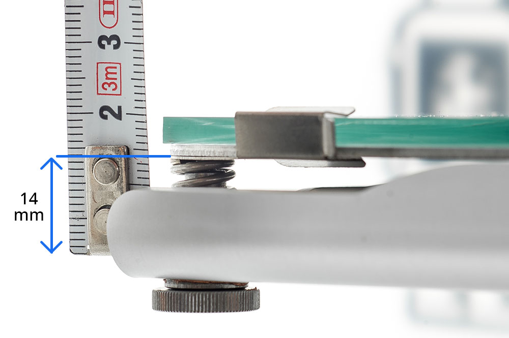

Factory position
After performing the manual leveling process multiple times, the springs under the build plate may have become too loose. This means that the build plate is too high, which could cause problems during active leveling.
Reset the position of the build plate to the factory position. To do so, use a spacer tool or a ruler. Adjust the three thumb wheels under the build plate until there is a distance of 14 mm between the bottom of the heated bed and the top of the base plate. After this, run through the manual leveling process once more.
