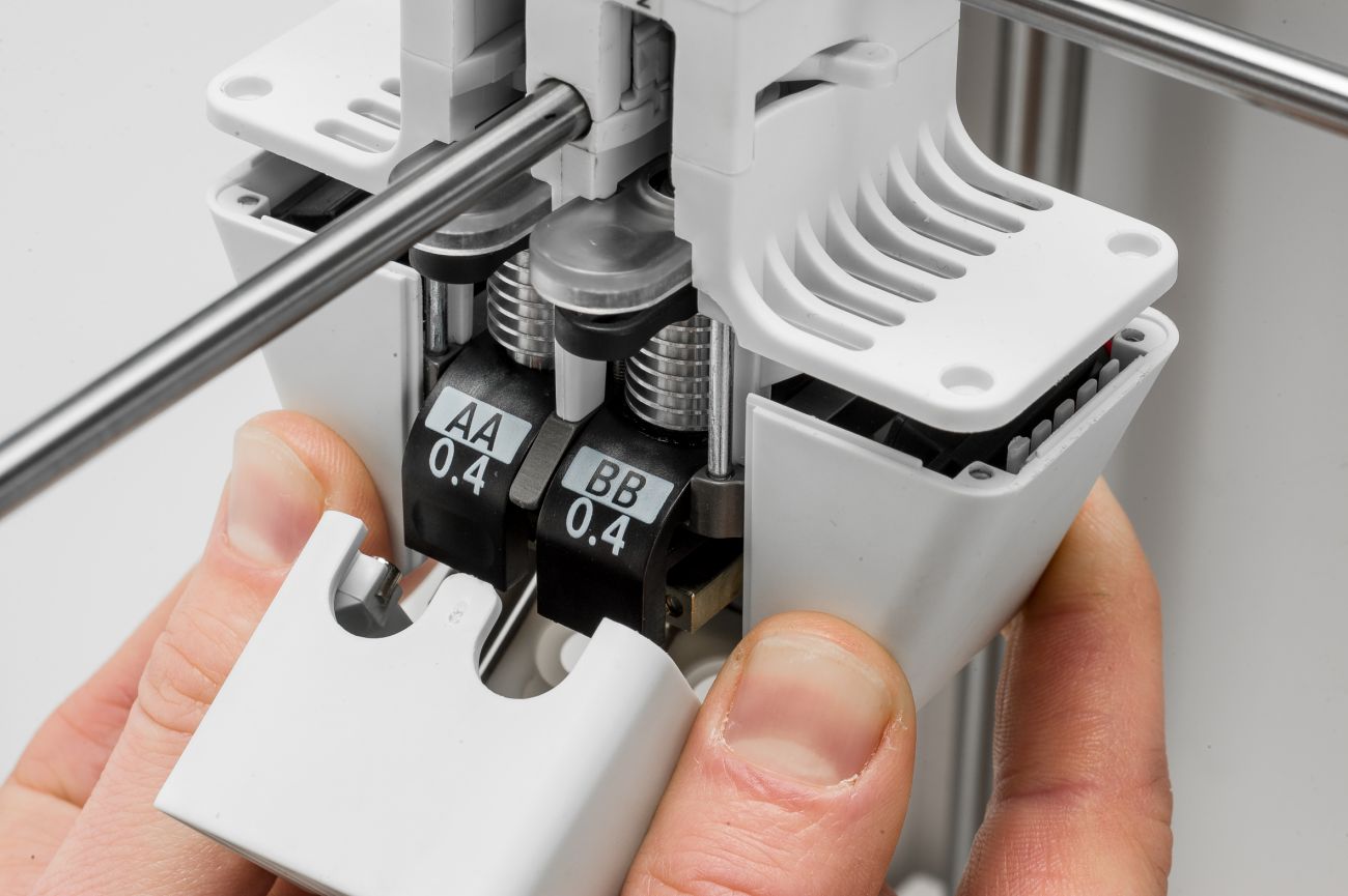

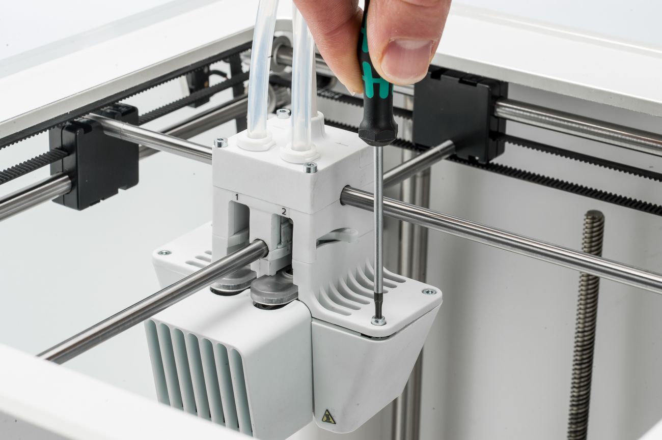

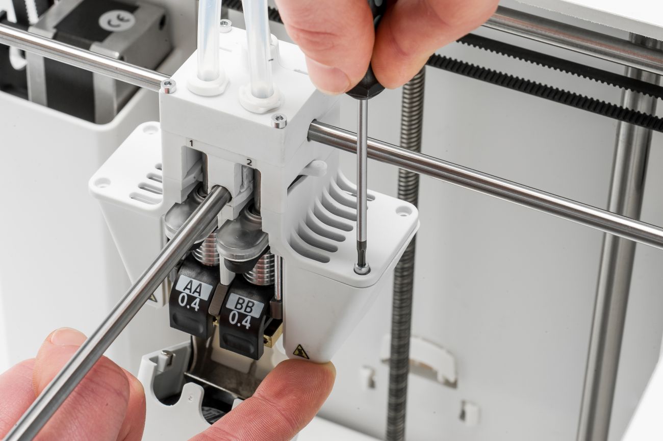

1. Loosen the side fan bracket
Place the print head in the middle of the printer for easier access. Use the Hex 2 screwdriver to remove the four screws that hold the side fan bracket.

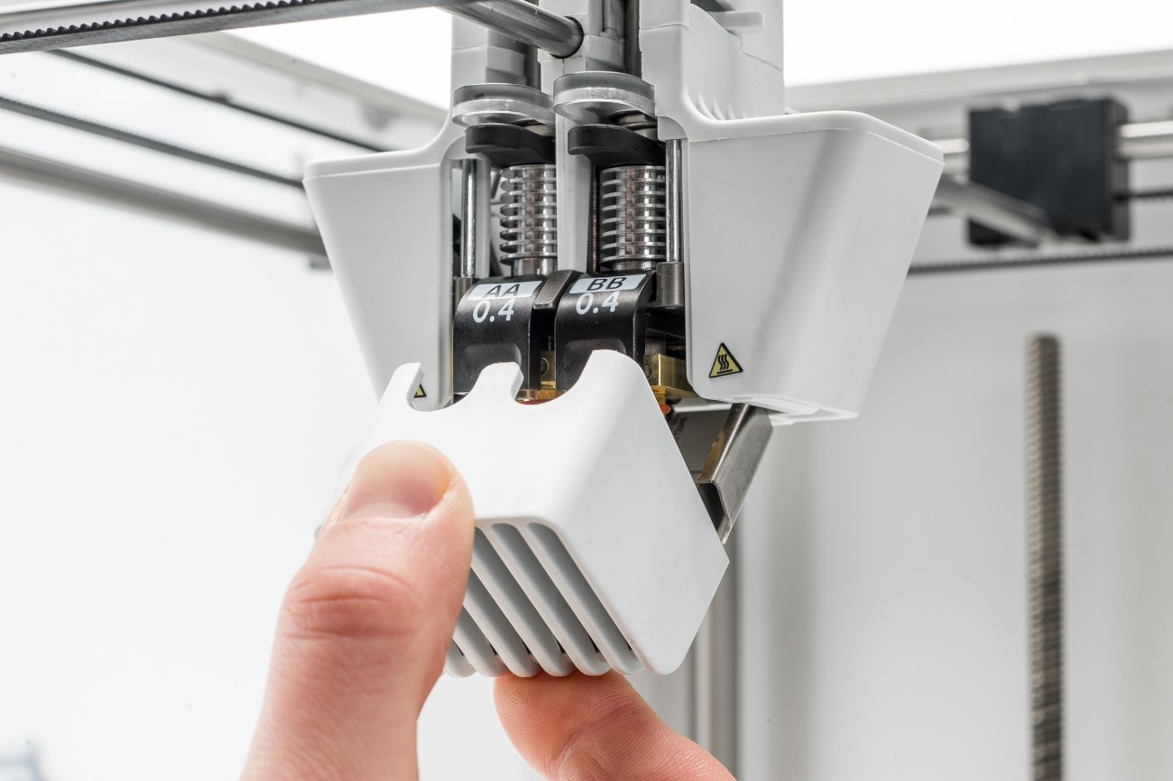

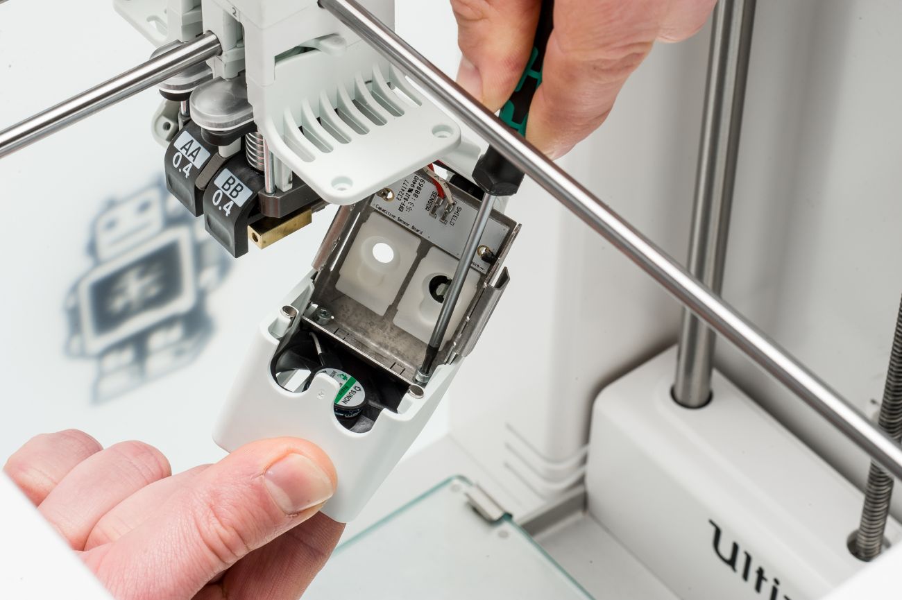

2. Move the fan bracket down
Slightly open the front fan bracket and move the front and side fan bracket assemblies down to create some room.

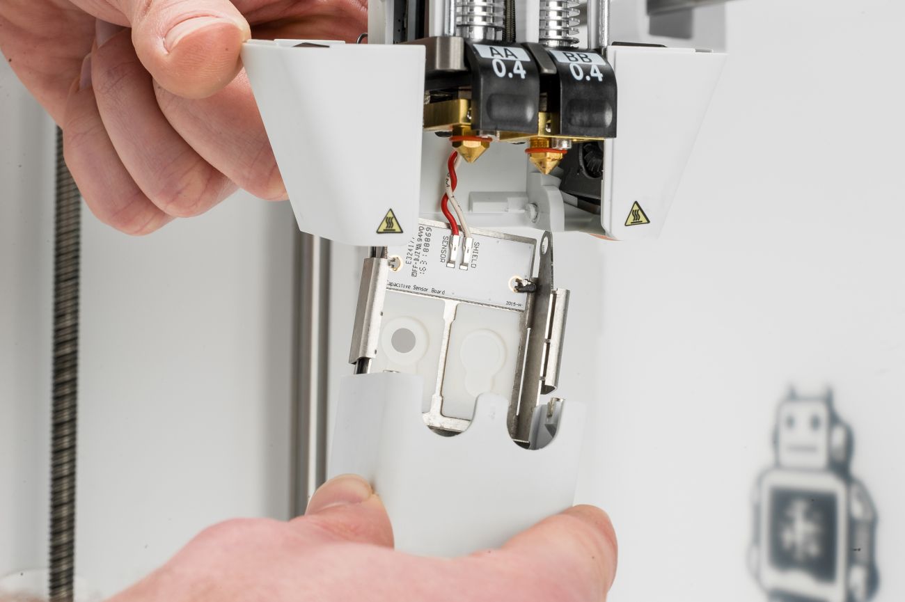

3. Loosen the front fan bracket
Slightly bend the side fan bracket open. Loosen the front fan bracket by dislodging the holes in the front fan bracket from the tabs in the side fan bracket.

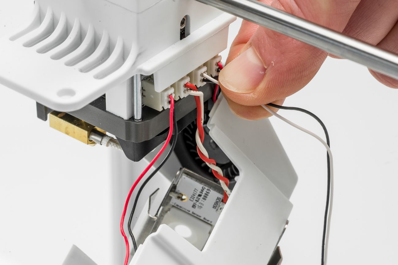

Disconnect the axial fan at the back of the print head. The front fan has black and white wires and is connected to the second connector from the right (as seen from the back).

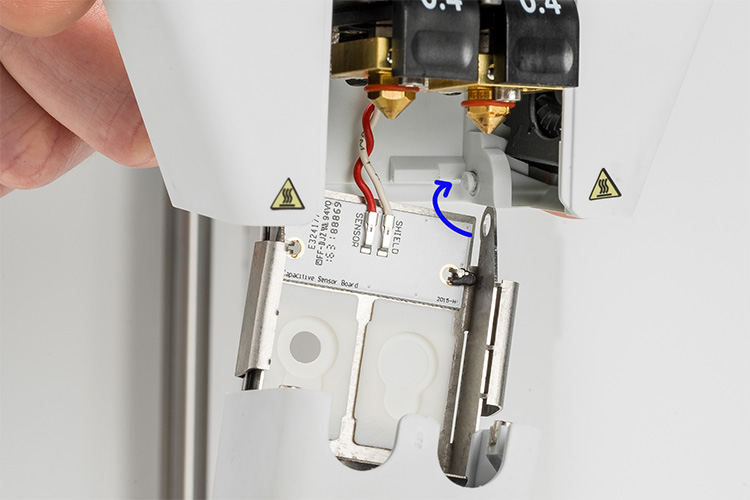

Note: For the UltiMaker S3 and S5, as well as for the UltiMaker 3 print head with the transparent nozzle cover, it may be easier to remove the complete front bracket from the print head. This is because of how the fan wire is secured (see note below). Also disconnect the capacitive sensor wire (red/white) from the second connector from the left (as seen from the back).

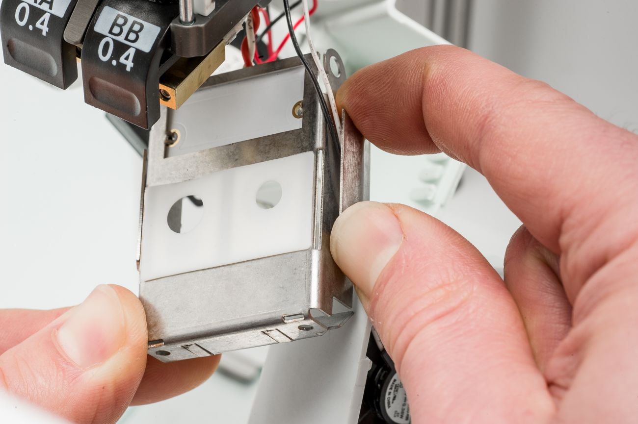

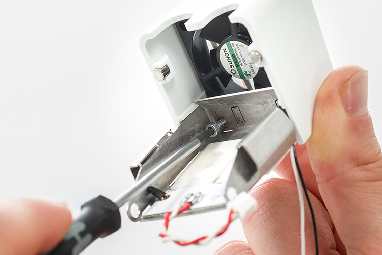

5. Loosen the front fan cover
Put the side fan bracket out of the way. Use the Hex 2 screwdriver to remove the two screws that secure the metal bracket to the plastic front cover.

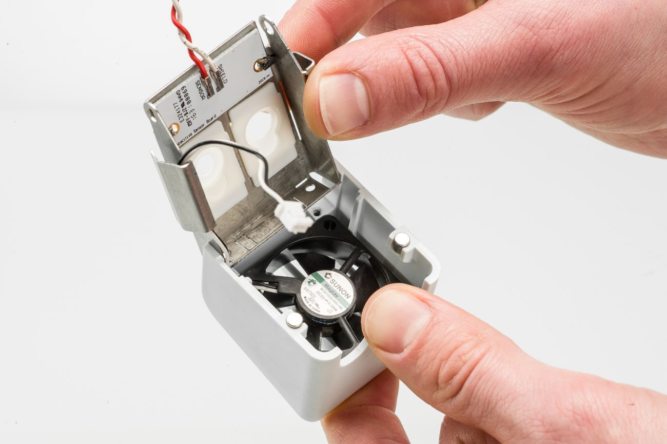

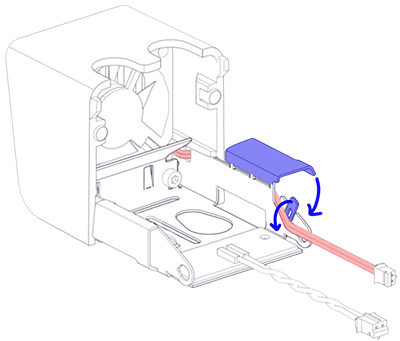

6. Remove the fan from the cover*
Carefully bend open the metal tab that covers the fan wires (open it only slightly). Move the fan wires out from underneath the tab and take the fan out of the cover.
Note: The images above show the (older) UltiMaker 3. The fan brackets for the newer UltiMaker 3 print head and S series are slightly different.
The front fan wire is secured under the side tab (similar to the photo above), as well as a smaller tab on the inside of the fan bracket.
Gently fold open both metal tabs, only as far as is needed to remove the wire. Use pliers, if needed, to open the small tab, and be extra careful not to damage the shrink sleeve that is around this smaller tab.

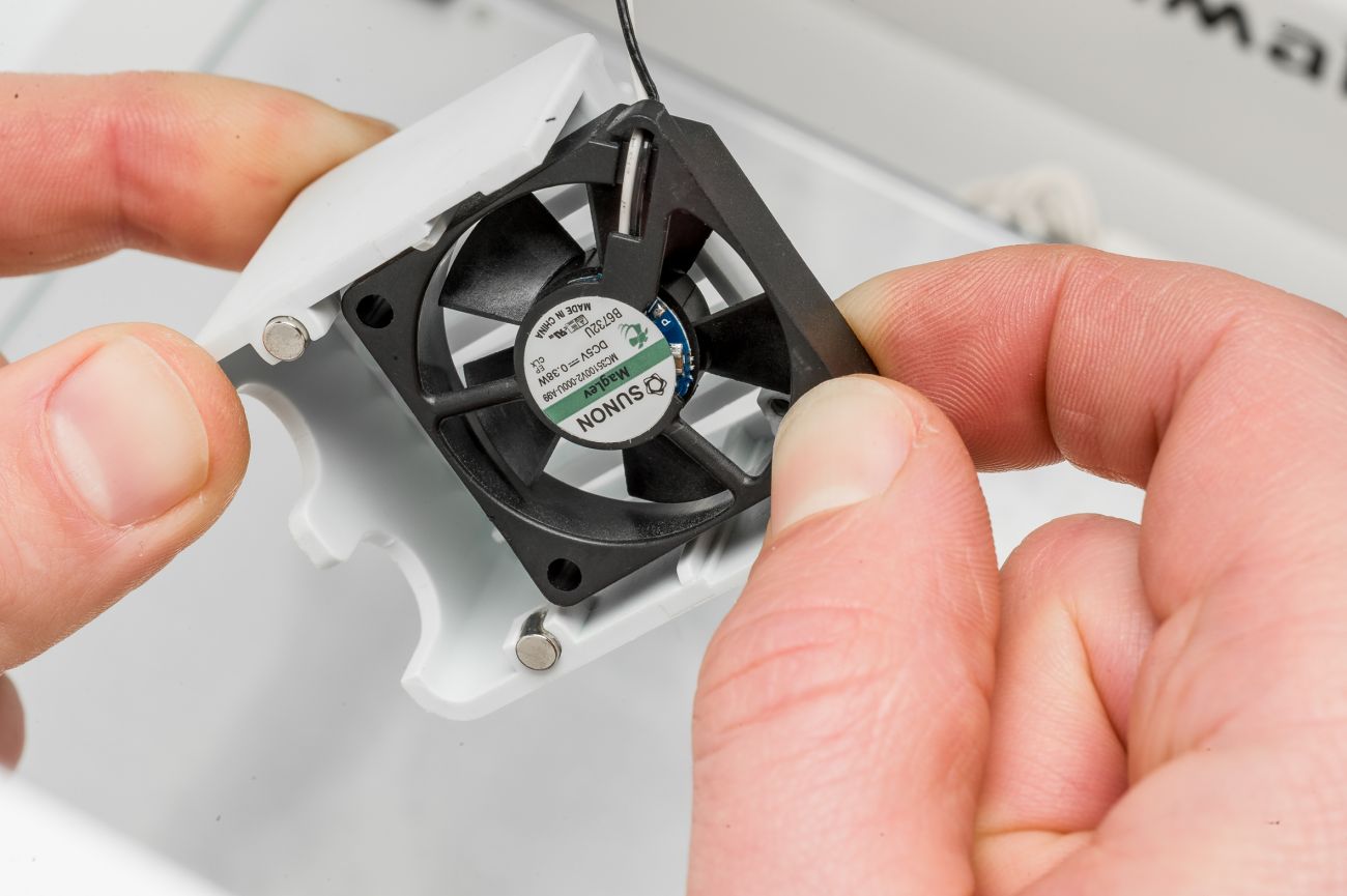

Tip: To install the fan in the original orientation, the sticker faces toward the inside of the print head. This way, the fan takes in air from the front and blows it at the print cores. To extend the fan's lifespan, you can also install it in the reverse orientation (sticker on the grille side). This way, the fan pulls air through the print head and blows it out the front. This still cools the print cores, but reduces the chance of filament strands getting stuck in the fan.
1. Place the fan in the fan cover
Take the new fan and place it in the front fan cover. See the orientation note above. Ensure that the wire is on the left side (as shown), and that the fan sits completely flat in the cover.

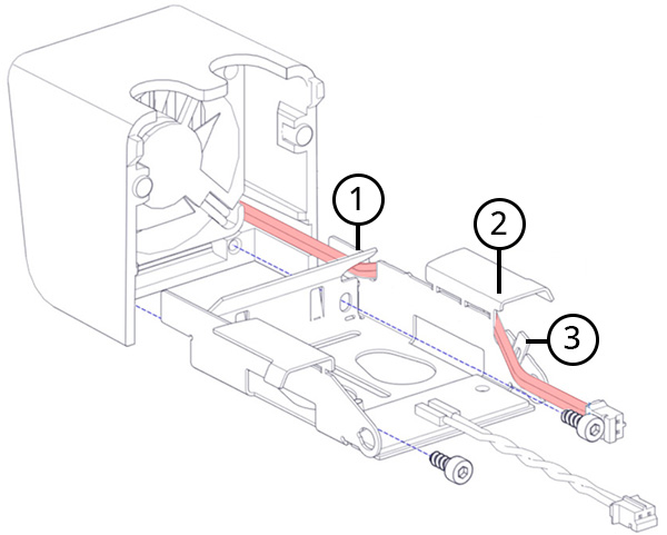

2. Align the cover and bracket*
Bring the front cover with the fan and the metal bracket together. For the (older) UltiMaker 3, guide the fan wires on the outside (left) of the metal bracket, underneath the tab. For the newer UltiMaker 3 and S series print heads, see below.
Fan wiring note:
For newer style UltiMaker 3 print heads (with transparent nozzle cover) and for S-line printers, pay special attention to the cable routing for the axial fan. The front fan bracket and the cable routing are slightly different.
  1. Make sure the fan's wires go on the inside of the tab closest to the fan, then through the opening.
  2. Guide the fan's wires through the tab at the side and press it shut.
  3. Secure the wire under the small tab next to the capacitive sensor board. This should have a small shrink sleeve around it to protect the wires.

5. Attach the front to the side bracket
Slightly bend the side fan bracket open. Align the holes in the front fan bracket with the tabs in the side fan bracket and click it in place.

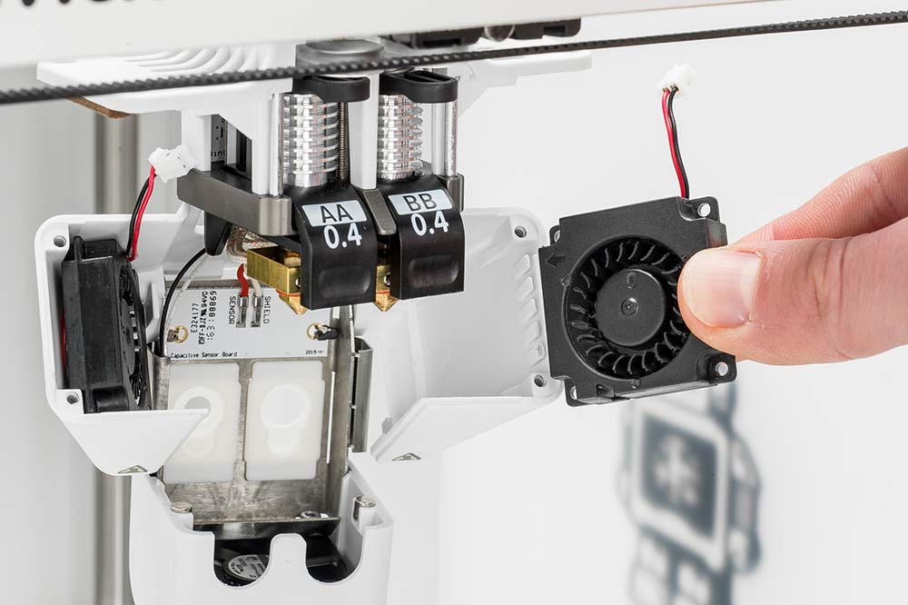

6. Check / place the side fans
Ensure that the side fans are still correctly placed in the side fan bracket. If they have come out, place them back with the excess wire looped at the back. The fan should face to the inside of the print head, and the open side must be at the bottom (note the small arrow).
