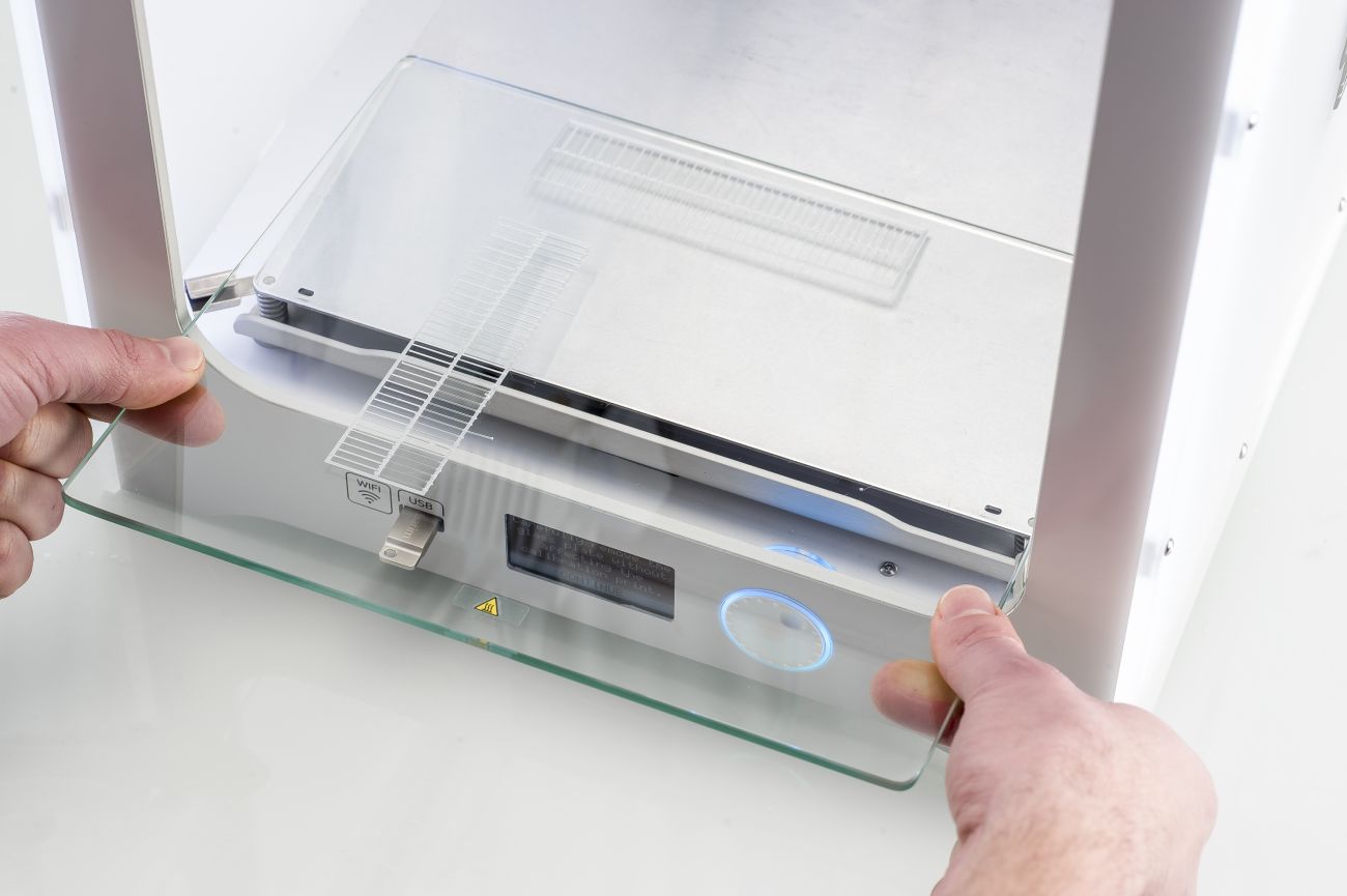

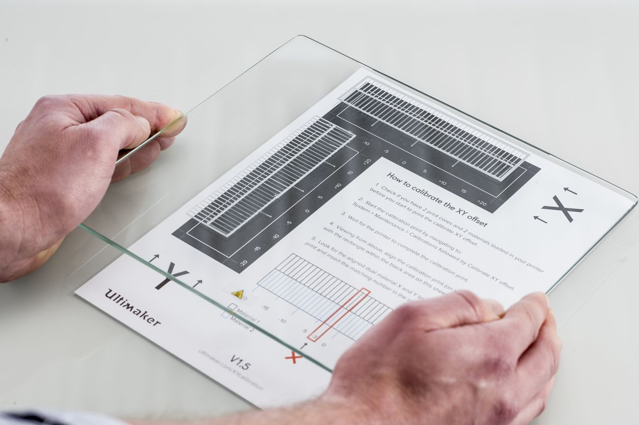

Align the gridOnce the UltiMaker 3 has cooled down, remove the glass plate from the printer and place it on the XY calibration sheet. Ensure the printed grid is exactly placed on the two rectangles on the sheet.
Find the X offsetIn the X grid, find the two lines that align best. On the calibration sheet, check which number belongs to these lines. Use the button to enter this number in the UltiMaker 3 as the X offset value.
Find the Y offsetIn the Y grid, find the two lines that align best. On the calibration sheet, check which number belongs to these lines. Use the button to enter this number in the UltiMaker 3 as the Y offset value.

Carefully remove the glass plate
Align the grid with the XY calibration sheet
