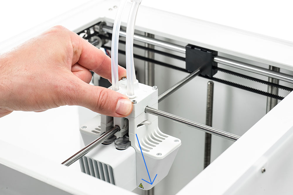

1. Move the print head
Manually place the print head in the front-right corner.
Tip: This is only for easier access to the print head clamp clip. Not required when replacing the feeder's clamp clip.

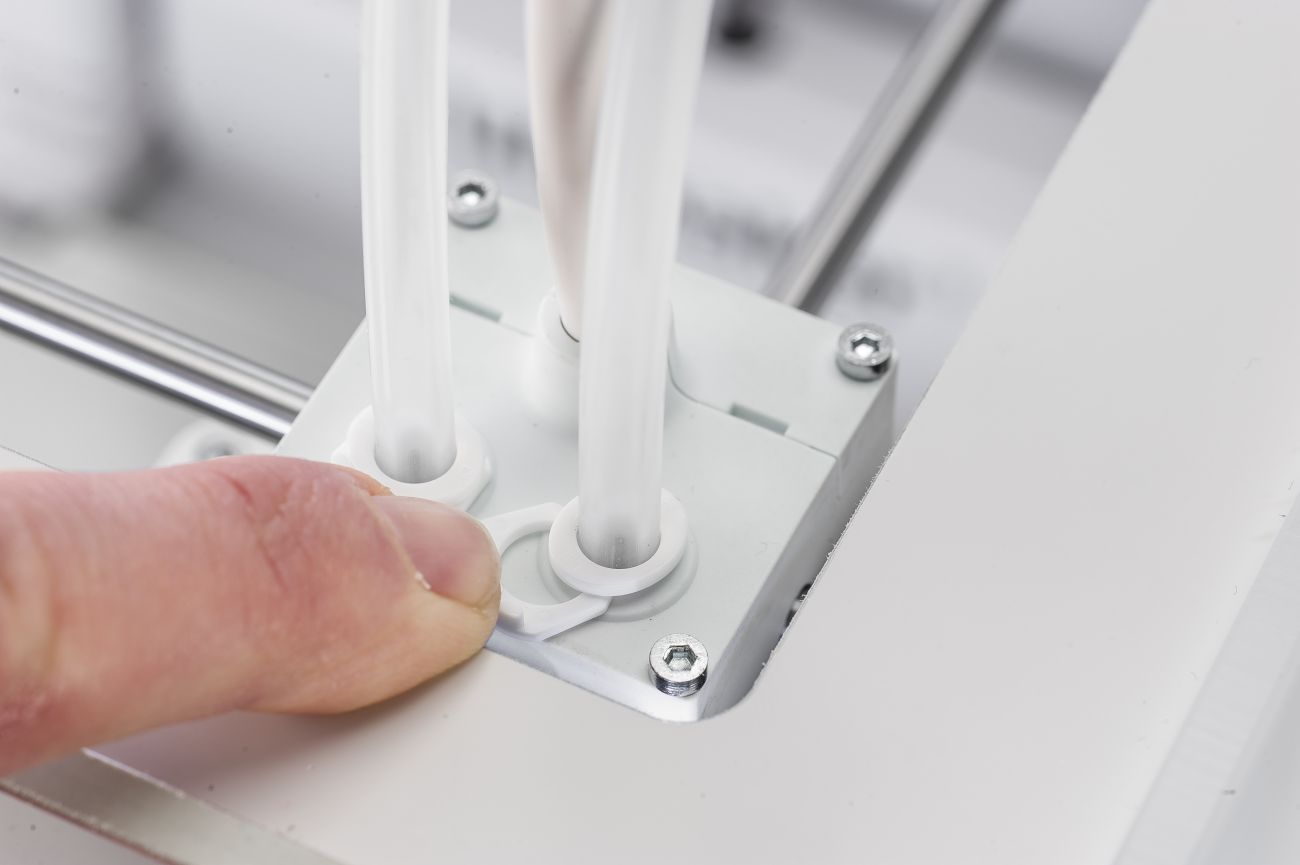

2. Remove the clip
Use your fingernail to remove the old clamp clip from the print head or feeder.

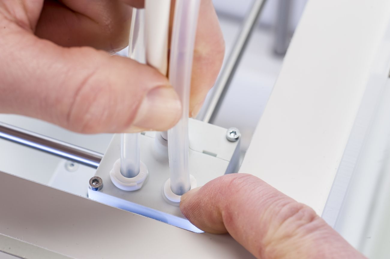

1. Insert the Bowden tube
Make sure the Bowden tube is still fully inserted into the tube coupling collet. Firmly push the tube into the feeder or print head, while keeping the tube coupling collet down.

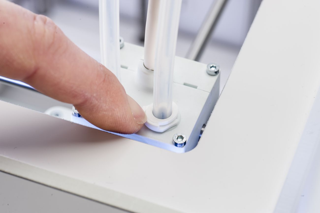

2. Place the new clip
Keep the Bowden tube in position and place the new clamp clip around the tube coupling collet to lock the Bowden tube in place.
