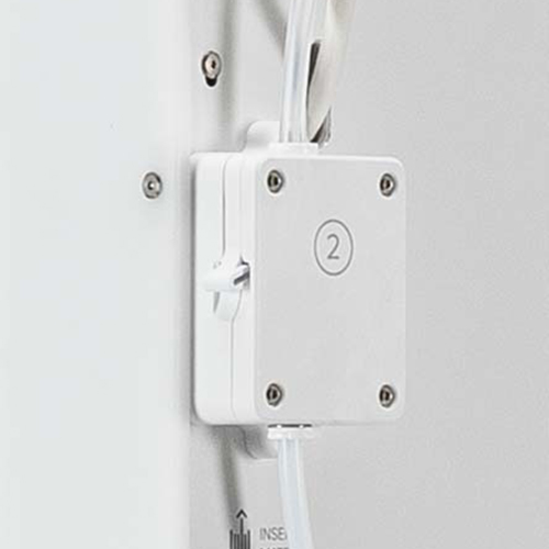

Check the feeder lever
Make sure that the lever of the indicated feeder is fully down. If the feeder lever is left (partially) up, it will not give sufficient pressure on the filament while feeding.

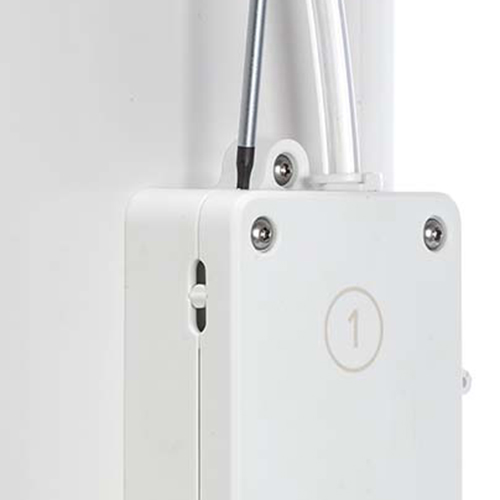

For UltiMaker materials, the feeder tension should be at the middle mark. If the tension is too high, the feeder may flatten the filament, but if the tension is too low, the material can slip inside the feeder.
Use a 2 mm hex key or screwdriver to turn the bolt at the top of the feeder housing to adjust the feeder tension.

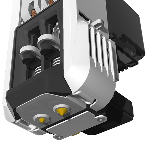

Check the nozzle cover
Printing without a nozzle cover, or with a worn / damaged one, can negatively affect the extrusion. One of the functions of the nozzle cover is to shield the print cores from the cold airflow of the fans during printing. Printing with a missing or damaged cover can cause temperature fluctuations in the print cores, possibly leading to under-extrusion and the ER65 error message.
If the nozzle cover is missing or damaged, install a new one. Find instructions in this article. This can be done during the paused state, although it is better to check this before starting a print.
Tip: Regularly check the nozzle cover according to the maintenance schedule to prevent problems during printing.

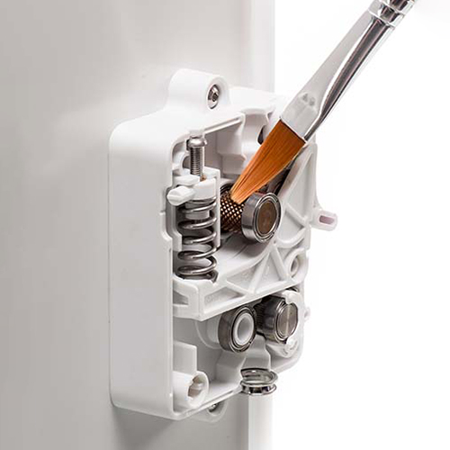

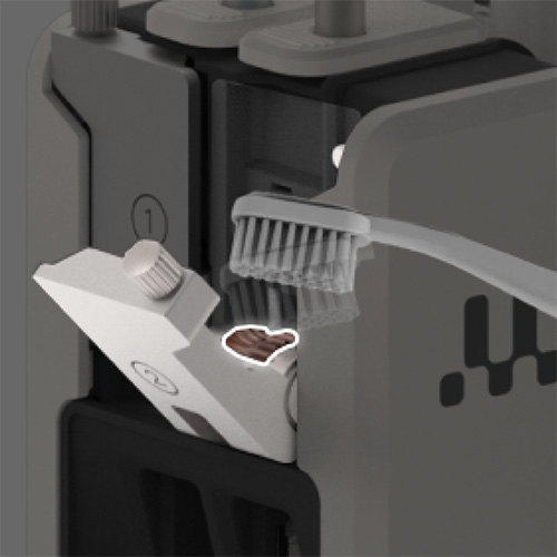

Dirty feeder
After many hours of printing, or when the material has been ground down, there is a chance that there are small filament particles in the feeders. Cleaning the inside of the feeders is recommended once every three months (or 300–500 operating hours).
Carefully remove the front of the feeder and brush away any filament particles or obstructions according to the cleaning instructions.

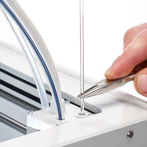

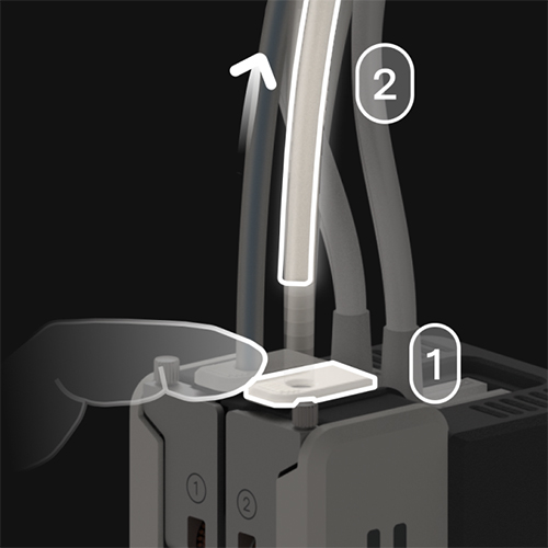

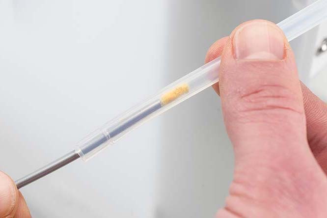

Obstructed Bowden tube
Filament strands or particles inside the Bowden tube can prevent the material from passing through smoothly. This extra friction can cause reduced extrusion. Clean the Bowden tube according to the instructions.
Cleaning the Bowden tubes is recommended every month (or 100–200 operating hours).
Additionally, check for scratches and signs of damage on the inside of the tubes. If any damage is observed, it is recommended to replace the Bowden tube(s).

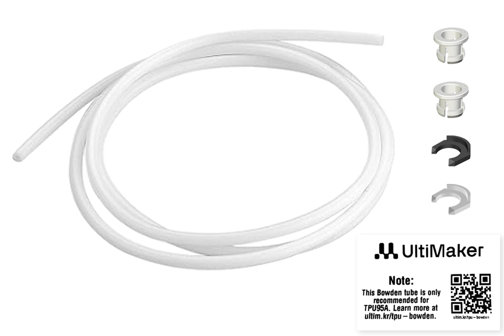

TPU 95A
The ER65 errors are more common when printing with TPU 95A on S series printers. A special PTFE Bowden tube is made available, for use specifically with TPU 95A. replace the Bowden tube for this PTFE version for reduced friction on the filament.
Learn more here.
Tip: The filament path of the Material Station could also be obstructed with filament. For step-by-step instructions (including photos) on how to remove the broken PVA from the system, read the troubleshooting guide on this page

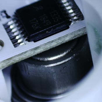

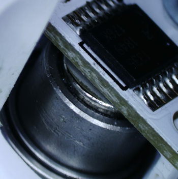

Check the rotating magnets of the feeder
The flow sensor has a rotating magnet. The rotations of this magnet are read by the connected PCB and the material flow is calculated in this way. A correct alignment of the magnets is important for a correct reading by the PCB.
In the following pictures, you can see the magnet up close. The aligned magnet on the left picture is in the correct position. In the right picture, the magnet is not fully level. This is causing it to interfere with the PCB, and therefore with the flow sensor readings:
Feeder 2. Magnet is correctly aligned
Feeder 1. Magnet sticks out and is pressed against the PCB.
If your flow sensor is affected by this, please contact support and provide supporting images. A support representative will help you restore full functionality.

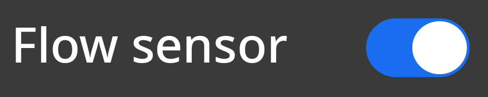

Disable the flow sensors
It is possible to disable the flow sensors. This can be a useful temporary patch, especially if the print shows no signs of under-extrusion. Open the Options menu (gear icon) and toggle the switch for Flow sensor to turn them off.
Note that in the standalone S series printers (without a Material Station), this will also disable the end of filament detection, whereas in the Pro Bundle, the end of filament will still be detected by the Material Station. It is still recommended to determine the root cause of the ER65 error, because under-extrusion will no longer be detected with the flow sensors disabled.

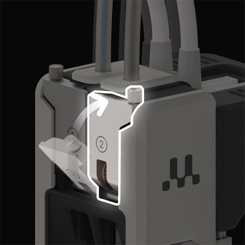

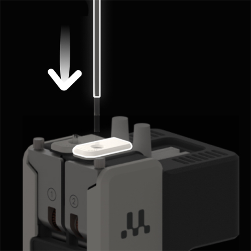

Check the feeder latches
Ensure that the metal feeder latches are fully and correctly closed. If they are open, not secured, or misaligned, there will not be sufficient pressure on the filament.
Turn the small thumb screw at the top of the latch to open it, then press it closed again. Ensure that it is properly aligned and secure the by turning the thumb screw.

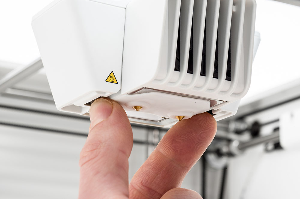

Dirty feeder
