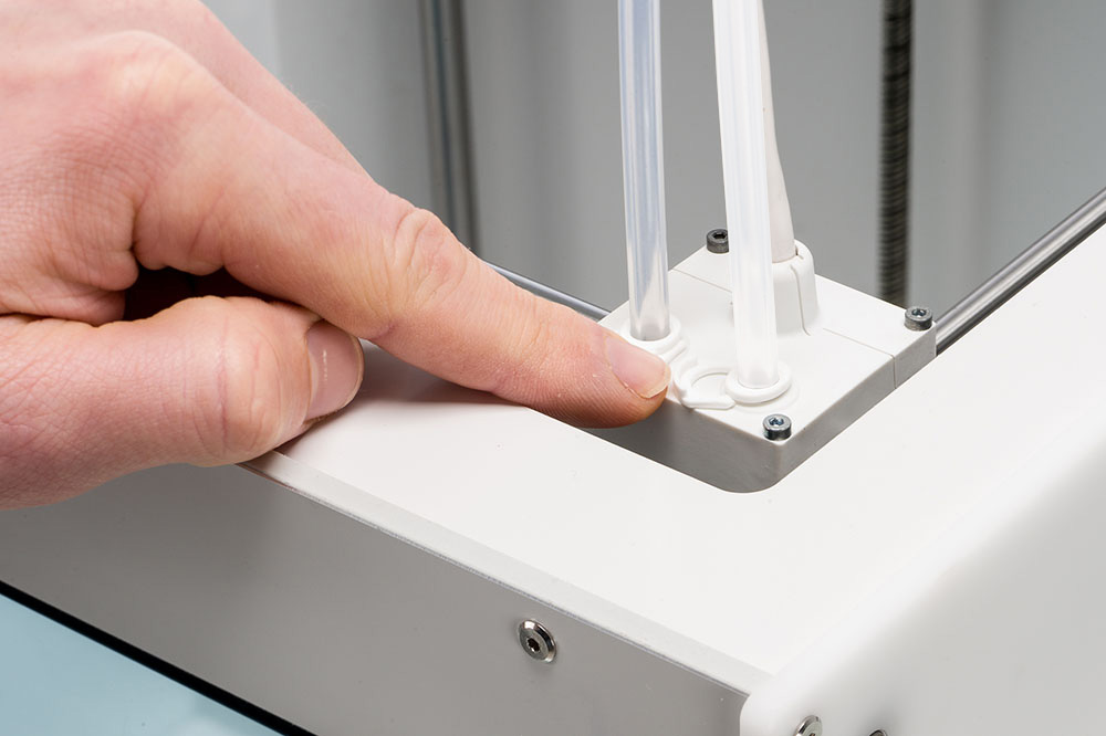

1. Loosen cable clips
When replacing Bowden tube 2, loosen the tube from the print head cable clips. On the S7 and S8, Bowden tube 1 is also connected with a cable clip.

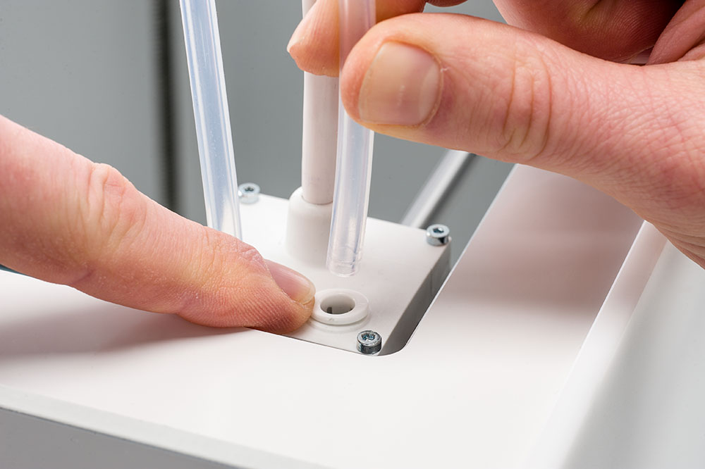

2. Remove clamp clips
Remove the clamp clips from the feeder and print head.
3. Remove Bowden tube
While pushing down the tube coupling collet, pull the Bowden tube out of the print head. Repeat for the feeder.

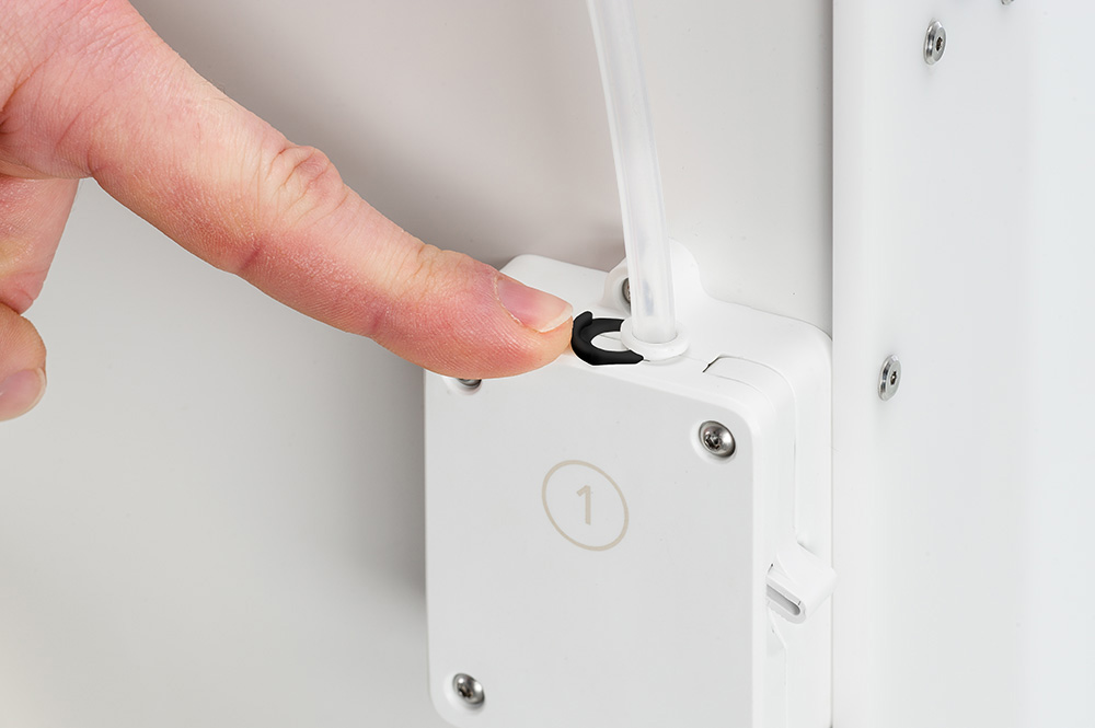

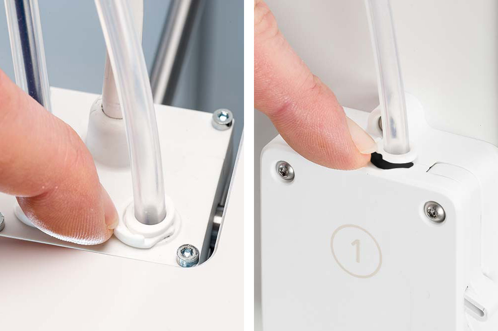

Push one end of the Bowden tube into the collet in the print head. Secure with a white clamp clip.
5. Insert into feeder
Push the other end into the feeder collet. For printers with an Air Manager, move the tube through the Bowden cover or mounting bracket. Secure with a black clamp clip.

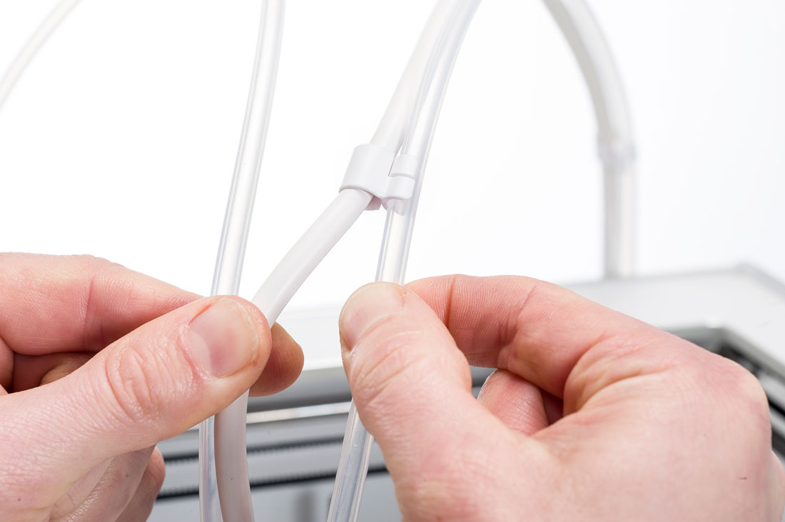

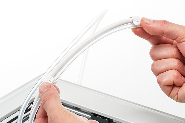

6. Place cable clips
For Bowden tube 2, click the cable clips onto the tube and space them evenly. For the S7 and S8, Bowden 1 is connected with one clip, about 15 cm above the print head.
