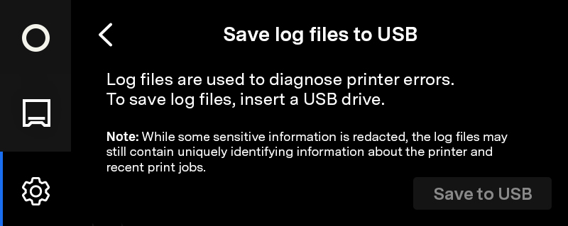

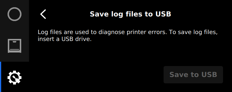

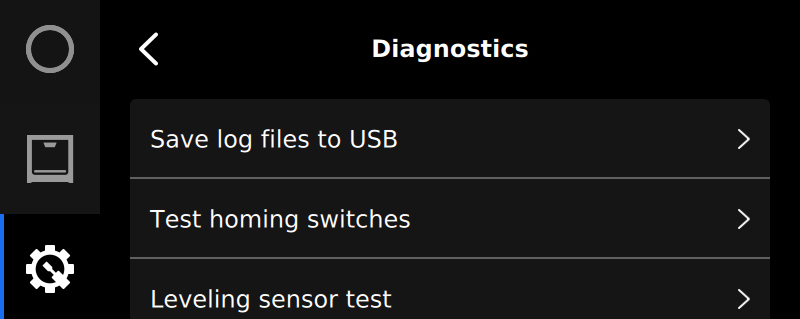

Factor 4
From the Options menu (gear icon), go to Maintenance → Diagnostics, then select Save log files to USB.
Note: Exporting the logs may take up to a few minutes to complete. Do not remove the USB drive until the export is completed.

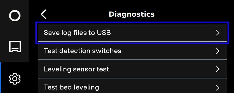

UltiMaker S series

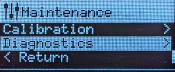

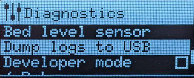

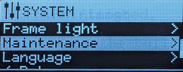

UltiMaker 3
On the display, navigate to: SYSTEM → Maintenance → Diagnostics, then select Dump logs to USB.

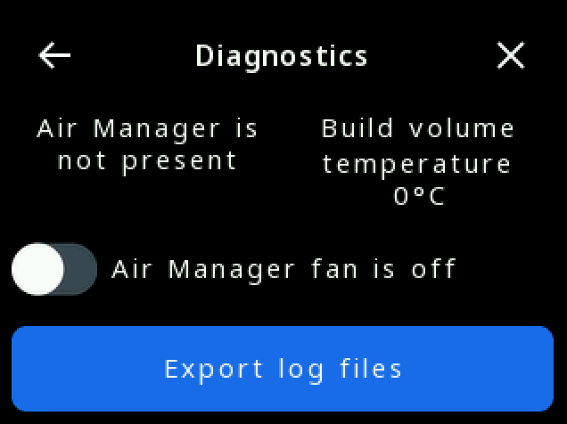

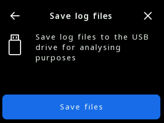

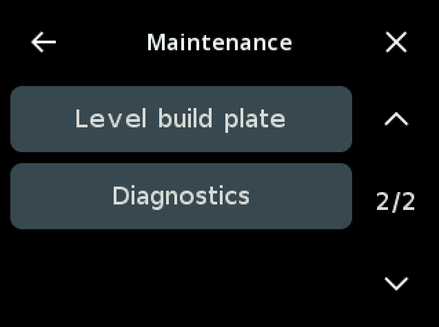

UltiMaker 2+ Connect
Select the Maintenance icon, scroll down to Diagnostics, and press Export log files.

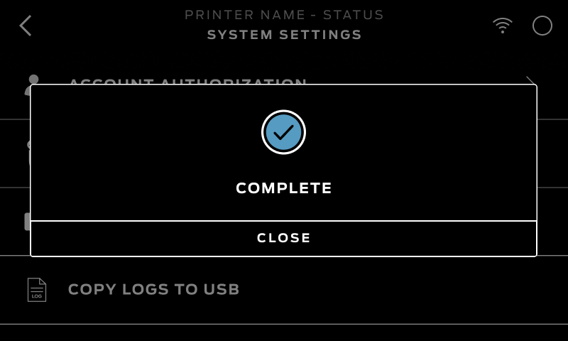

Method / Method X / Method XL
Select Advanced Settings, scroll down to Copy logs to USB.

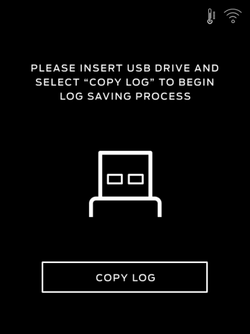

Sketch / Sketch Large
Select Settings, Select Utilities Go to page 4 - Select Copy Logs, Select Copy Log.
