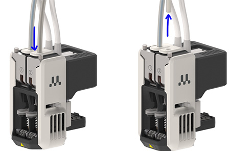

At least once a year, carefully check the quality of the Bowden tubes. Take the following steps:
  1. Press the collet release clip at the top of the print head.
  2. While applying pressure, pull the Bowden tube up and out of the print head.
  3. Carefully inspect the tube:
    • The outer surface must not be excessively scratched.
    • The exit of the tube must be smooth, not frayed or damaged.
    • The inside of the tube must not contain material particles from grinding.
Do this for both of the print head Bowden tubes.
