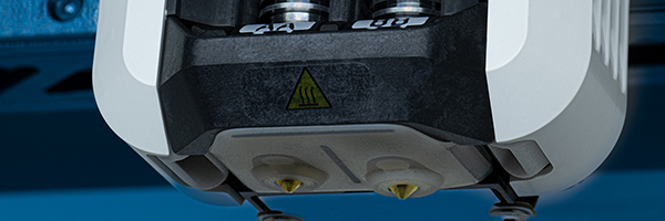

Examine the bottom of the print head to see if the holes where the nozzles come through are still round and if the cover still forms a good seal. Also gently open the fan bracket to check the other side of the silicone nozzle cover. If the nozzle cover looks burnt, frayed, or damaged, it is recommended to replace it. Follow the instructions below.

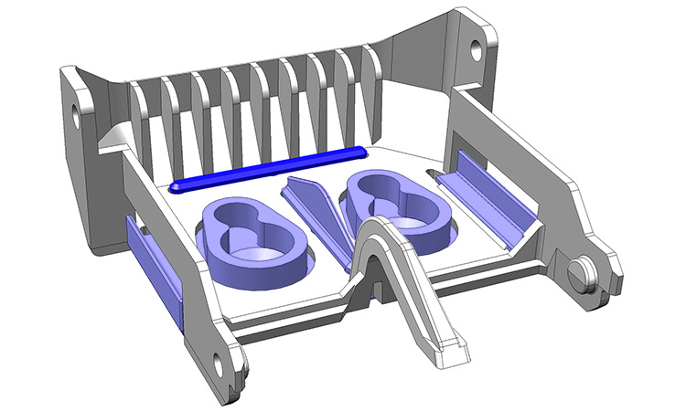

To install the replacement cover, first ensure you hold it in the correct orientation below the bracket. The cover contains two sealing tabs and 'pockets' at the side to hold it in place. Take the following steps to install it correctly:
F4-Nozzle-cover-1middletab.jpgF4-Nozzle-cover-2sidepockets.jpgF4-Nozzle-cover-3fronttab.jpg
1. Middle tab
Insert the middle tab of the cover through the slot in the bracket, ensuring that the thicker part (seal) is fully pushed through.

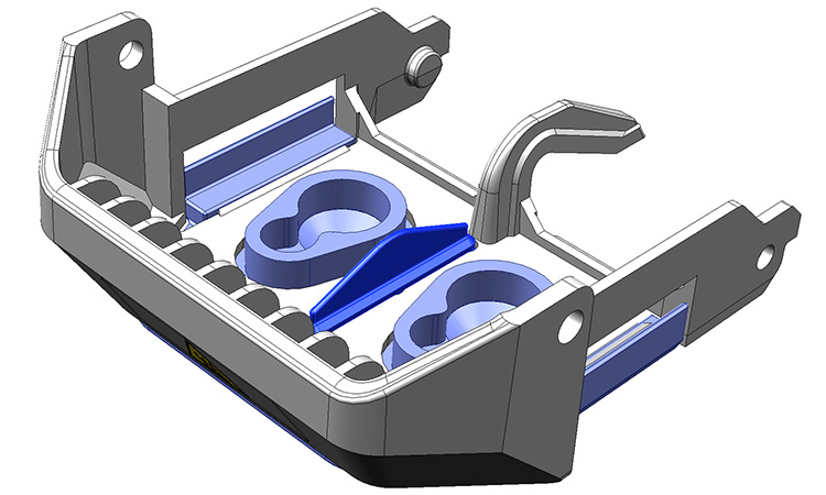

2. Side pockets
Fold the left and right sides of the cover over the edges of the bracket.

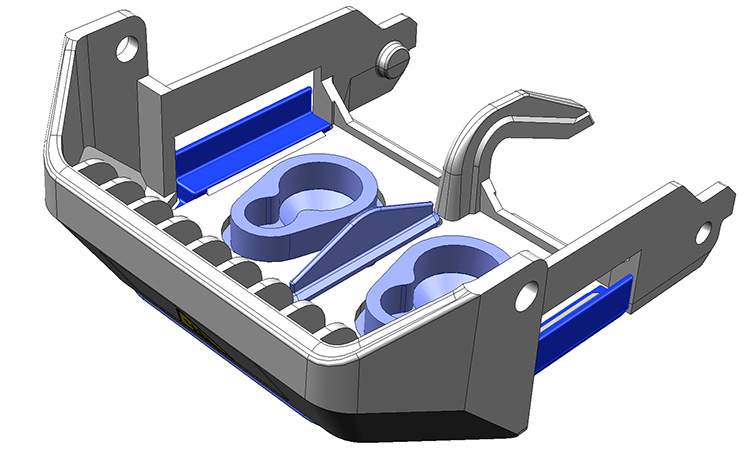

3. Front tab
Push the tab at the front of the nozzle cover through the slot in the bracket and ensure that the seal locks it in place.
When the nozzle cover is placed on the bracket, inspect it to make sure that the tabs and pockets are secure. If so, reinstall the cover bracket on the print head. Click the tabs at the back into the print head frame, and close the bracket.
