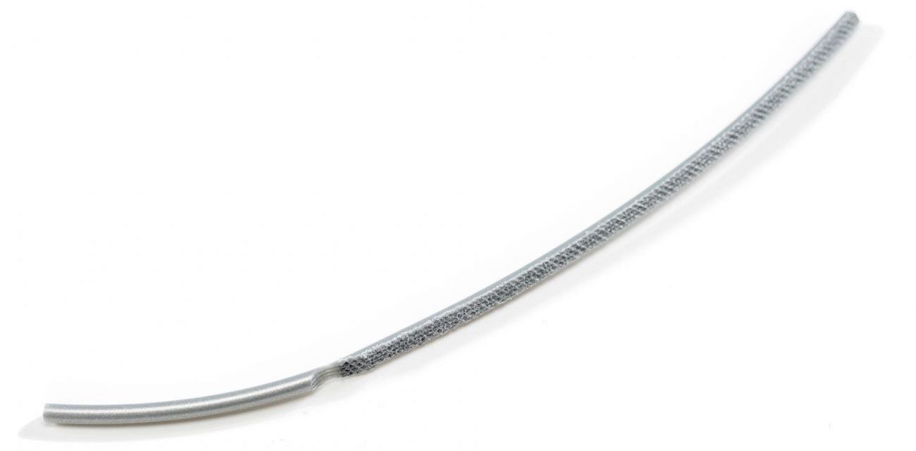

Grinding is when the knurled wheel of the feeder flattens and digs into the material instead of forwarding it reliably. This will lead to extrusion issues and tends to get worse if left unattended. The material particles can end up in the Bowden tube(s) or hot end, which can continue to cause extrusion problems even after removing the damaged material from the printer.
If you notice or suspect grinding problems, stop the print, unload the material, and clean the printer before continuing to print. Follow the tips on this page to resolve the grinding issues and learn how to prevent this in the future.

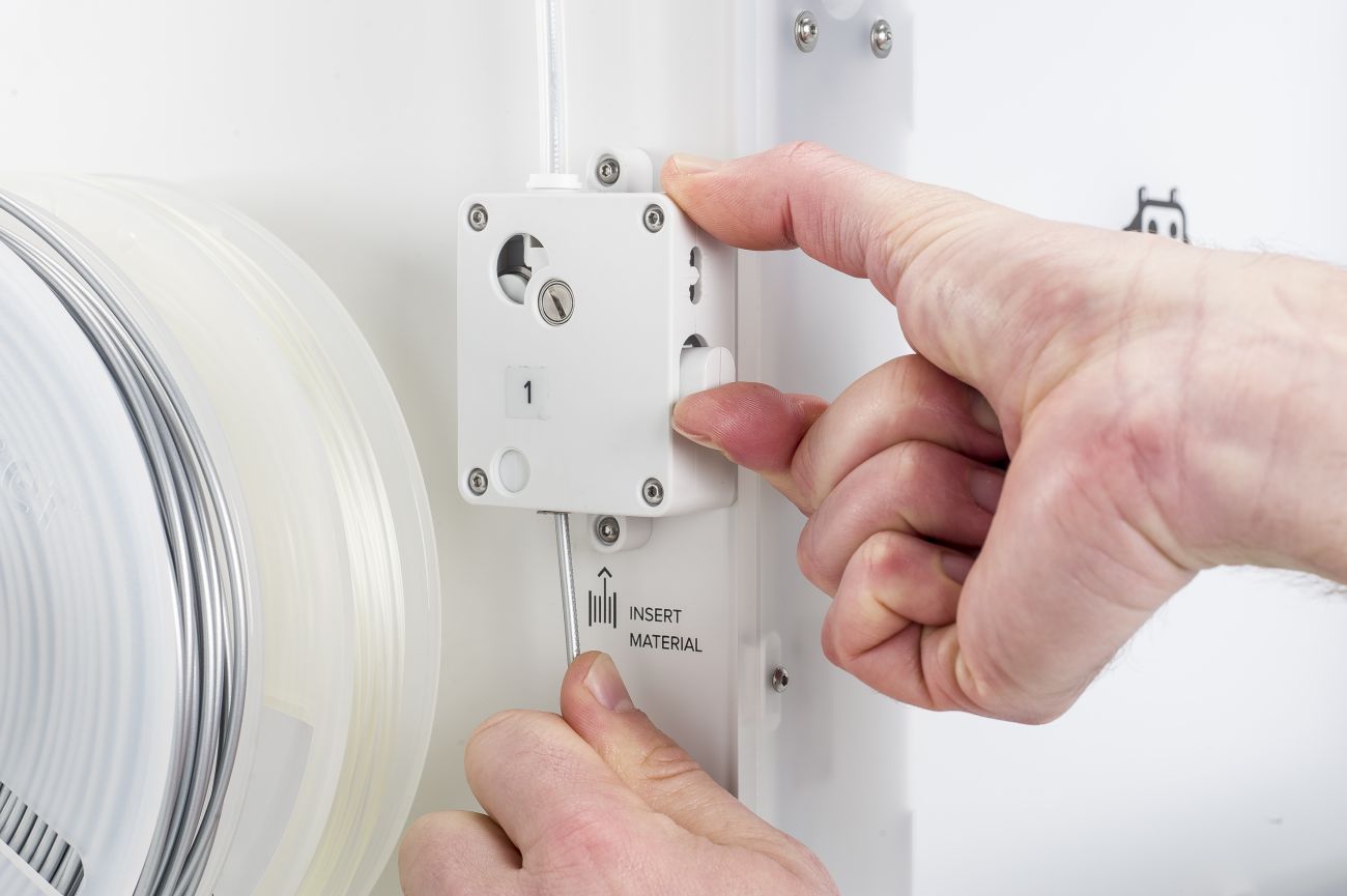

The filament may not completely rewind, due to the ground part in the feeder. To resolve this issue, gently pull on the filament when removing it. This will allow you to put extra force on it and will help the knurled wheel of the feeder get a grip on the material again. With the UltiMaker 3 and UltiMaker 2+ printers, you can also release feeder tension by lifting the lever at the side of the feeder, which allows you to manually pull out the material.
Material_ground_down_by_feeder_Manually_removing_filament.jfif
If the material breaks during removal or is impossible to extract, additional action is required:
  1. Cut the filament under the feeder, so that just a small piece remains.
  2. Remove the feeder clamp clip.
  3. Loosen the Bowden tube by pressing on the tube coupling collet and pulling the Bowden tube out.
  4. Pull the piece of the filament (sticking out at the bottom side of the feeder) from the top side of the feeder. Remove any small pieces of filament left in the feeder with tweezers.
  5. Now you should be able to remove the filament from the Bowden tube. Ensure the nozzle is heated whilst the material is still in the hot end.

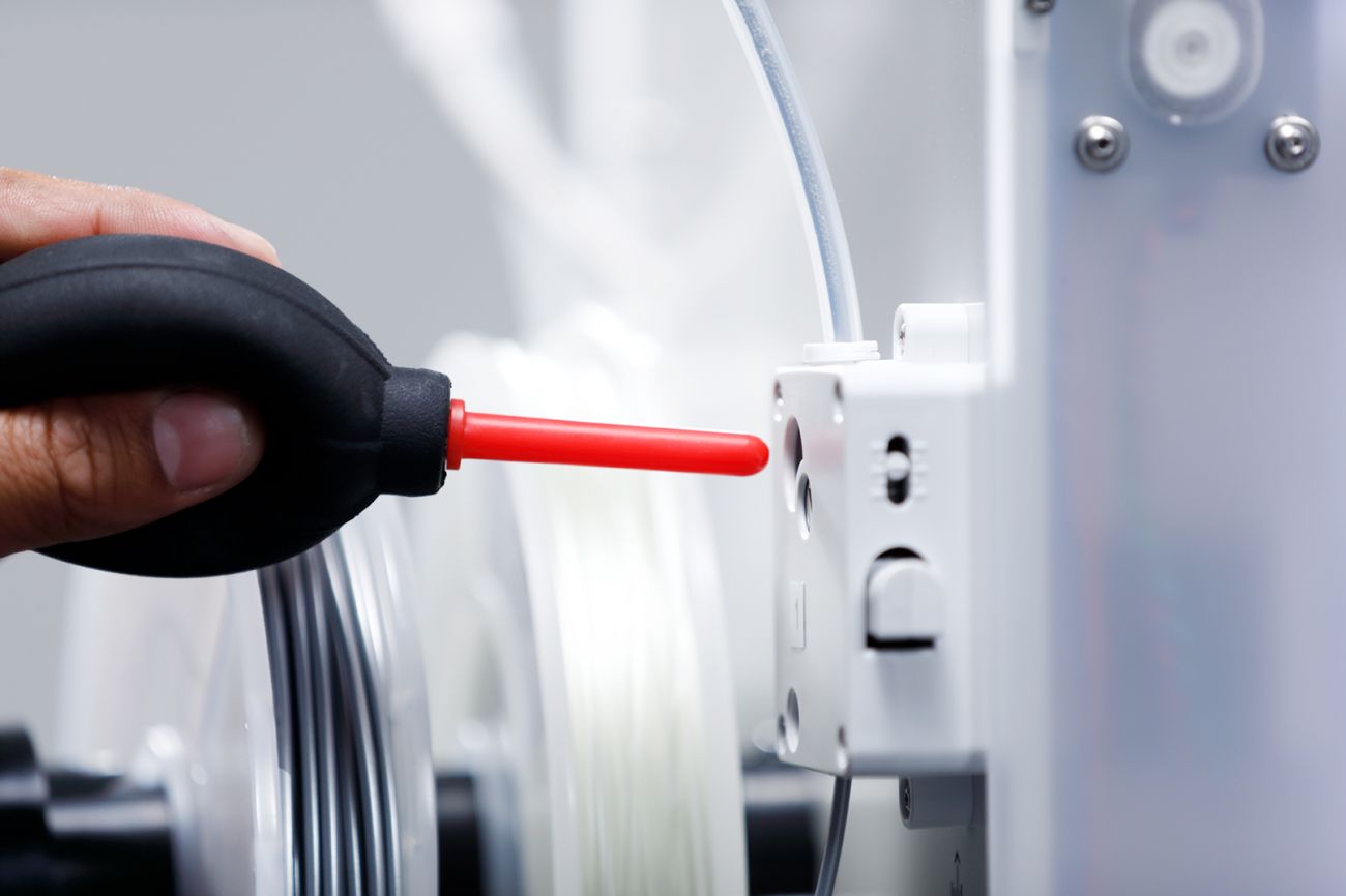

Cleaning the feeder
After removing the damaged material, clean the feeder to prevent issues during the next print job. Filament particles left in the feeder can prevent a reliable grip on the material, and travel up into the Bowden tube and hot end. The instructions for cleaning the feeder depend on your UltiMaker 3D printer model:
Note: If there are any small particles in the Bowden tube, this must be cleaned too. To learn how to properly clean the Bowden tube, visit this page.

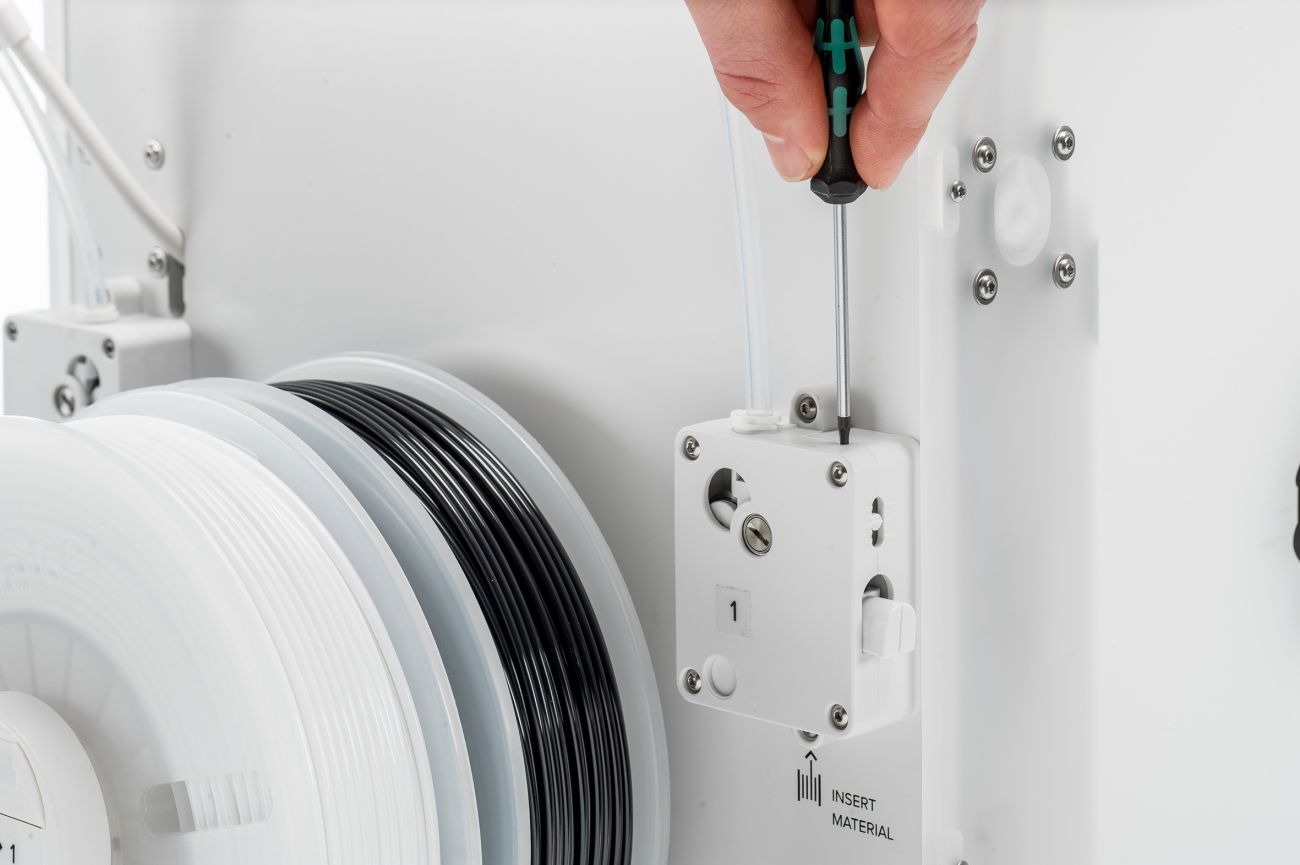

Checking the feeder tension
A possible cause of grinding is incorrect feeder tension. All UltiMaker 3D printers have a feeder that works with a spring mechanism to put tension on the filament. If the feeder tension is too low, the material can slip inside the feeder, but if the tension is too high, the knurled wheel can flatten the filament and cause grinding.
On the UltiMaker 2 series, the feeder tension is usually set to its loosest setting (with the indicator all the way at the top). On all other UltiMaker 3D printers, the feeder tension is in the middle. Adjust the feeder tension by turning the bolt in the top of the feeder. Move the indicator up for a low feeder tension, and down for a higher feeder tension.
Tip: Learn more about the feeder tension in this article: Feeder tension and how to adjust
