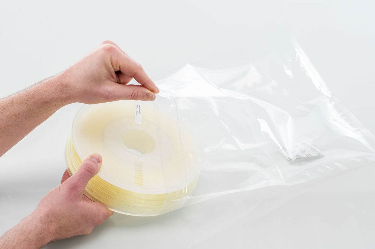

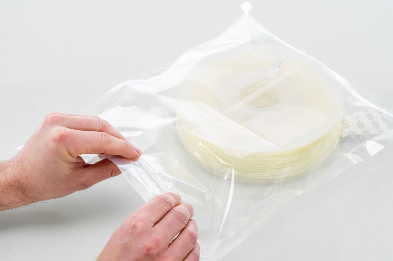

Store PVA in bag with desiccant
When storing the PVA in a sealed bag or box, add a few bags of fresh desiccant (silica gel). These will absorb the moisture and ensure that the PVA maintains its dryness level.
How_to_dry_UltimakerPVA_Placing_PVA_in_resealable_bag.jpgHow_to_dry_UltimakerPVA_Drying_PVA_in_resealable_bag.jpg
