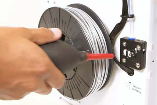

Cleaning the feeder
After a lot of printing, the knurled wheel in the material feeder can accumulate small filament particles. It is recommended to check and clean the feeder every three to six months (depending on your printing hours), or when you experience extrusion problems.
Unload materialFirst, remove the filament from the printer. In the Material menu, select Change. Take the filament out of the feeder. You can remove the spool from the printer, or just push the end of the filament through one of the holes in the spool to prevent the material from getting tangled.
Clean the feederTo clean the feeder and the knurled wheel, you can either use (compressed) air, or a small brush (such as an old toothbrush). Make sure all the filament particles are removed.
Reload Place the spool back onto the spool holder or remove the end of the filament from the hole in the spool. Follow the steps on the display and insert the filament into the feeder.
Tip: If you are cleaning the feeder after you had problems with material grinding, make sure to cut off the damaged piece of material before reloading the filament. Also check for material particles in the Bowden tube, and clean the tube if necessary.
