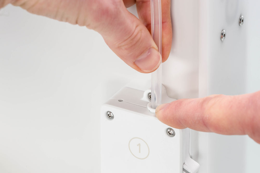

2. Remove the Bowden tubeRemove the clamp clip from the feeder-end of the Bowden tube, press down on the tube coupling collet, and pull the Bowden tube upwards out of the feeder.

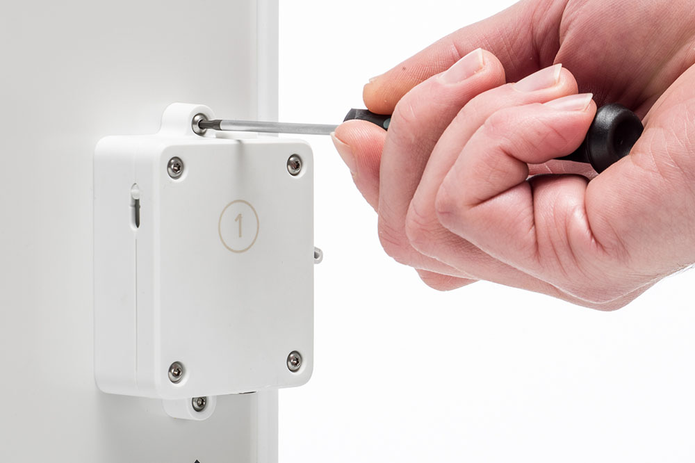

3. Remove the feederUse the hex screwdriver to loosen the two bolts that hold the feeder to the back panel and remove the feeder from the printer.

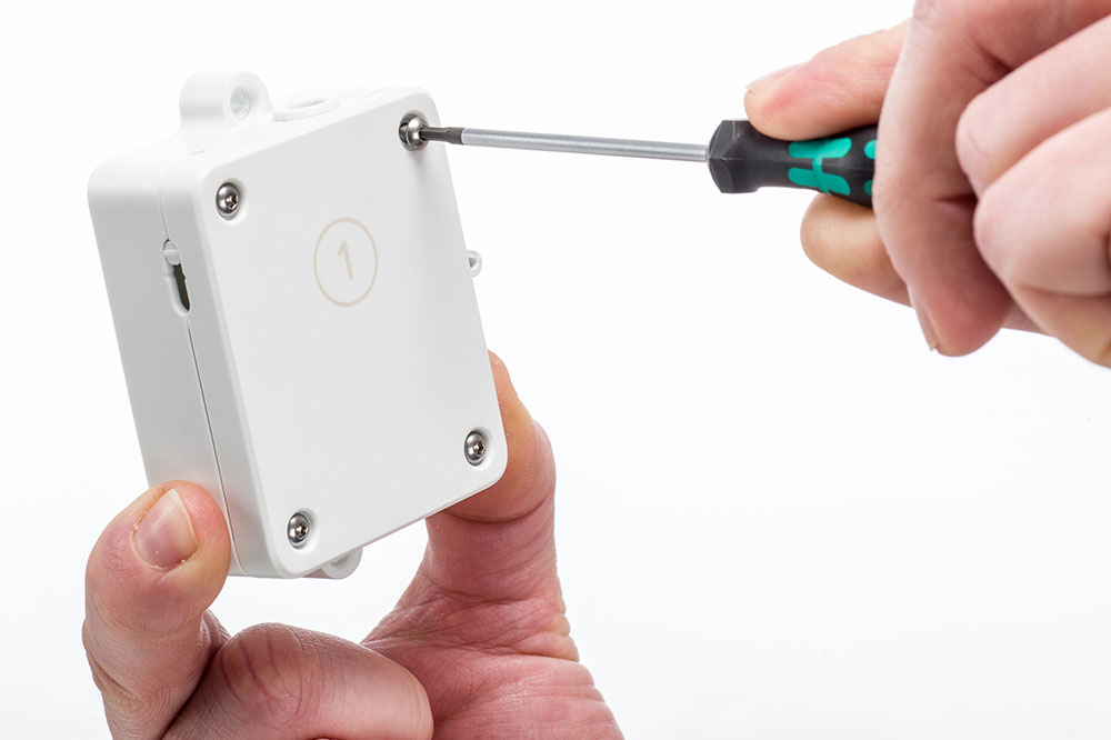

5. Open the feederUse the hex screwdriver to loosen the four bolts of the feeder housing. Carefully take the two halves of the feeder apart and place the tube coupling collet aside.

Remove the Bowden tubeLoosen the feeder from the printerOpen the feeder housing

3. Tighten the boltsInsert the four bolts into the front of the feeder. Use the hex screwdriver to tighten them. It is recommended to tighten the bolts in a cross pattern, starting in the top-left corner.

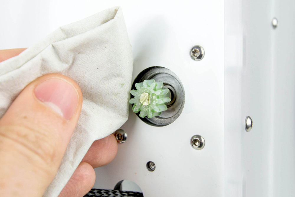

First, remove the majority of the old grease and any particles stuck to the gears. Clean both the gear connected to the motor and the larger gear inside the feeder using a clean cloth or a cotton swab.

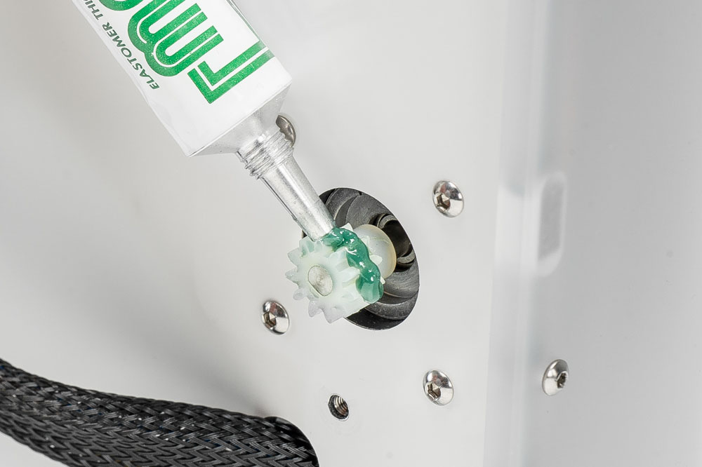

Next, apply a small amount of grease to the gear attached to the feeder motor. There is no need to spread this out; the feeder will do this automatically when it turns after reassembly.

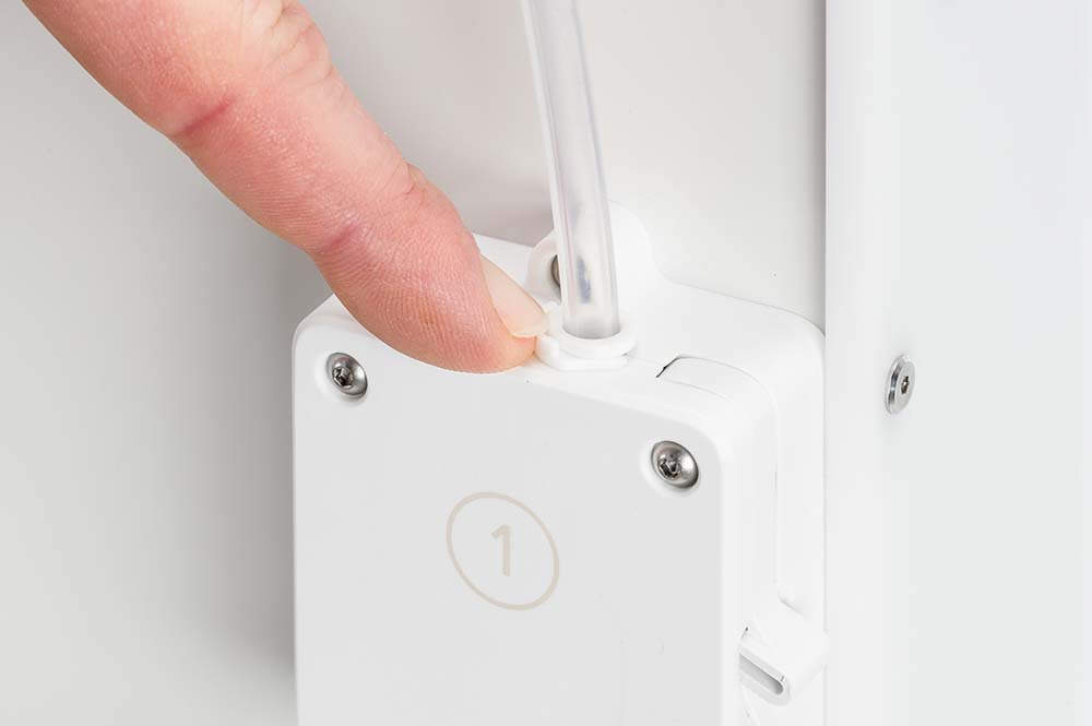

  3. Insert the Bowden tube into the feeder by pressing down on the tube coupling collet in the feeder and pushing the Bowden tube all the way in.
  4. Secure the tube with the clamp clip.
