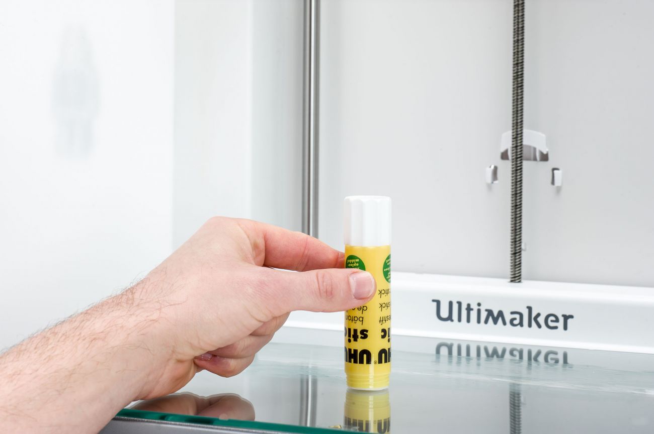

To ensure reliable adhesion to the glass build plate and to reduce the chance of glass chipping, a thin layer of UHU glue should be applied to the glass plate. No glue is required to print on the flexible build plate of the Factor and S Series printers.
Caution: The addition of glue is recommended to improve adhesion and thereby prevent the chance of print failure and printer damage. Additionally, the use of glue can prevent over-adhesion which could otherwise lead to damage to the build plate.
