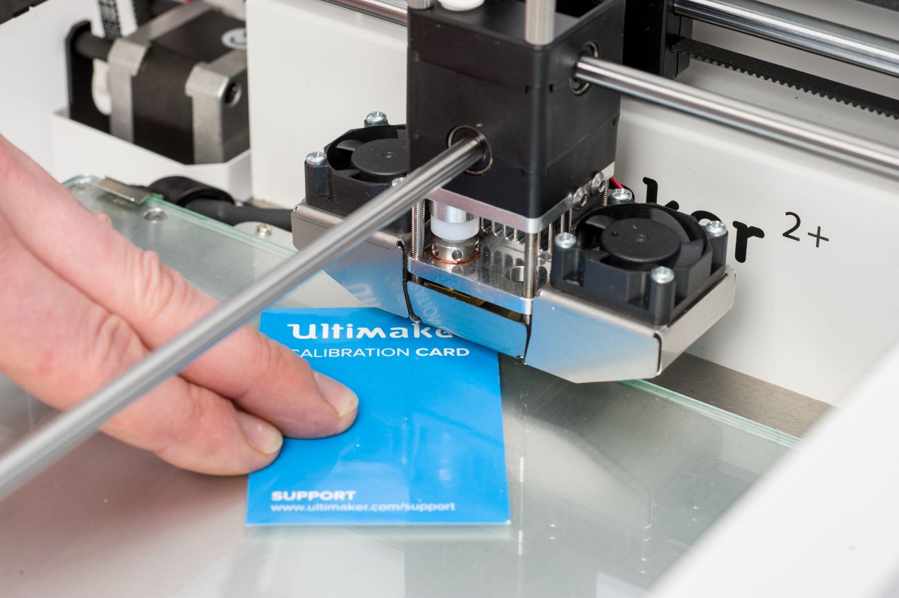

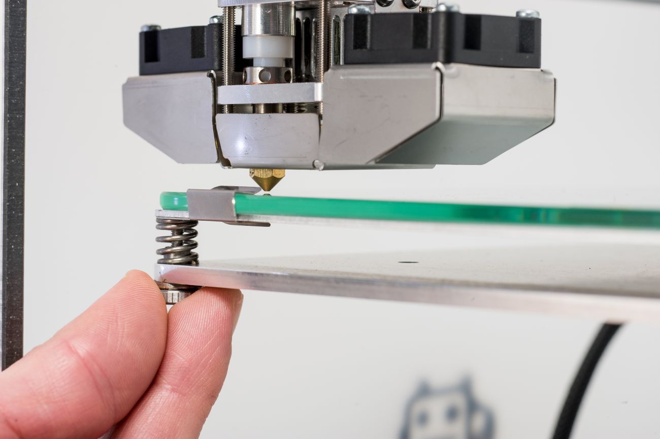

Ensure the build plate is leveled correctly
It is important that the first print layer of a print is pressed firmly onto the build so it will bond properly. If the nozzle is too far from the build plate, the first layer will not adhere properly and the print can come loose.
The UltiMaker S series printers and the UltiMaker 3 use an active leveling process. This multipoint build plate calibration compensates for any inaccuracies or tilt of the build plate. Learn more about More information on how to level the Ultimaker S5 build plate can be found here.
Always ensure your build plate is leveled correctly. If you are experiencing problems with the first print layer, such as warping or the print detaching, relevel the build plate. Most UltiMaker 3D printers contain assisted leveling procedures via the printer's menu. Learn how to manually level your build plate in your printer's user manual or in the support articles listed below:
UltiMaker S seriesUltiMaker 2+ ConnectUltimaker 2UltiMaker Original+
UltiMaker 3UltiMaker 2+UltiMaker 2 GoUltiMaker Original
How_to_fix_warping_Releveling_build_plate.jpgHow_to_fix_warping_Using_calibration_card.jpg

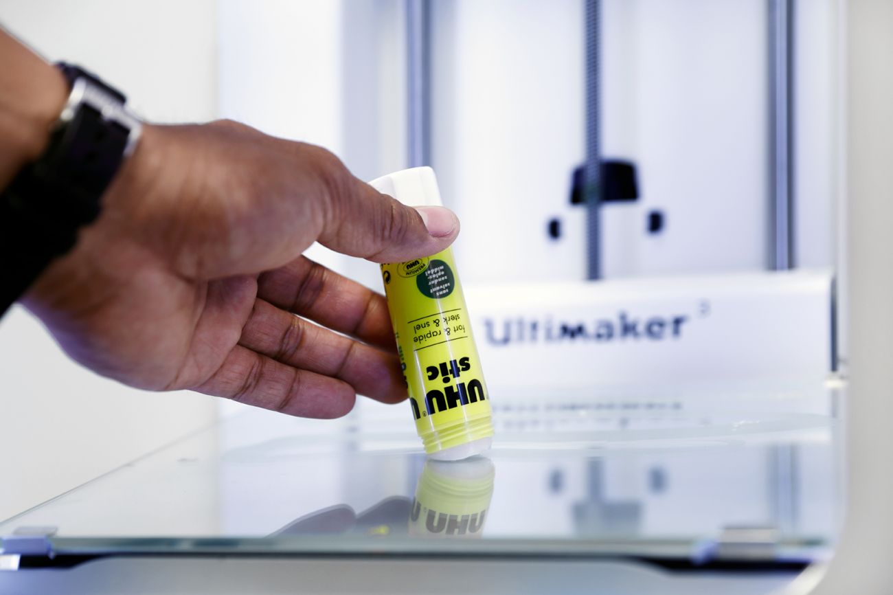

Apply an adhesive
Correctly preparing your build plate surface is essential for good adhesion. Firstly, ensure to regularly clean the build plate. There should be no traces of oil or grease on it, as this will worsen the adhesion.
On UltiMaker printers without a heated build plate, such as the Original and UltiMaker 2 Go, preparing the build plate with a layer of blue tape is recommended. Most UltiMaker printers have a heated glass build plate. On a glass plate, many materials benefit from a thin layer of glue applied evenly. Alternatively, an adhesion sheet can be used. The UltiMaker S7 has a flexible build plate; most materials should be printed directly on a clean surface.
Tip: The optimal adhesion methods differ per material. Please see the How to print guides or the recommended glue overview for UltiMaker materials.

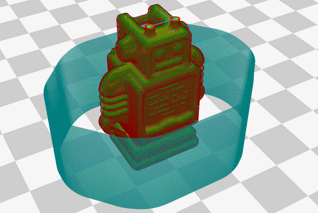

Print with a draft shield
UltiMaker Cura offers the (experimental) option to print with a draft shield. This creates a one-layer thick wall around your model, preventing unwanted airflows from cooling it excessively.
