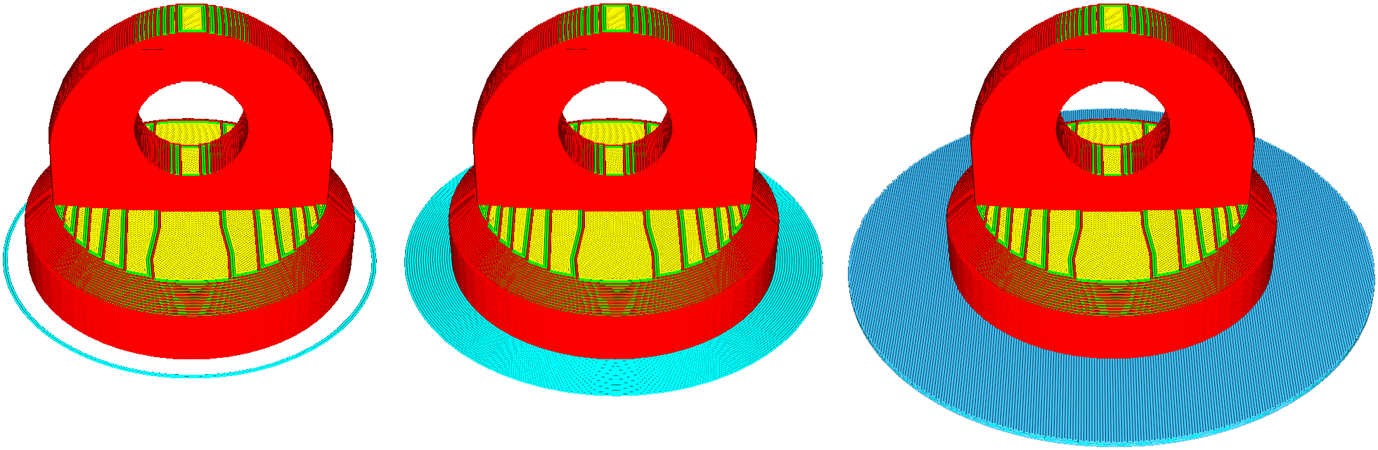

There are three types of build plate adhesion: Skirt, Brim, and Raft. You can also easily disable the adhesion types by selecting None.
BuildPlateAdhesionType.pngThis model has the build plate adhesion types from left to right: skirt, brim, and raft. Learn more about the different types and related settings in the dropdowns below:

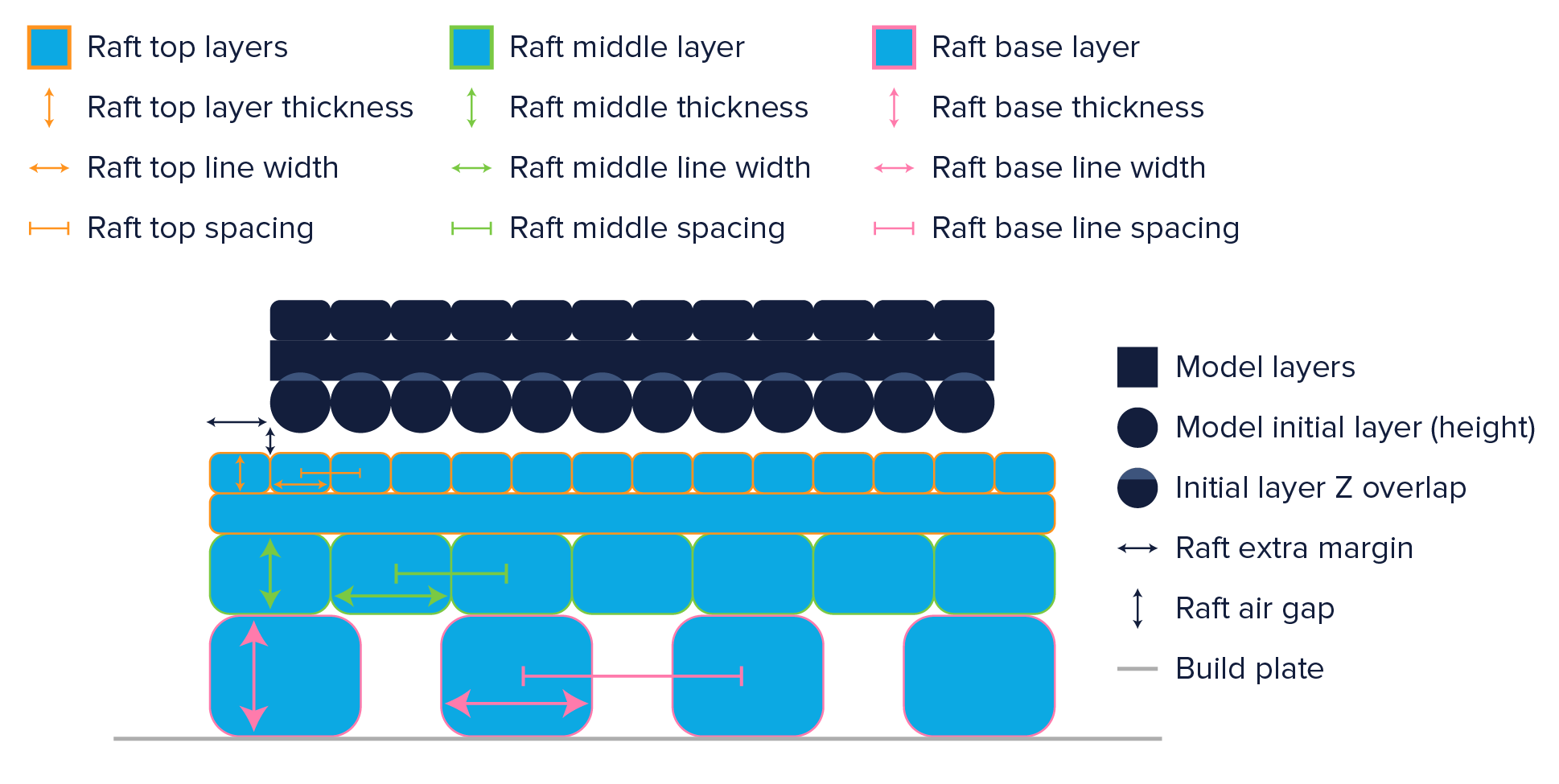

Raft
A raft adds a thick grid with a roof between the model and the build plate. This can be useful when the bottom surface of a model is not completely flat or has little adhesion to the build plate. A raft ensures that the model will stick better to the build plate.
The raft options in UltiMaker Cura are extensive. The raft is divided into three parts: top layers, middle layers, and base layers. The image below explains the raft settings that are available. It is important to know:
  • Initial Z overlap. This setting lowers all layers of the model, except the initial layer, to compress the initial layer against the raft.
  • Raft base layer. This layer needs to be pressed right up against the build plate and therefore looks oversized.
A visualization of the raft settings in UltiMaker Cura:
The final result when printing with the raft as visualized above will end up like in the image below.
