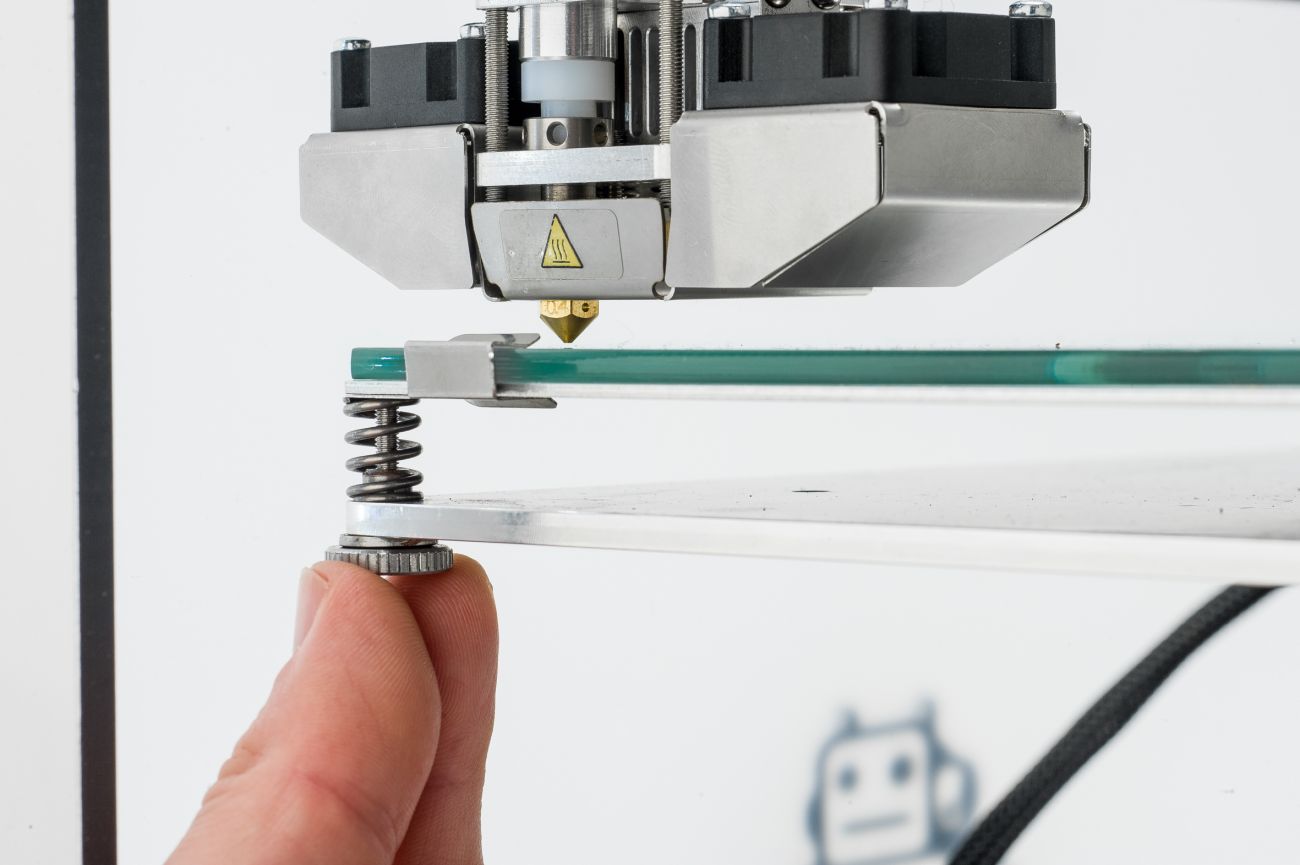

Rough leveling
In the first part of the process, you set the approximate correct height of the build plate.
  1. Wait for the Ultimaker 2+ to do its homing procedure and continue when the print head is in the center at the back of the build plate.
  2. Rotate the button at the front until there is approximately a 1 mm distance between the nozzle and the build plate. Make sure that the nozzle is close to the build plate without touching it.
  3. Adjust the front right and front left knurled nuts to roughly level the build plate at the front side. Again, there should be a distance of approximately 1 mm between the nozzle and the build plate.

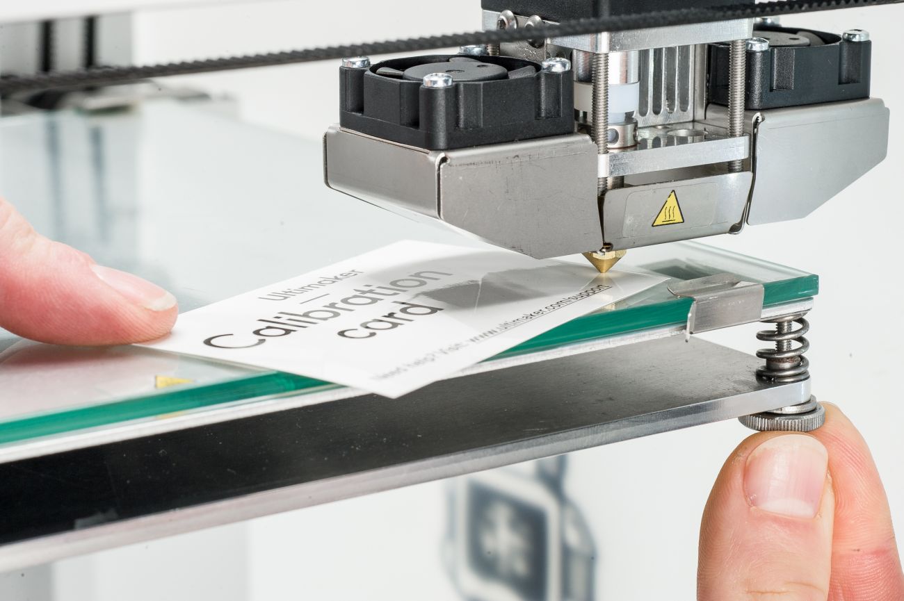

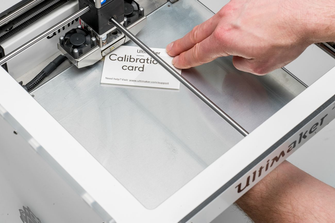

In the next part, you will fine-tune the position of the build plate. For these steps, you will use the calibration card to ensure the same distance between the nozzle and the glass plate at all points.
  1. Place the calibration card between the nozzle and the build plate when the print head is in the center back of the build plate
Note: Do not push on the build plate while fine-tuning with the calibration card. This will lead to inaccuracies.
  1. Adjust the knurled nut in the middle back until you feel slight friction when moving the card.
  2. Press Continue. The print head moves to the second point.
  3. Repeat steps 1 and 2 for the second point.
  4. Press Continue again. The print head moves to the third point.
  5. Repeat steps 1 and 2 for the third point.
Build_plate_leveling_Ultimaker2 _Adjusting_knurled_nut.jfifBuild_plate_leveling_Ultimaker2 _Place_calibration_card.jfif

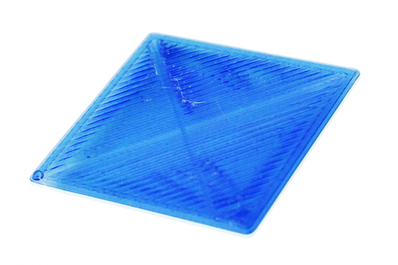

Too close
The build plate is too close to the nozzle. The material cannot extrude from the nozzle properly. The first layer is very thin.
Relevel the build plate with a bit more distance between the nozzle and the build plate.

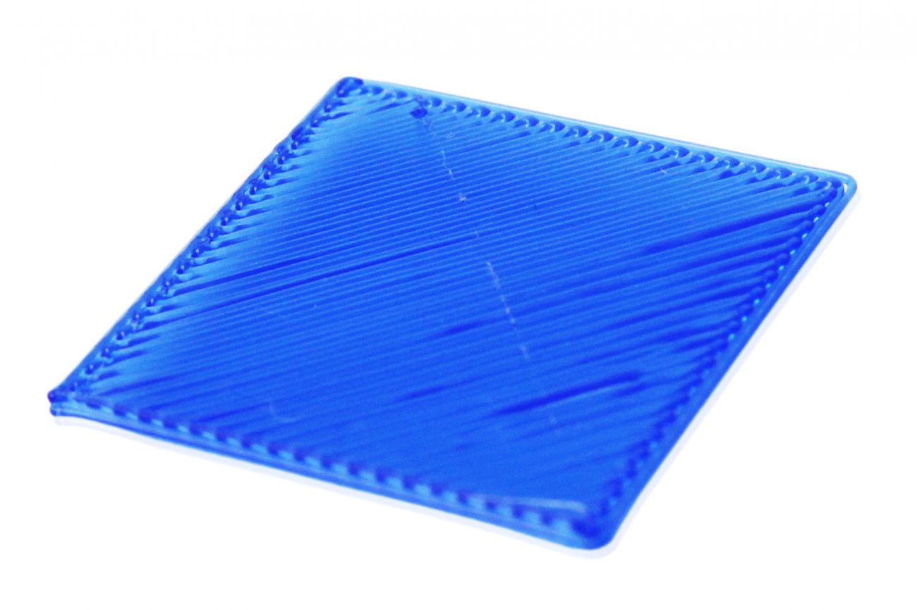

Too far
The build plate is too far from the nozzle. The lines are not pressed into the glass build plate. There is a high chance that the print will come loose from the plate during printing.
Relevel the build plate with less distance between the nozzle and the build plate.
