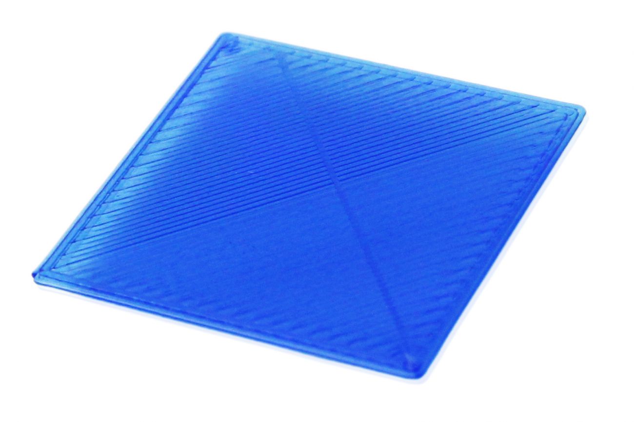

Successful first layer
The print properly sticks to the glass plate and all lines are nicely uniform.
The adhesion and extrusion are good, so there is a high chance of print success!

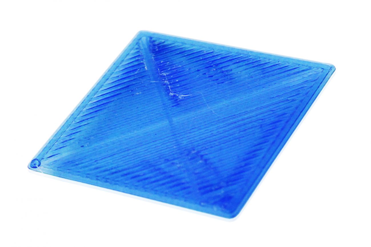

Too close
The build plate is too close to the nozzle. The material cannot extrude from the nozzle properly. The first layer is very thin.
Relevel the build plate with a bit more distance between the nozzle and the build plate.

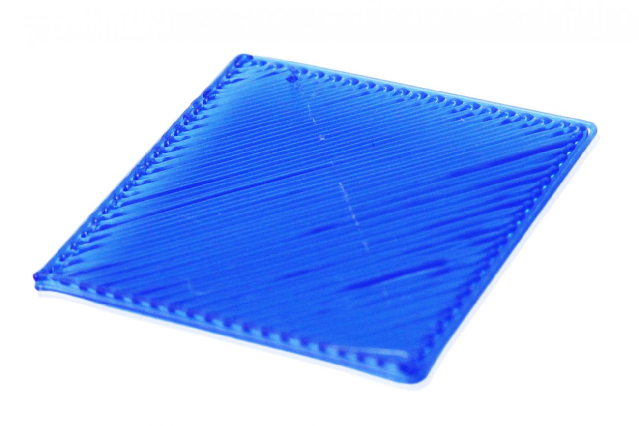

Too far
The build plate is too far from the nozzle. The lines are not pressed into the glass build plate. There is a high chance that the print comes loose from the plate during printing.
Relevel the build plate with less distance between the nozzle and the build plate.
