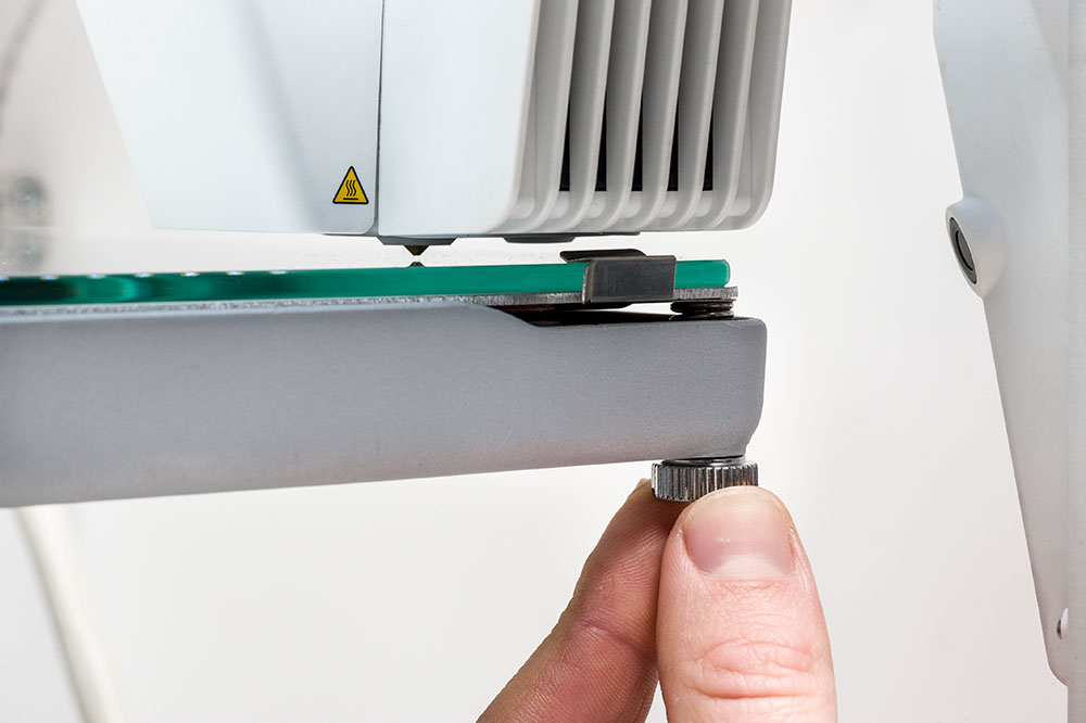

  1. The print head will first move to the back of the build plate. Use the touchscreen controls to move the build plate until there is approximately 1 mm distance between the first nozzle and the build plate. Make sure that the nozzle is close to the build plate without touching it. Confirm to continue.
  2. The print head will move to the next position. Adjust the front-right thumb wheel to roughly level the build plate at the front. There should be a distance of approximately 1 mm between the nozzle and build plate. Confirm to continue.
  3. The print head will move to the next position. Repeat step 2 for the front-left thumb wheel and Confirm to continue.

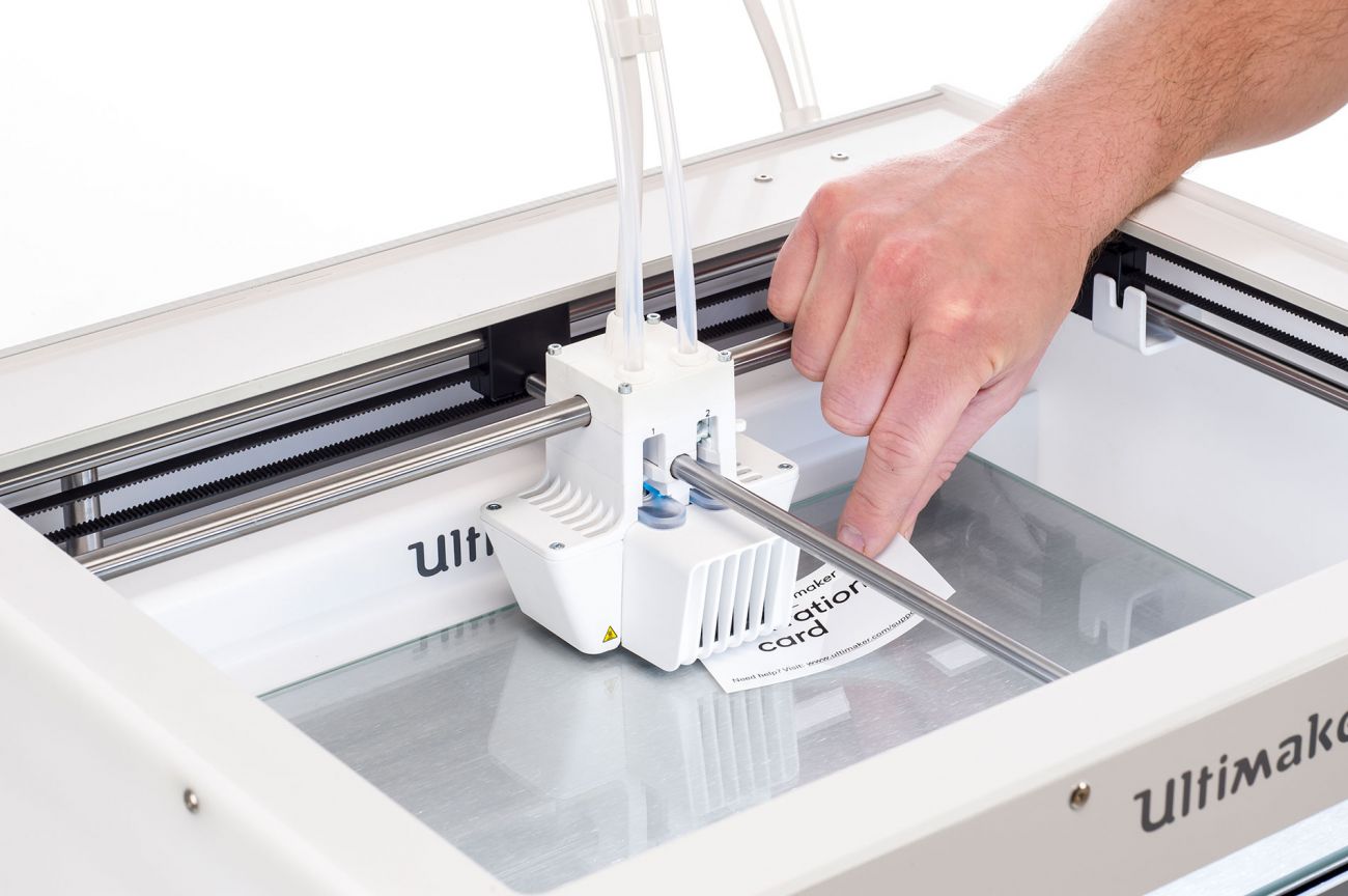

In the next step, fine-tune the position of the build plate using the calibration card. Follow the instructions on the display.
Note: Do not apply pressure to the build plate while fine-tuning with the calibration card. This will lead to inaccuracies.

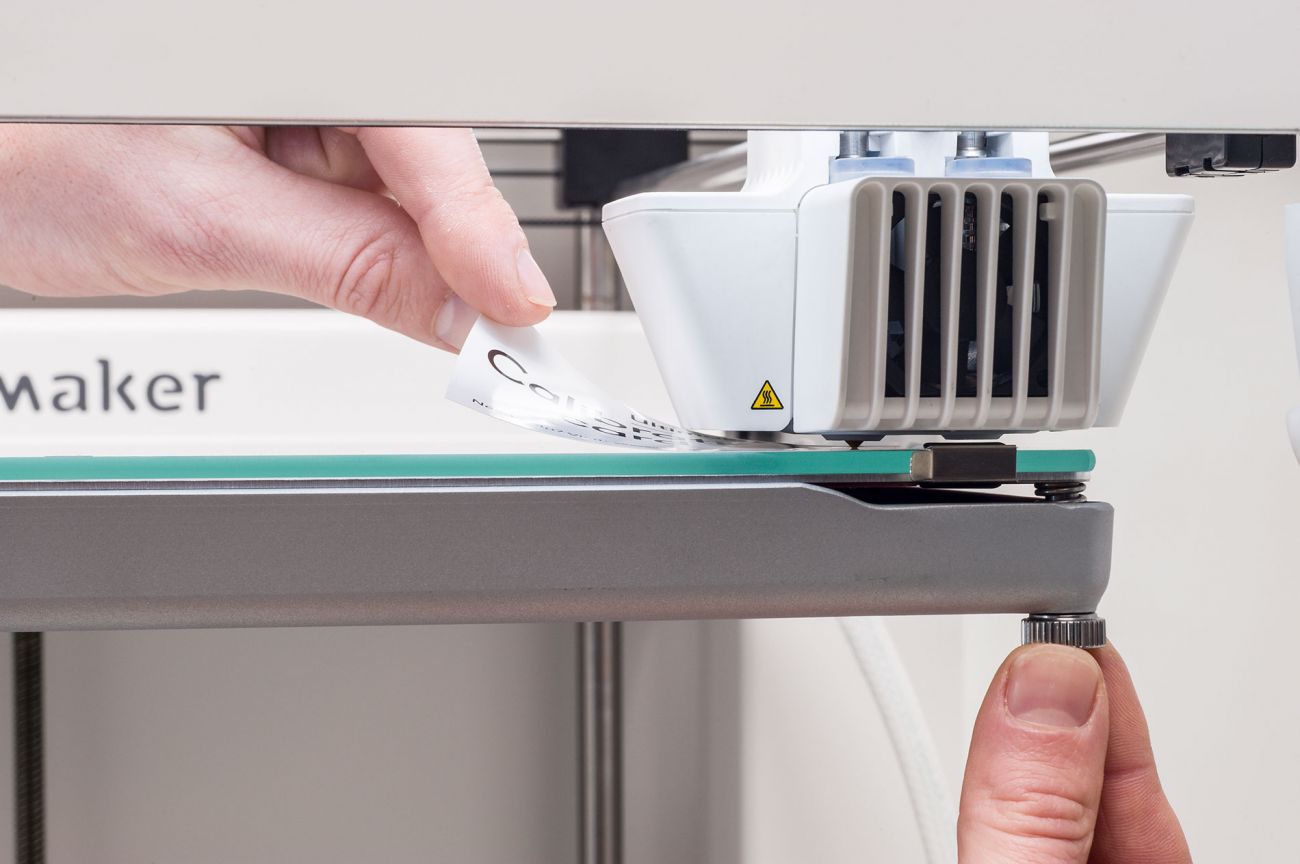

  1. The print head will start again at position 1, in the back of the build plate. Place the calibration card between the nozzle and build plate. Use the touchscreen controls to adjust the position of the build plate until you feel some resistance when moving the card. Select Confirm to continue.
  2. The print head will move to the next position. Place the calibration card between the nozzle and build plate in the front-right corner. Adjust the thumb wheel until you feel some resistance when moving the card (the same amount as for position 1). Confirm to continue.
  3. The print head will move to the next position. Repeat step 2 for the front-left corner and Confirm to continue.

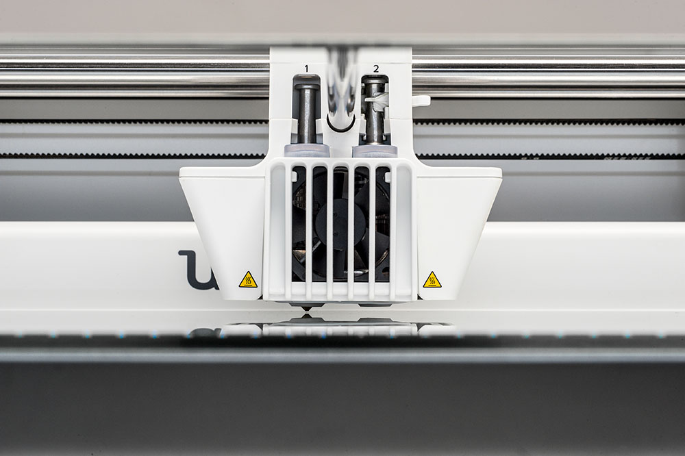

In the final step, set the vertical offset between the first and the second nozzle. This ensures that the two print cores are aligned well in dual extrusion prints. During this step, do not alter the position of the build plate with the thumb wheels. Only use the controls and the calibration card.
Note: Do not apply pressure to the build plate while setting the Z offset with the calibration card. This will lead to inaccuracies.
  1. Place the calibration card between the second nozzle and build plate.
  2. Use the controls to adjust the position of the build plate until you feel some resistance when moving the card. Select Confirm to continue.
  3. Wait for the printer to finish the manual leveling procedure.

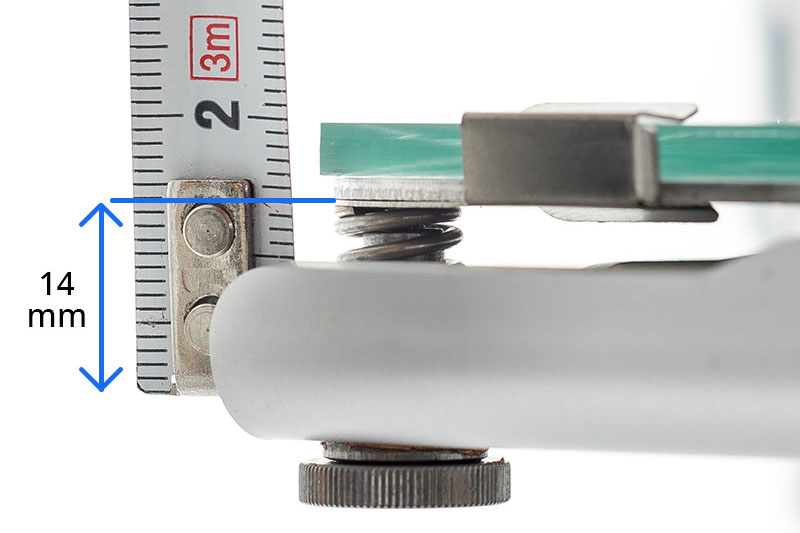

Factory position
After performing the manual leveling process multiple times, the springs under the build plate may have become too loose. This means that the build plate is too high, which could cause problems during active leveling.
Reset the position of the build plate to the factory position. This is different for the UltiMaker S3 and UltiMaker S5/S6.
Note: This does not apply to UltiMaker S series printers with the flexible build plate. On these printers, the build plate is in a fixed position, and they do not offer a manual leveling procedure.
UltiMaker S3
Use a spacer tool or a ruler. Adjust the three thumb wheels under the build plate until there is a distance of 14 mm between the bottom of the heated bed and the top of the base plate.
