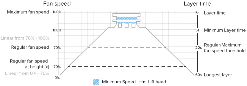

The image below depicts an overview of common cooling settings combinations, projected onto a pyramid model:
Regular/maximum fan speed threshold
This setting defines the layer time at which the fan will switch between regular fan speed and maximum fan speed. Layers that take longer to print than this time use the regular fan speed. For faster layers, the fan speed gradually increases towards the maximum fan speed.
Initial fan speed
This controls the fan speed on the initial layer only, which adheres to the build plate. This fan speed is often lower to prevent too much cooling of the printed layer and build plate, and a lower setting (or even 0%) will improve build plate adhesion. After this initial layer, the speed then increases to the regular fan speed, which is achieved once it reaches the height setting for the regular fan speed.
Regular fan speed at height / layer
This is the height at which the fans will have increased to full speed. In the layers below, the fan speed will gradually increase from the initial fan speed to the regular fan speed.
It is also possible to change this parameter by adjusting the layer number at which the fans should be at full speed.
Using a higher value increases the adhesion to the bed, but can also lead to oozing and a reduced print quality. Printing with the fans on full from a height of 0.5 mm is usually sufficient, but this depends on the material, the layer height, and the initial layer height.
