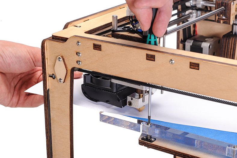

Adjusting the build plate
The print head will move to each corner of the build plate, so you can adjust the height for each position.
First, adjust the screw in the front left corner of the build plate. You can use the provided hex key or a 2 mm hex screwdriver for this. The build plate is at the correct height when the nozzle is just touching the build plate.
When finished with this corner, click Move to next position and the print head will move to the next point. Repeat these steps for all points.
Tip: For accurate bed leveling, it is advised to use a piece of paper. Slide the paper between the nozzle and build plate at each point and make sure that you feel slight friction when moving the piece of paper.

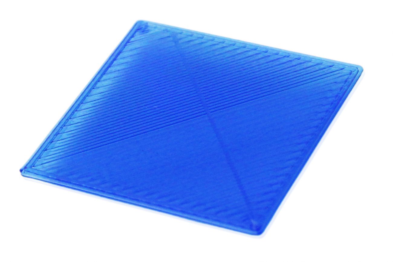

Successful first layer
The print properly sticks to the build plate and all lines are nicely uniform.
The adhesion and extrusion are good, so there is a high chance of print success!

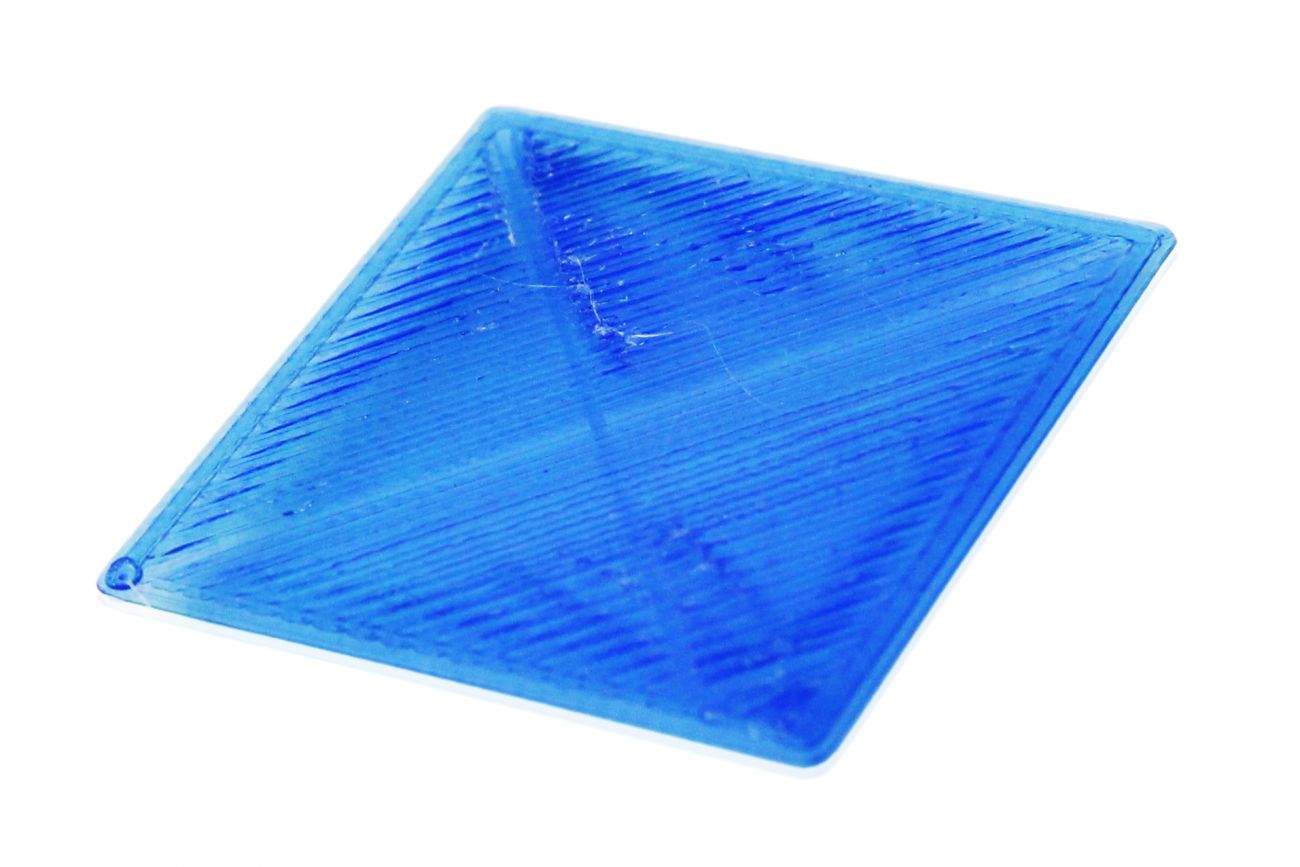

Too close
The build plate is too close to the nozzle. The material cannot extrude from the nozzle properly. The first layer is very thin.
Relevel the build plate with a bit more distance between the nozzle and the build plate.

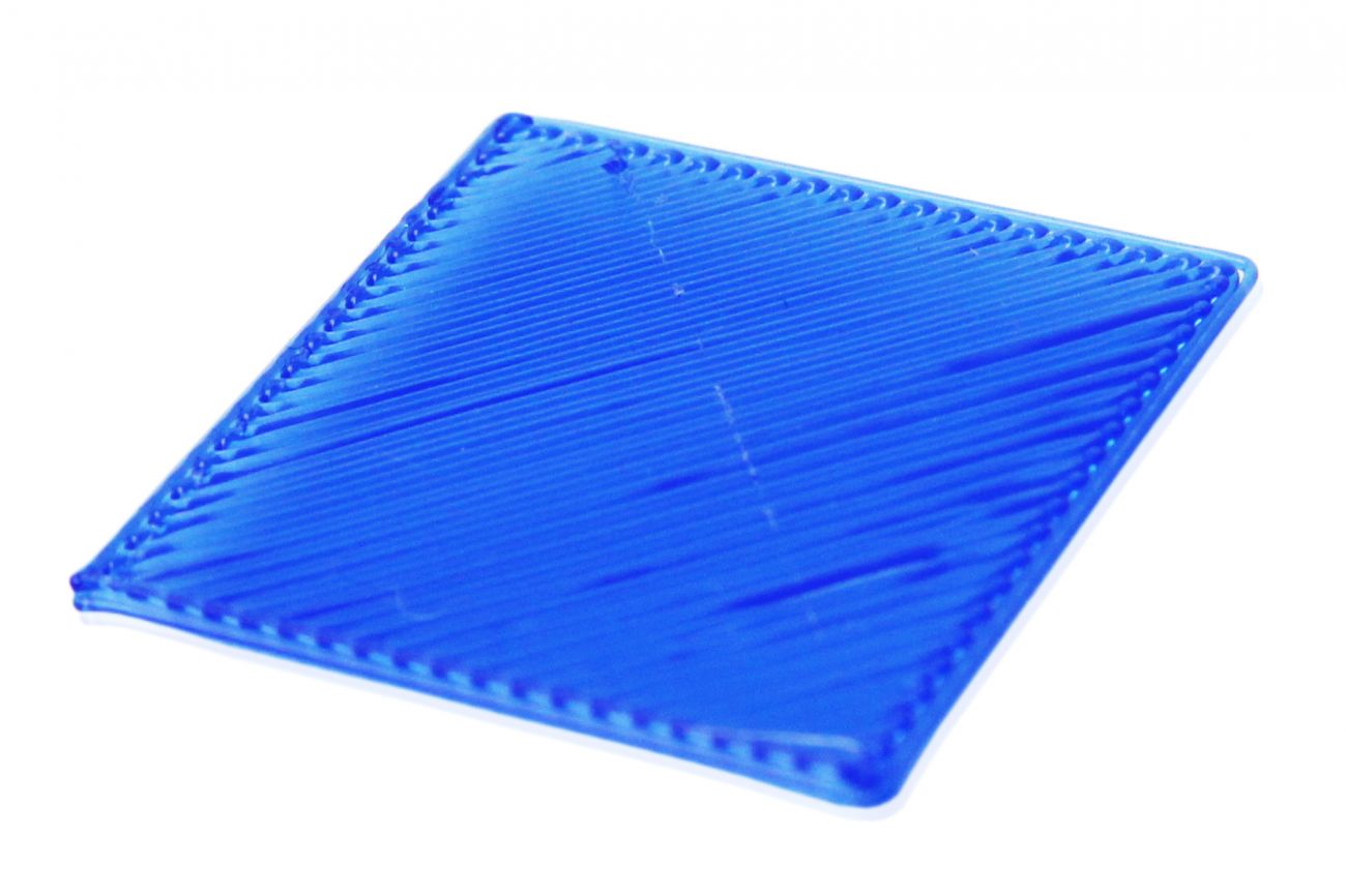

Too far
The build plate is too far from the nozzle. The lines are not pressed into the build plate. There is a high chance that the print comes loose from the plate during printing.
Relevel the build plate with less distance between the nozzle and the build plate.
