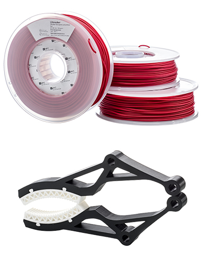

UltiMaker TPU 95A (thermoplastic polyurethane) is a semi-flexible material that can be used in a wide variety of engineering applications where performance is more important than aesthetic qualities. Although most flexible filaments are usually difficult to print, UltiMaker TPU 95A is optimized for easier and faster printing without negatively affecting layer bonding.
Tip: Dry UltiMaker TPU 95A before printing. The filament can be dried following the recommendations described in this article. Additionally, make sure print cores are cleaned using a hot and cold pull.

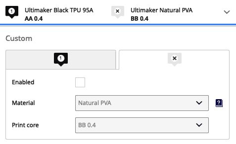

Dual material combinations
Because TPU 95A is prone to oozing, it is not officially supported in combination with other materials. However, several experimental combinations are possible on dual-extrusion UltiMaker printers, for both support materials and other build materials.
Support materials:
  • PVA (experimental)
  • Breakaway (experimental)
  • Tough PLA (experimental)
  • PLA (experimental)
  • Self-support (TPU 95A)
Dual combinations:
  • TPU 95A (dual color)
  • PETG (experimental)
  • ABS (experimental)
  • Nylon (experimental)
  • PC (experimental)
  • PET CF (experimental)
  • Nylon CF Slide (experimental)
Note that all possible combinations are listed as experimental, because any combination with TPU 95A may result and stringing and blobs on the surface of the print. Results are dependent on the model type that is used.
Tip: Improve your dual extrusion results with TPU 95A by using the interlocking feature in UltiMaker Cura. This improves the bonding between otherwise incompatible materials.

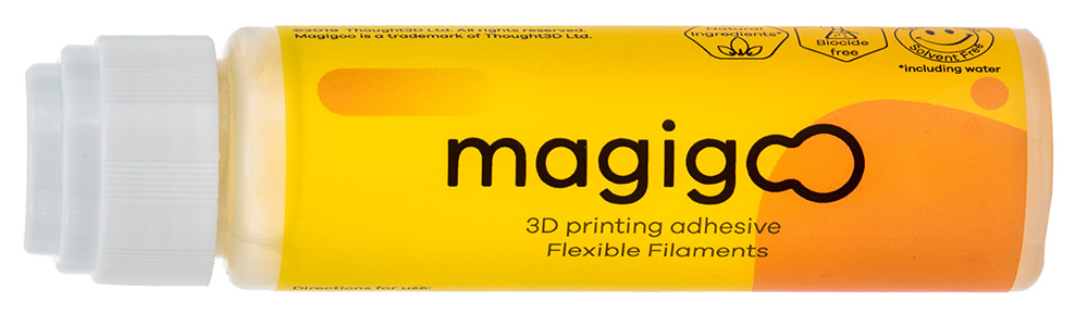

Adhesion
In most instances, extra adhesion is not necessary for a successful print, but it is always advised to apply a thin layer of UHU glue to the glass plate for the best adhesion. No glue is required to print on the flexible build plate of the Factor and S Series printers.
To improve adhesion when printing more complex prints with UltiMaker TPU 95A, it is recommended to apply a thin layer of Magigoo Flex to the glass plate.
Caution: The addition of glue is recommended to improve adhesion and thereby prevent the chance of print failure and printer damage on the glass plate. Additionally, the use of glue can prevent over-adhesion, which could otherwise lead to damage to the build plate. Prints using Magigoo Flex as the adhesive may be difficult to remove. It is then recommended to place the glass plate in water and thereby dissolve the adhesive. More information can be found here.
Note: Do not use the adhesion sheets for UltiMaker TPU 95A. The adhesion is so strong that the sheet will tear after the removal of the first 3D print.
A brim is the default build plate adhesion type in the UltiMaker TPU 95A print profiles in UltiMaker Cura. A brim consists of extra lines printed around the perimeter of the initial layers of your model. This ensures reliable adhesion to the build plate.
