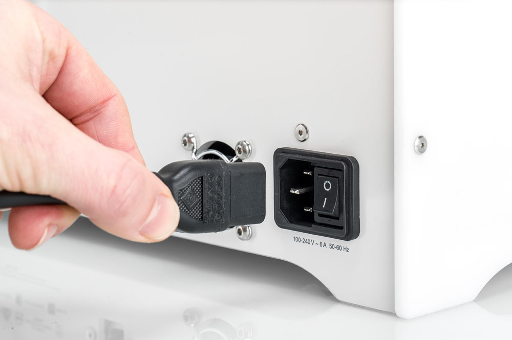

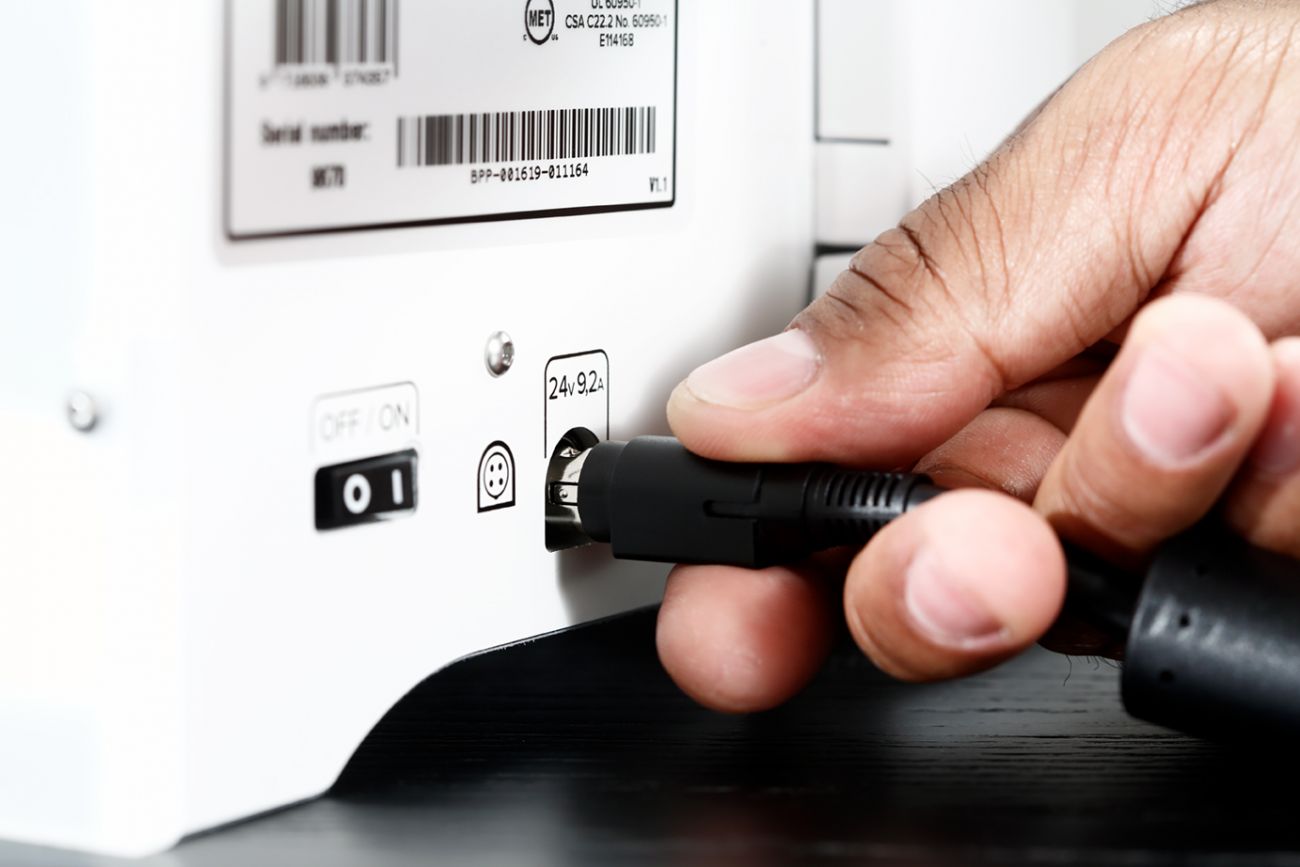

Power your machine properly
Ensure the machine is turned on. The main menu should be visible on the display, and the LEDs of the machine should be lit.
Connect the power cable at the back of the machine and press the switch to turn on the printer. For S series printers with a Material Station: insert the power cable into the Material Station, and connect the power extension cable between the printer and the Material Station.
Note: The bootup process may take longer than expected. Please be patient and wait for the printer to boot up completely.
