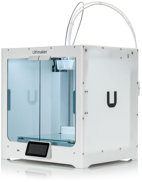

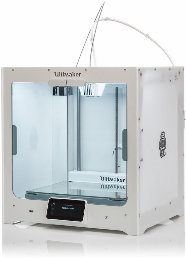

You can easily distinguish the R1 from the R2 versions by the branded side panels. The image on the left shows the UltiMaker S5 R1 (2018 - early 2020) with the Ultibot on the side panels. The image on the right shows the newer version of the UltiMaker S5 (R2) with the 'U' icon on the side panels.
