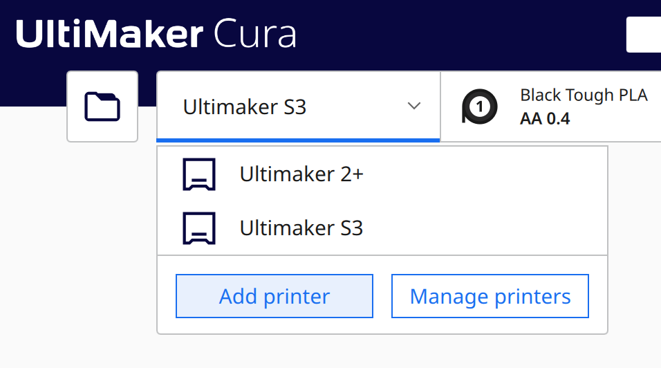

To use UltiMaker Cura, you must add at least one printer. This is part of the welcome setup after you install Cura for the first time, but you can always add more printers later via the Printers panel in the Cura interface.

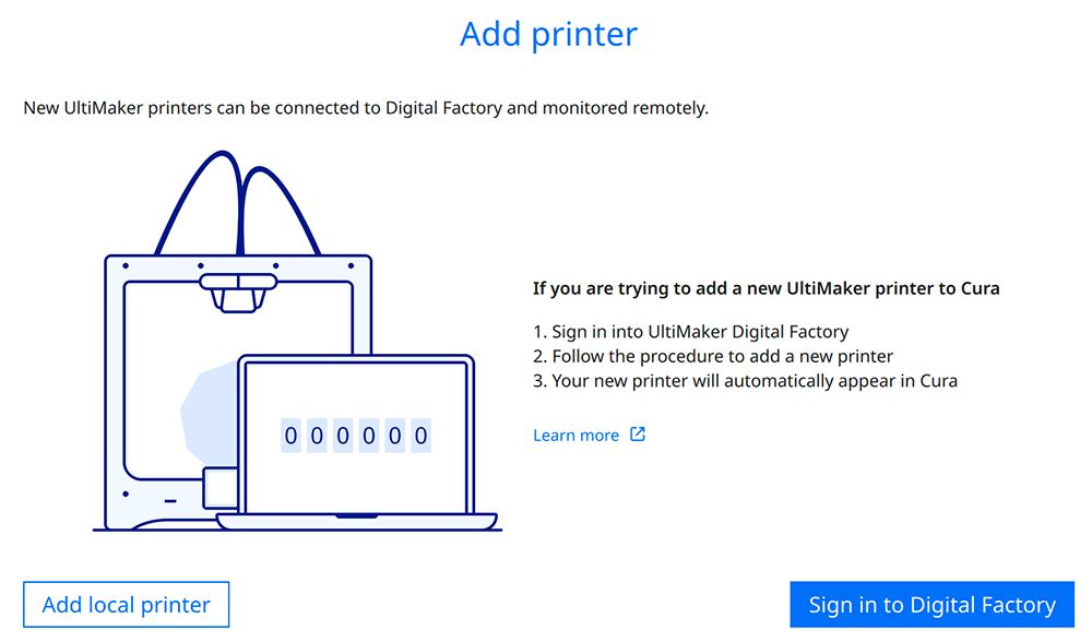

Your UltiMaker 3D printers which are connected to the Digital Factory can very easily be added to UltiMaker Cura by signing in to your account. The UltiMaker Digital Factory is currently available for the S series, Ultimaker 3, and UltiMaker 2+ Connect.

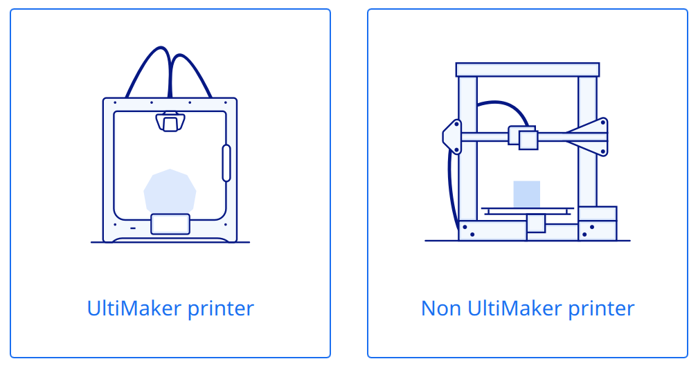

In the printer brand selection panel, select Ultimaker printer. The next screen will prompt you to sign in to the Digital Factory. After doing so, all connected printers will automatically be added to Cura.
If you want to add more printers, select the + Add Printer button in the Printers tab in Digital Factory, and get the 6-digit code from the printer via the Network menu.

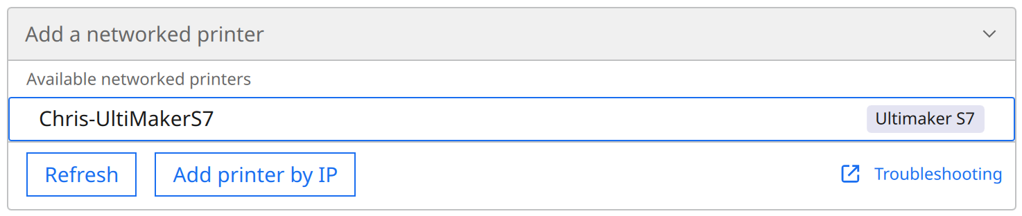

In the printer brand selection panel, select Ultimaker printer. In the next screen which prompts you to sign in to the Digital Factory, select Add local printer. Under the header Add a networked printer, you will see a list of all printers connected to the same local network. Select the right printer and click Add.

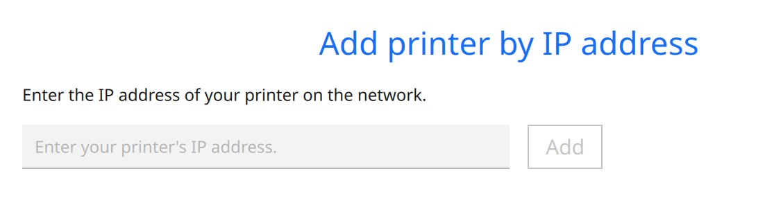

If you do not see your printer in the list, click the Refresh button. Alternatively, you can also add a printer by entering its IP address.

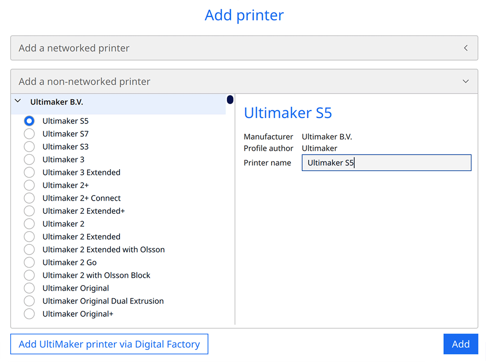

In the printer brand selection panel, select Ultimaker printer. In the next screen, select Add local printer. Under the header Add a non-networked printer, you will see a list of all UltiMaker 3D printer models. Choose which printer you want to add. You can also give your printer a unique name, which can be useful if you have multiple printers of the same type.

To add a different printer brand, select Non UltiMaker printer in the printer brand selection panel. In the next screen, scroll down under the header Add a non-networked printer to find your printer brand and model. When selecting a printer, you can also give your printer a unique name, which can be useful if you have multiple printers of the same type.
