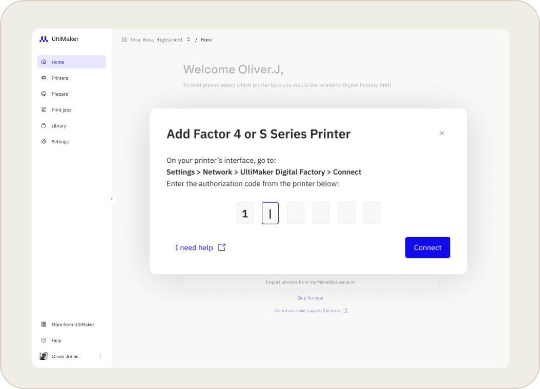

Use this method for UltiMaker S-series, Factor 4, and Method printers that have a Digital Factory menu on the device.

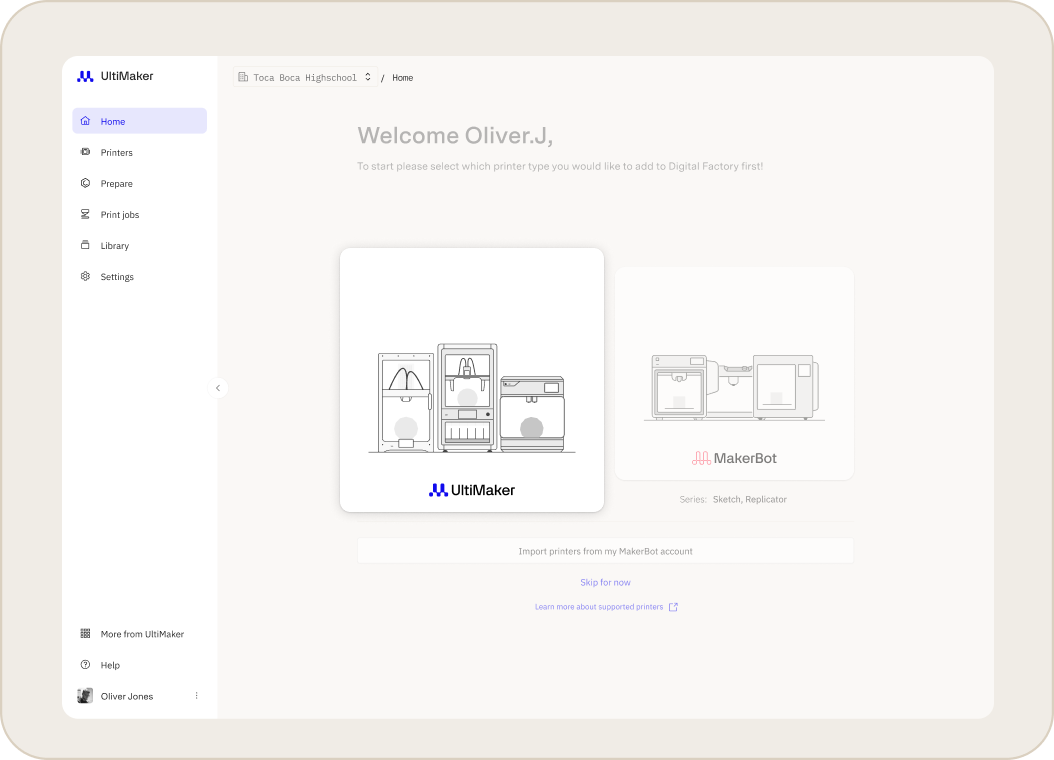

  1. In Digital Factory:
    - For new workspaces, select printer brand + type on the home screen and follow the directions to find your authorization code on you printer.
    - For existing workspaces, navigate to the Printers page, click the Add printer button, select Printer Brand + Type, and follow the directions to find your authorization code on you printer.
  2. On the printer:
    - Navigate to setting (listed below) generate a 6-digit claim code.
  3. Enter the code in Digital Factory and press Connect. Wait for approximately 30 seconds for the printer to connect
S series and Factor series notes
  • S series and Factor series printers support direct pairing with an authorization code, located under Settings > Network > Digital Factory > Connect.

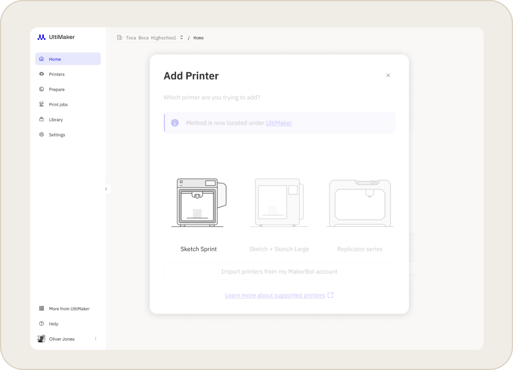

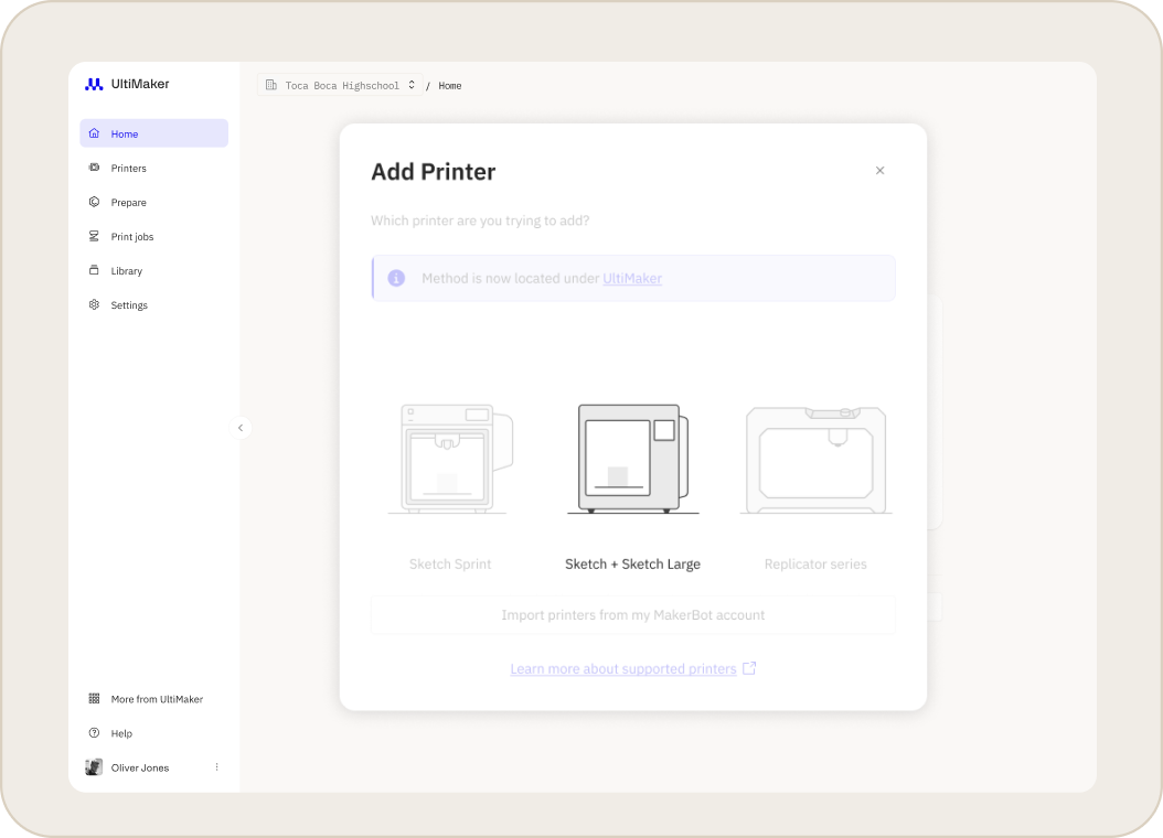

Sketch series notes
Note: Ensure you have selected the correct printer type in the Sketch series. Instructions vary per printer.
  • Sketch / Sketch Large supports direct pairing with an authorization code, located under Settings > Network > Authorize User > Authorize with Code
